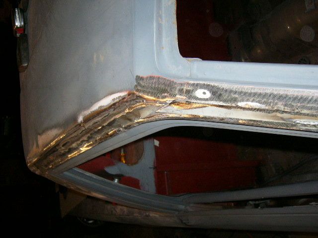

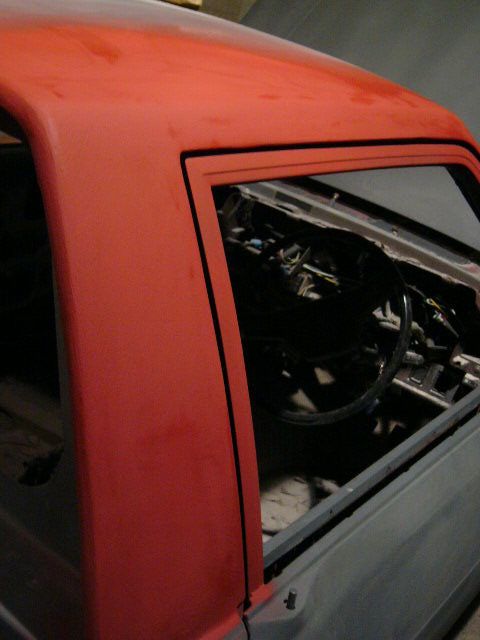

On my Corolla ute we bent the drip rail over and plated it, otherwise the door rubbers have trouble sealing if you just cut it off. We also put a cap over the rear pillar.

^^^ that looks pretty smooth, i like that.

How did you do it, yo bent the lip that sticks up in towards the body qnd then welded in filler plates to smooth it out?

Yep, in that first pic you can see the plate that was welded up the A pillar.
