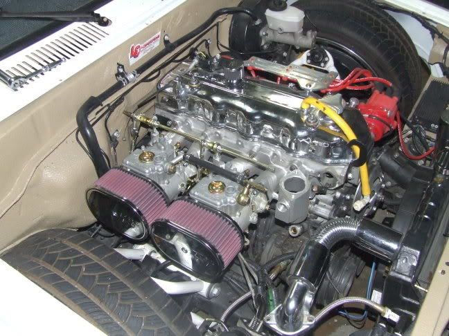

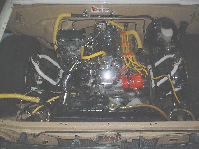

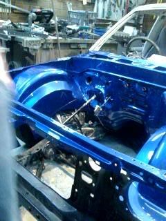

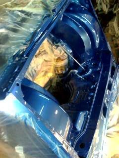

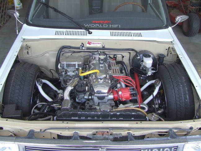

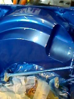

Here's what I did,this is with the front sitting on the cross brace,torssions pulled out. Did'nt tub the fire wall, think I should have ,just so no problems !
toyrota
i reckon this would look weird to you guys .. so oppisite over there
there all the pics i have of mine hope it helps
