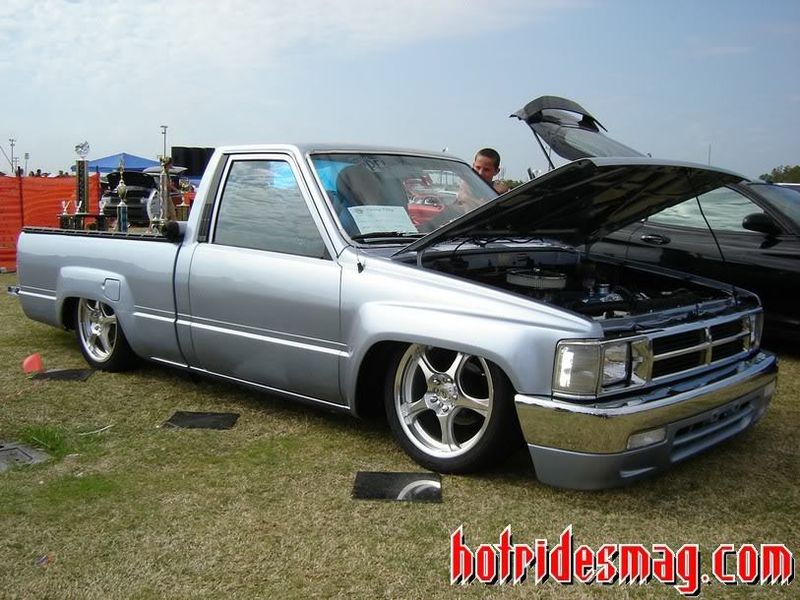

I should be getting an 84 soon, but it has the door windows with vents and the towing style mirrors. What's the best way to get the 1 piece glass and the smaller mirrors? Should I find some donor doors with 1 piece glass and regular mirrors and swap doors or should I swap out the glass and figure out how to gt the smaller mirrors mounted?
here's what I'll be getting...
and here's what I want
Thanks

your best bet would be to get the whole door with the solid piece window. one because it will have the glass and regulator like your looking for. also another reason to get the whole door is because on the doors with solid piece windows, the mirrors mount further forward on the door than the mirrors do on the door with wing windows. if you used your door it would be more work than its worth. you can find the stock mirrors off ebay for around 20 bucks or so, maybe a little more. you could even get the chrome ones off ebay as well if you want those. in short, just get new doors with the solid window and snag some mirrors off ebay.

Get the entire door. I did on my truck, the tracks are totally different. Just look hard for some nice doors. I found a set for $50 that was missing a regulator and one window.

I got doors from same year 4-Runner, (84-88)one pice glass,better looking mirrors, power windows & mirrors& locks( removed). If you do this get all the relays at the same time!
