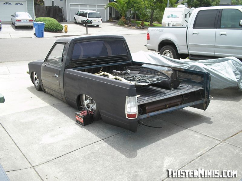

I bodydropped a bed for a guy in my club. Actually, I marked it out, he cut it, and I welded it up and laid down some seam sealer. These are the only two pics I've got of it before it left.
Thats before any welding, it was just tacked, but you get the idea. Raised the bed floor up, and body dropped it 6 inches. I like the way it looks.
m_i_zombie
yeah, thats what I'm looking for. Thanks Seth
