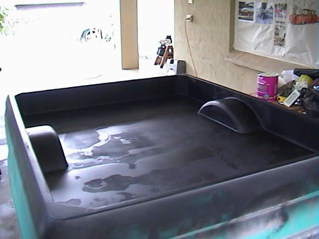

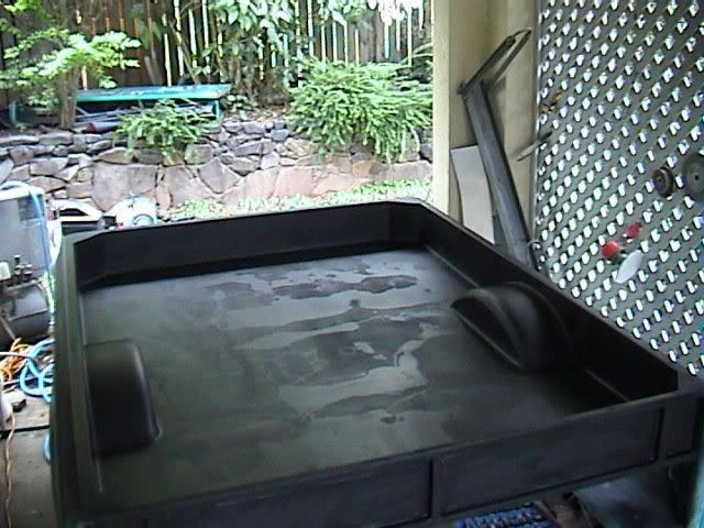

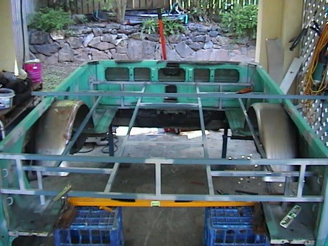

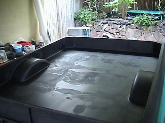

superstylin
etch primed awaiting rhino lining
before sheeting
whynotfab's avatar
whynotfab
damn that is NICE!
d_man
The raised bed floor looks super clean man! Much better then a big hole in the floor. That's what I plan on doing when my ass end finally gets bagged.
that looks great man nice work!!!
superstylin
i welded the sheet onto the frame and it caused some warpage/ shrinkage so i had to weld in some additional framework.
i then welded all the highs and lows in the sheet onto to the frame and finshed all my welds in bog for a smooth finish.
too much sanding- never again.
not bad for my first sheet metal bed though.
thanks for the props.
