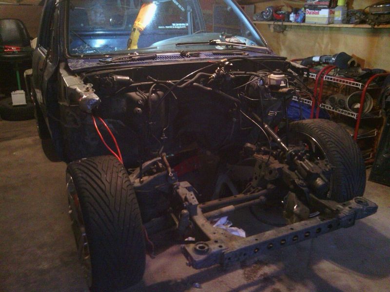

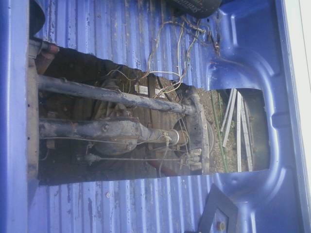

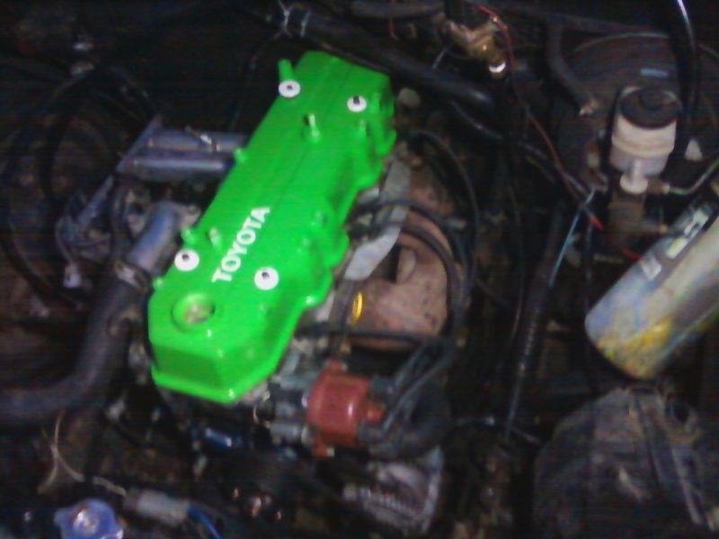

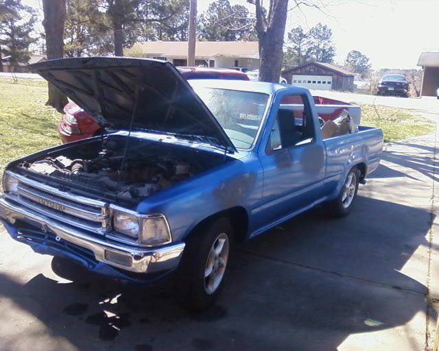

Picked this 90' toyota up for $200,didn't run or shift,no compressors for the airride.truck sat for about 5-6years.hauled it to my buddies house and we started eliminating causes of why it didn't run.clean the injectors,put a clean fuel cell in,bleed slave cylinder and a tune up. and we was on the road.truck was "bagged" up front only with no compressor's but luckly the tank had a schrader valve so i could air up with my air compressor at home.ordered 2 viair 444's and started buying parts for the rear of the truck,its still a big project truck but i still drive it daily till i fix my other vehicle.

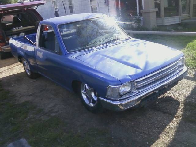

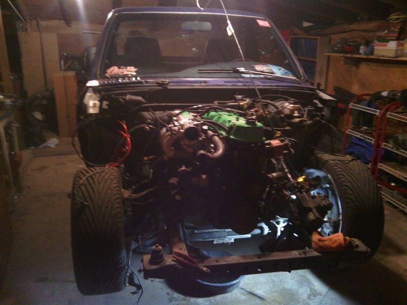

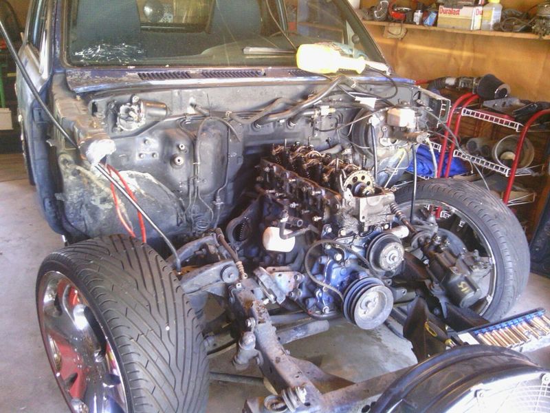

now heres the most recent photos of the build

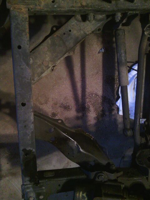

bottom(right side) is bent plan on building adjustable tubular's for it

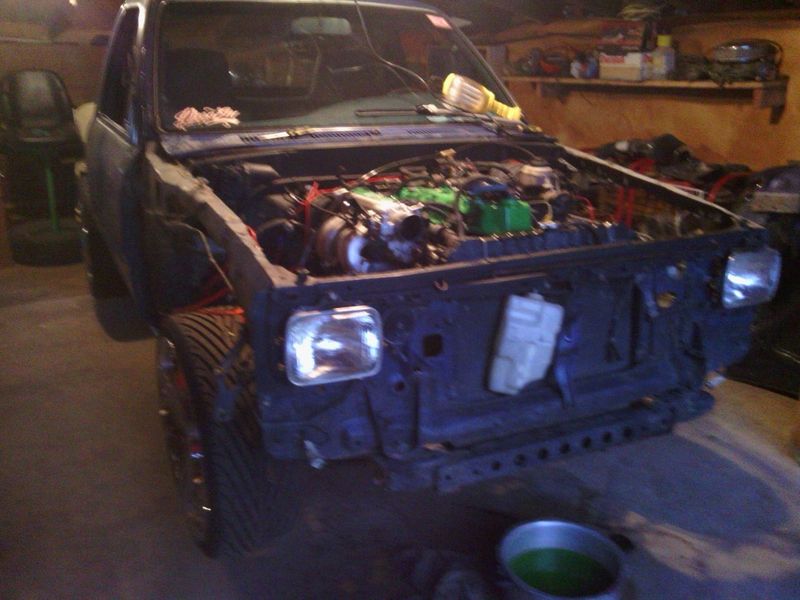

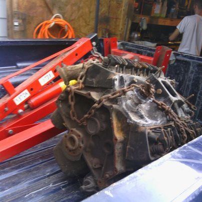

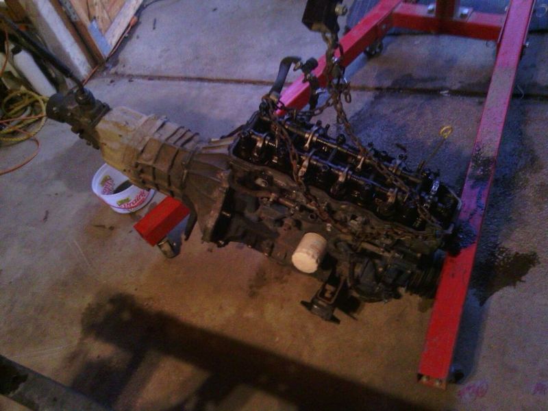

got the motor apart with the help of a friend found out its a 355 4 bolt main with TRW chromoly hardend push rods TRW forged pistons with a 280 cam. gonna port the heads and hone it.going to have dual 3in exhaust. not sure what mufflers im going with yet but its gonna be pretty fun when its done
