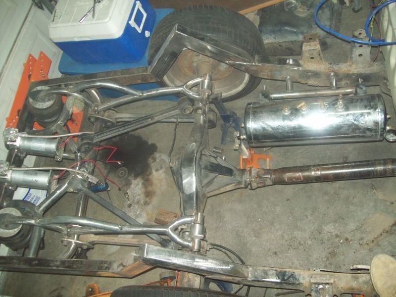

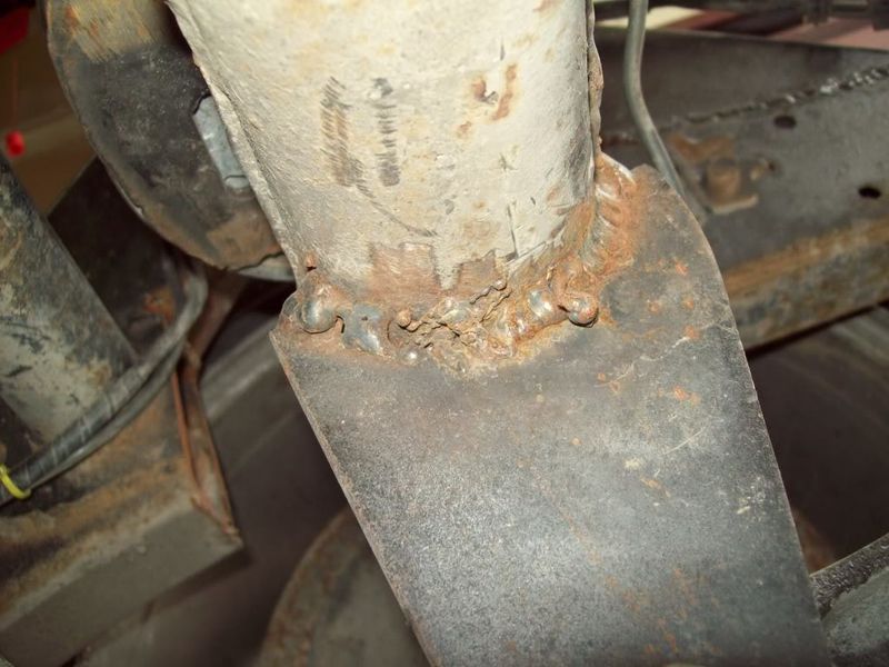

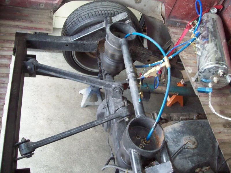

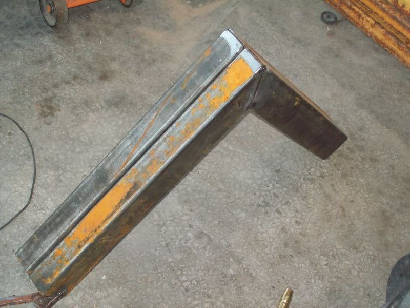

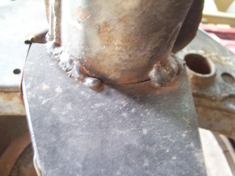

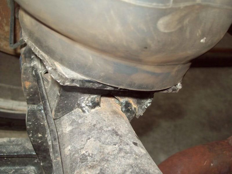

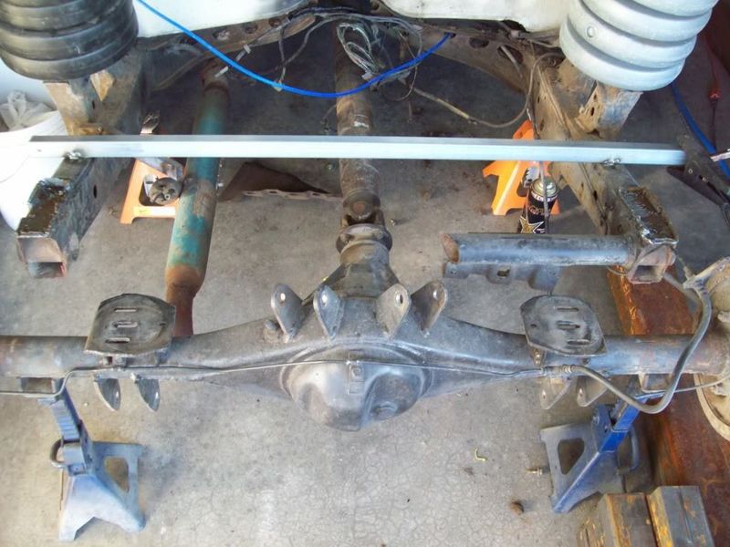

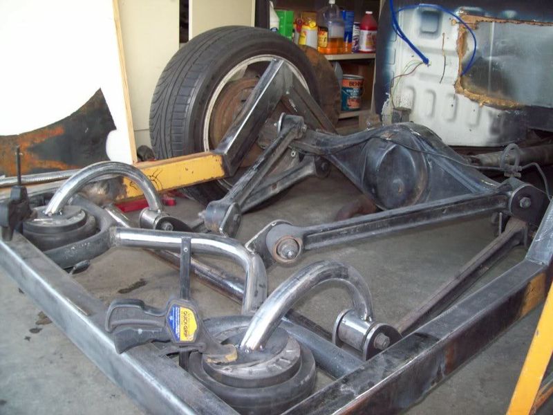

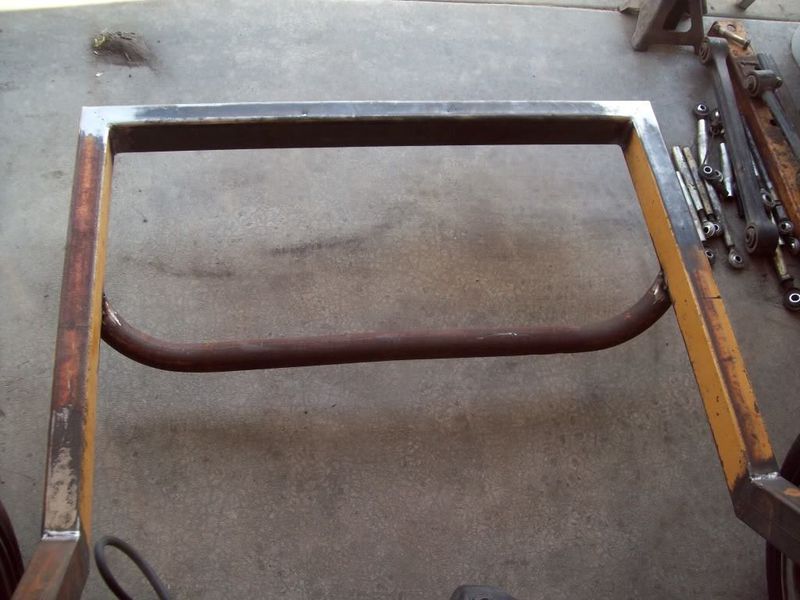

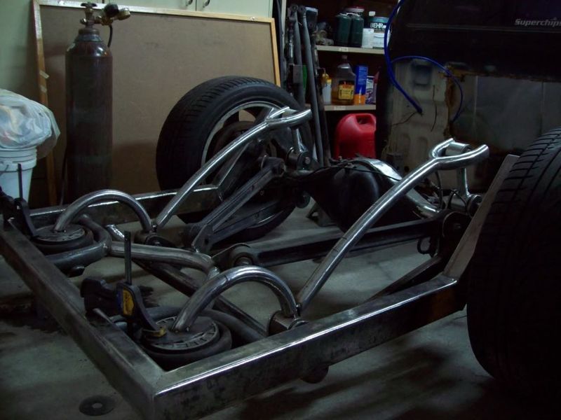

Here is a truck that got bagged by a shop that I'm redoing. These pictures are of it before.
The lower bag mounts
Lower link tabs

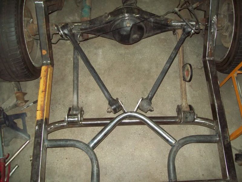

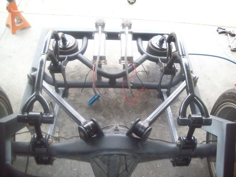

After I cut the rear frame off
Notches I made

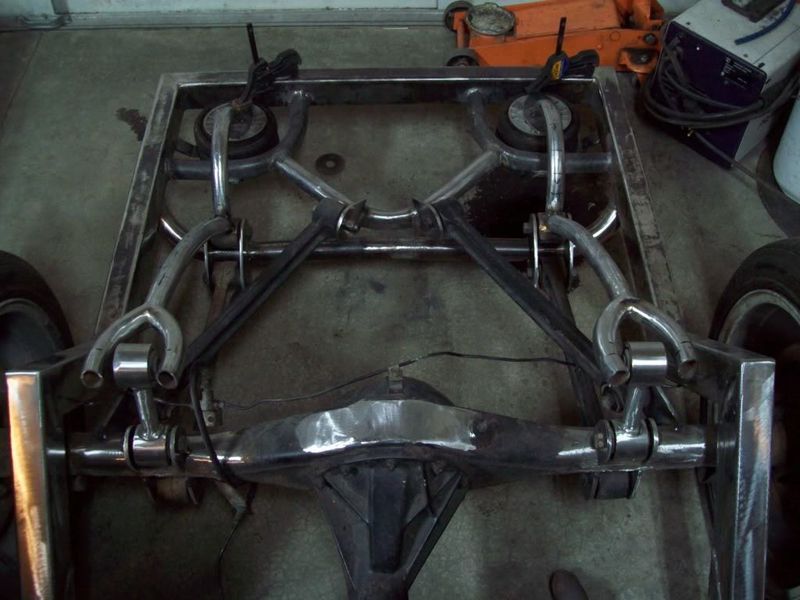

New frame

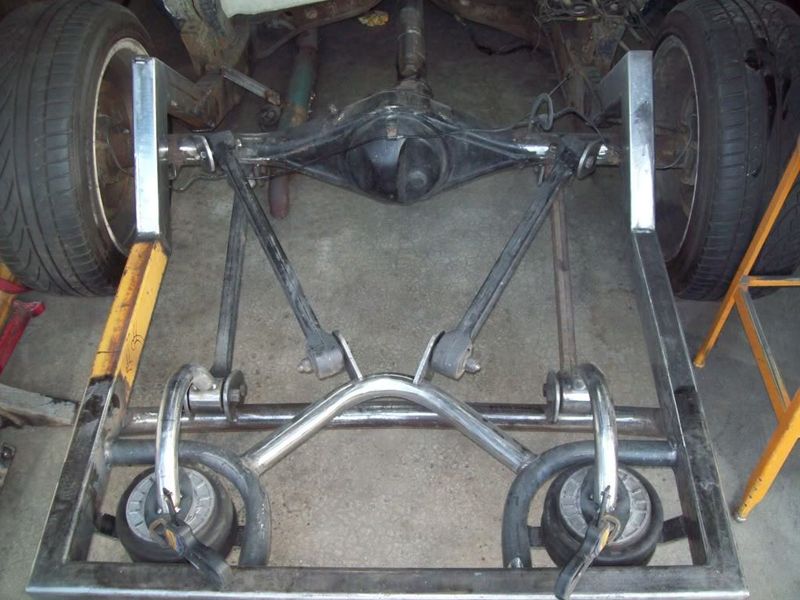

Lower link tacked in with the Catilever center pivot.

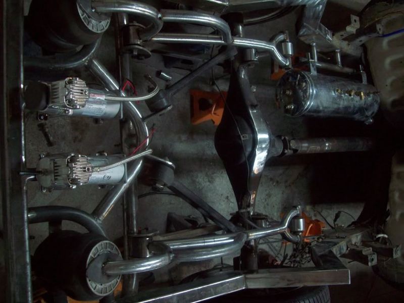

I'll have more updates here shortly

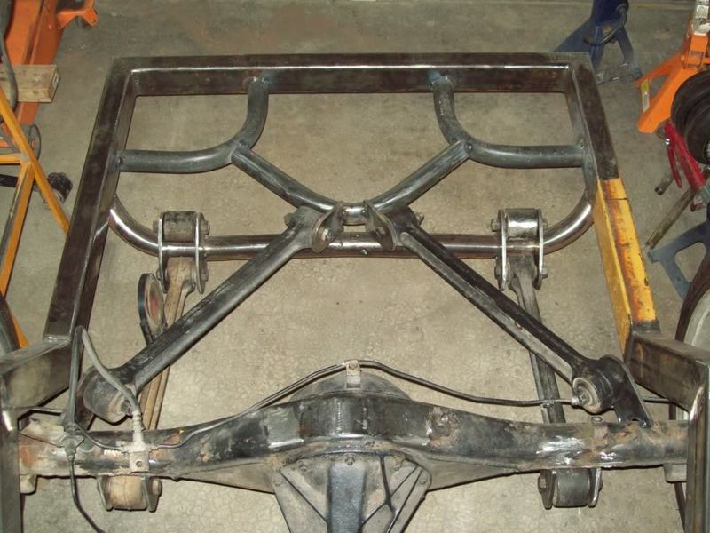

macdave06

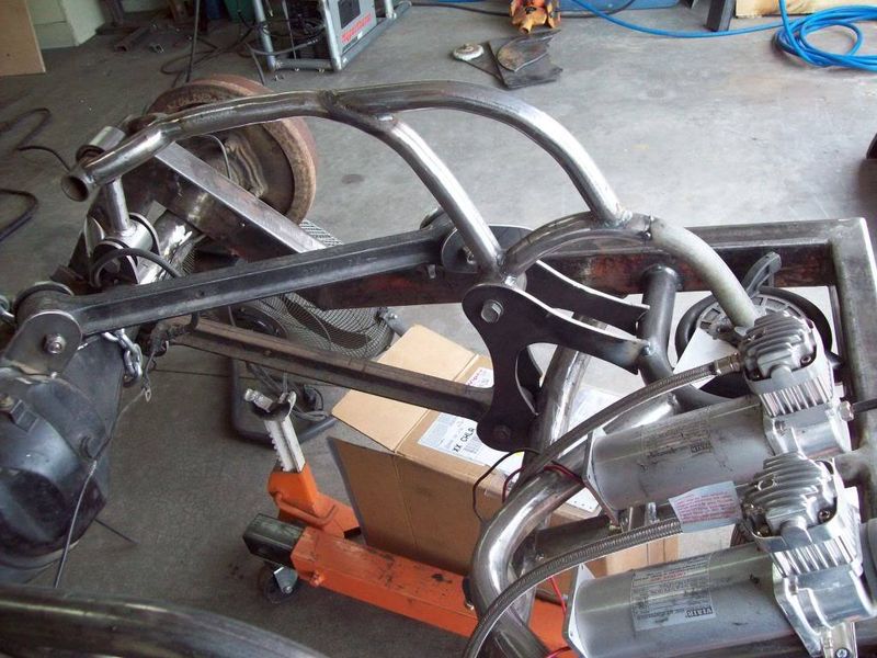

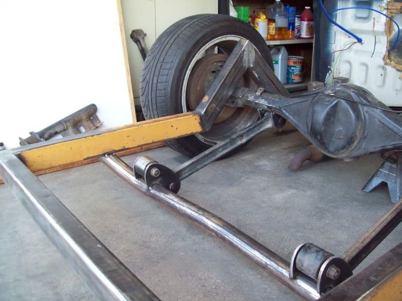

factory trailing arms for link bars? First time I've seen anyone do that, but I guess it'd work
draginrunner's avatar
draginrunner
Thats what he wanted. They are off a Nissan pathfinder. As long as it cycles properly. He wanted me to run them reversed so that he can keep his gas tank in the stock location.
macdave06
yeah obviously theyre strong enough if theyre used in the same fashion on an OEM setup. Kind of a neat idea.
draginrunner
Yeah it is. Plus it saves him money not having to buy or me build the links. This is definitly a new one for me.

Doesn't look like a "shops" work, more like a hillbilly with a stick welder. How could an owner pick up their ride with a job like that? I would've knocked out some teeth and left with my money.
draginrunner
He trusted this guy. When he showed me the truck I was shocked that he had been driving it for a few months like that.

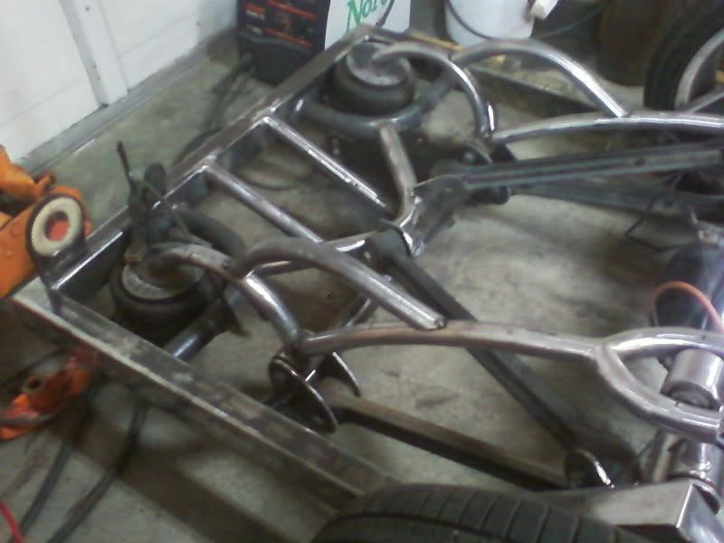

draginrunner

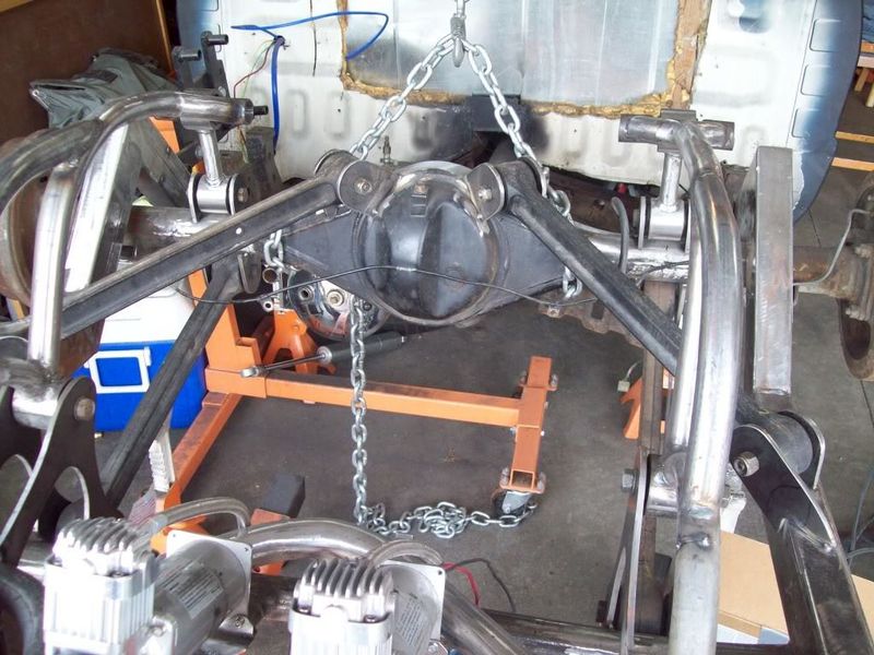

I got his bag mounts and upper bars tacked in place, and just one link tab on each side tacked, that way I can make the other side of the link tab fit perfectly.
