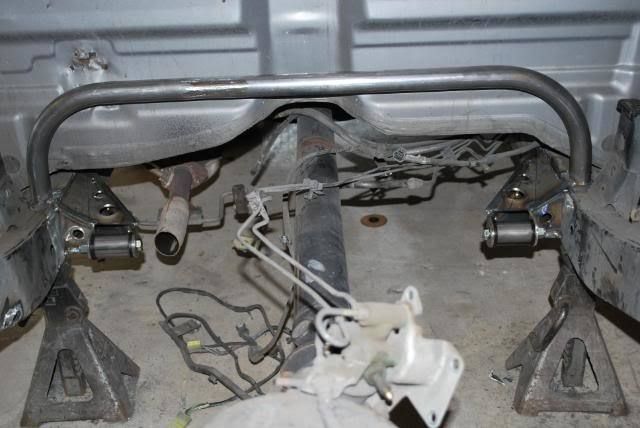

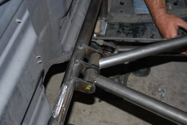

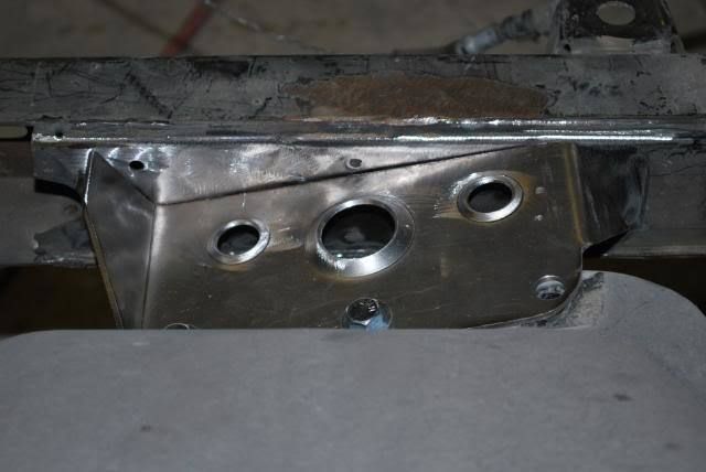

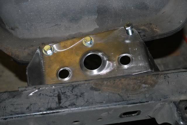

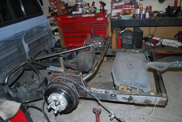

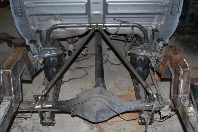

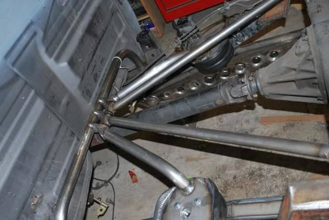

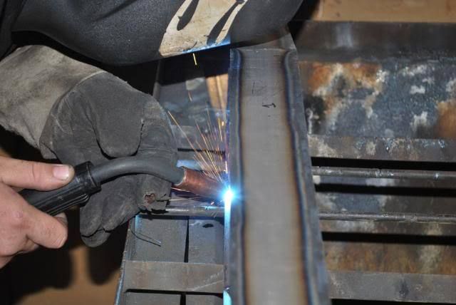

Here's a big one for the pic whores
Post was last edited on Jun 24, 2009 05:17. Edited 1 time.
smctoy's avatar
smctoy
very nice!!

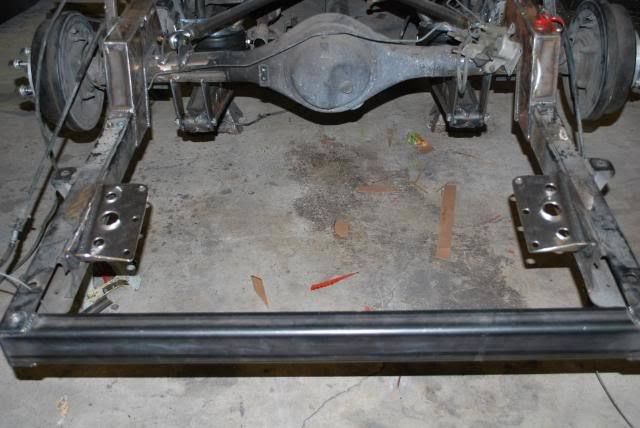

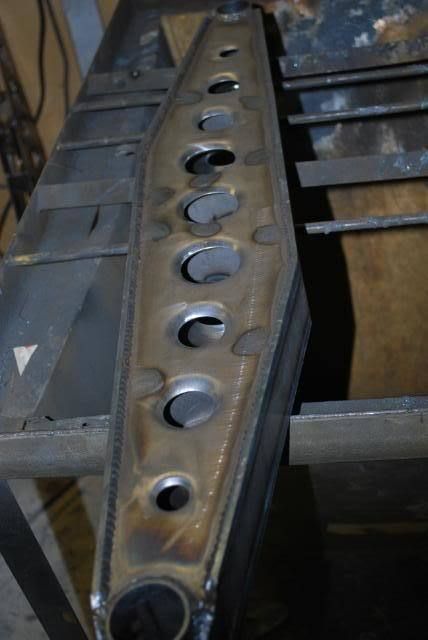

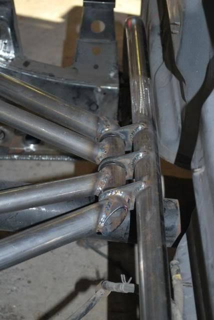

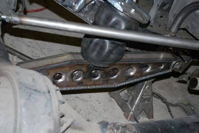

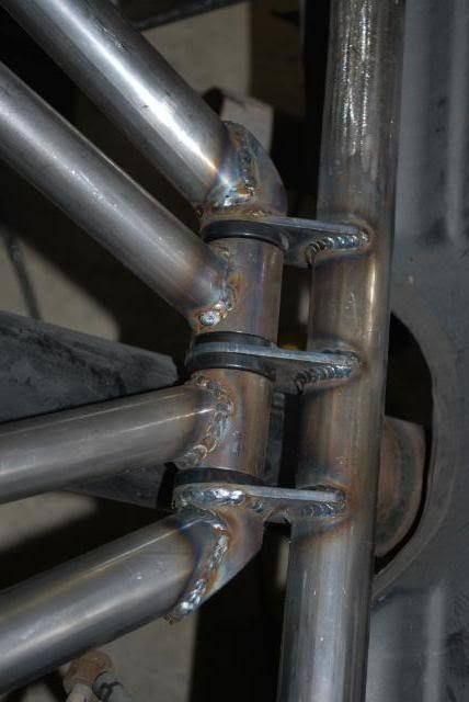

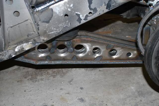

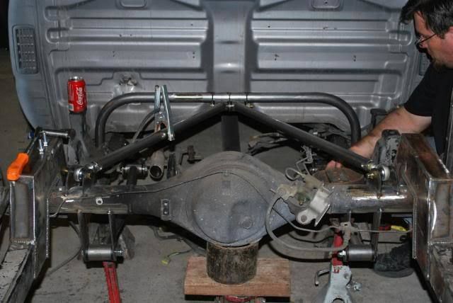

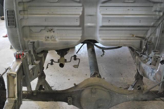

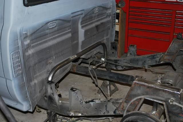

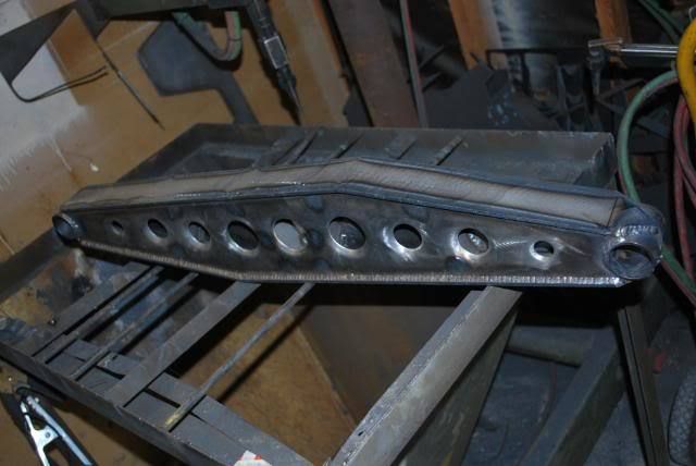

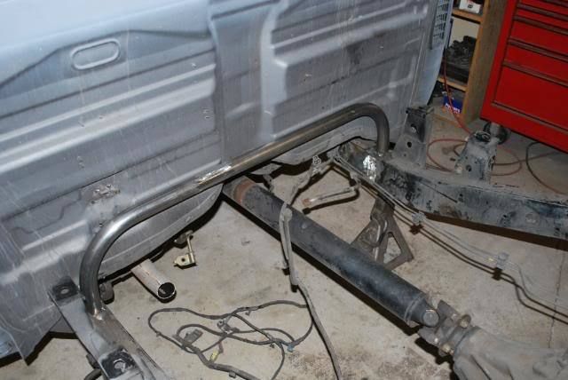

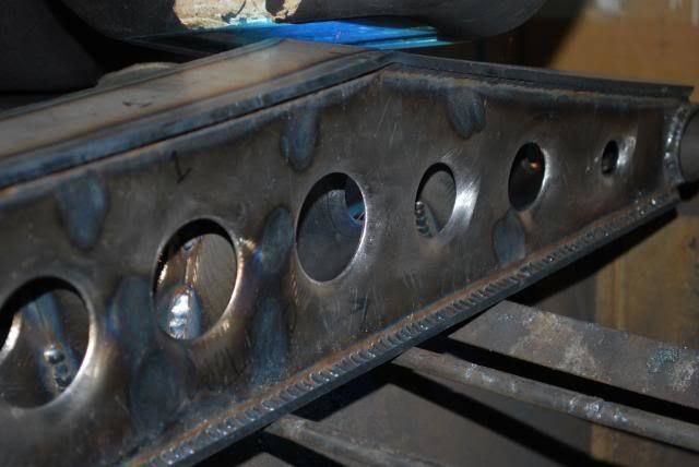

....and more
sunsetjoe
WTF TAYLOR? I'm serioulsy jealous now. That looks frickin' sick. RC's gonna be talkin' smack, LOL!!!

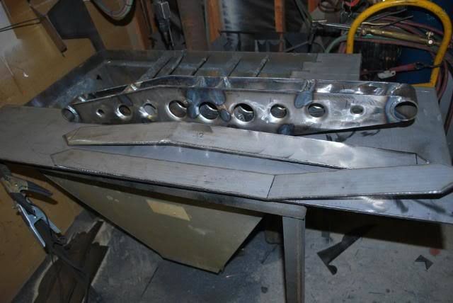

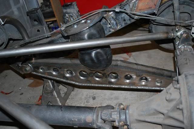

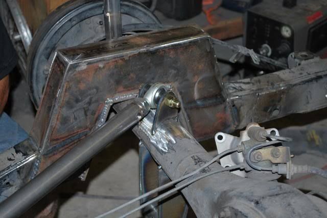

HEY, ALOT OF THOESE PICS LOOK FAMLIAR, OH YEA THATS CUZ I TOOK EM!!! ROR! ANYWAYS... I LIKE THE BAG MOUNTS, LOOKS GOOD! HAS RC SEEN IT YET?

macdave06
sick. i want a laser.
lowyota95's avatar
lowyota95

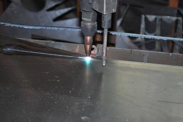

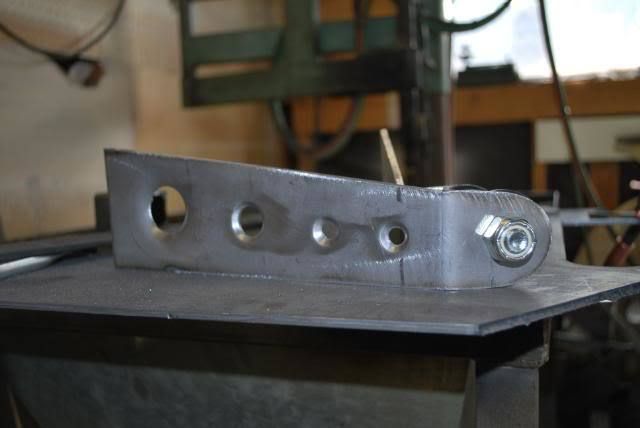

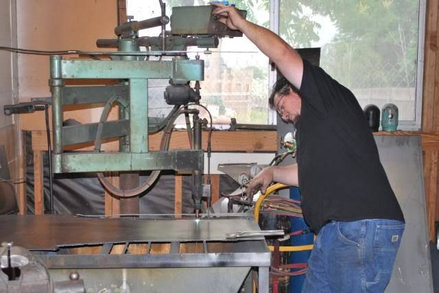

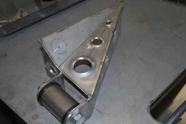

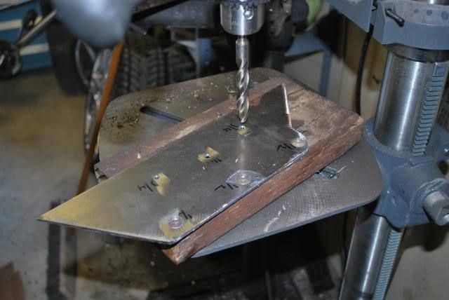

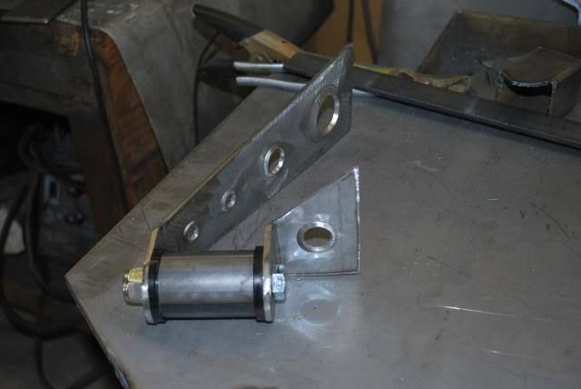

Thats not a laser, its a patteren cutter, works with a oxy/act torch and a metal pattern, alot of the time they get better cuts than with a laser, as long as you have all your pressures and speeds right. Let me or CIDAWG know if you need any parts cut, even one off's, we have alot of patterns for 4link tabs, shock tabs, bushing mounts, compressor mounts, etc... or we can cut anything you want!
macdave06
Oh duh. now that you say that I've seen one of those before. Well used it actually haha. We had one in my metal shop class in high school. It just follows a template right?
I'm actually thinking about redoing my 4 link on my truck to a parallel(not bagged) so I may need some brackets done.

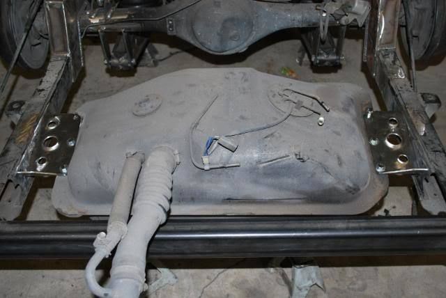

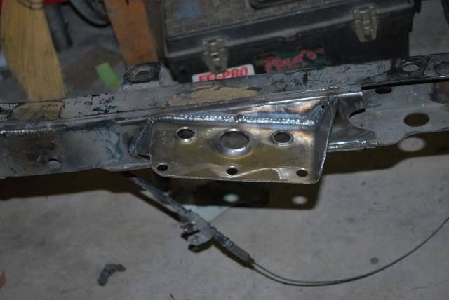

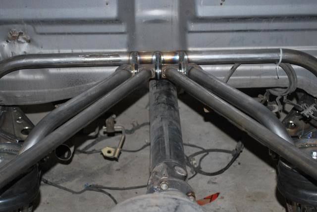

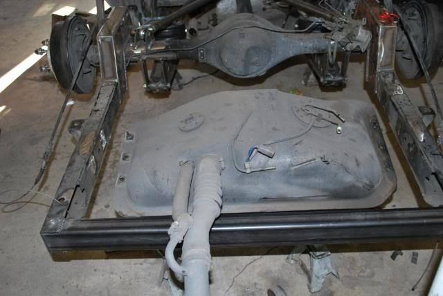

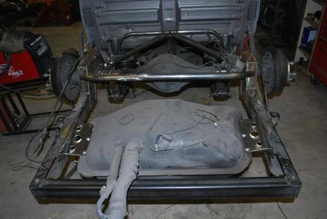

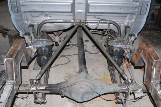

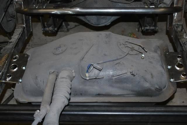

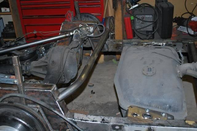

got some more done in the past couple days. Got the front crossmember braced, gas tank mounted and the tube for the airtank mount.....
