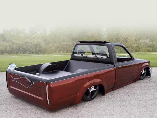

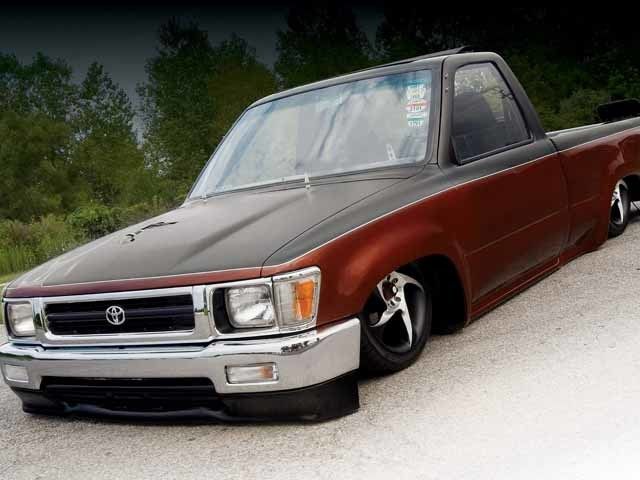

ok so iv been on here for a while i just havnt made a build up thread for my truck just because it wasnt mine if you understand what i mean but now that i have defined this truck from someone elses designs im goin to make a build up thread....,.. ok so here is what i started with the truck was featured in sport truck of 2006 the owner was from indy
Year/make/model:
'94 Toyota Hilux
Engine/drivetrain:
2.4L 22R-E SOHC FI I-4 / manual five-speed transmission / K&N FIPK
BY: Brad Blair
Rims:
Front & Rear: 17x7-inch Enkei Showguns with painted lip
Tires:
Front & Rear: Kumho 205/40R17 ECSTA MX
Suspension:
Front: 2-inch drop spindles / modified A-arms / Firestone 255 air springs
Rear: Pete & Jake's four-link / Firestone 224 air spring
Accessories: 3/8-inch Air Ride Technologies manual air valves / 3/8-inch DOT air line / two 3-gallon air tanks / two Firestone 337 air compressors
Chassis: Z'd frame / step notch / custom transmission crossmember / rear frame modified for the stock gas tank
BY: Gerry Rose in Cincinnati, Ohio
Body Mods:
Shaved door handles, gas door, antenna, air vents and body seams on back of cab, inner door-lock pulls, tailgate, taillights, tailgate handle, wiper cowl / molded roll pan and Cadillac taillights / 3-1/2-inch body drop / 4x4 front fenders, bumper, and valance / custom-made 34x23-inch sliding rag top
BY: Brad Blair / Josh Bryant / Josh Alvey
Custom Paint:
PPG Hot Hues Hot Rod Black / DuPont '07 Ford Merlot Red / House of Kolor Red Metalflake
BY: Josh Bryant
Interior:

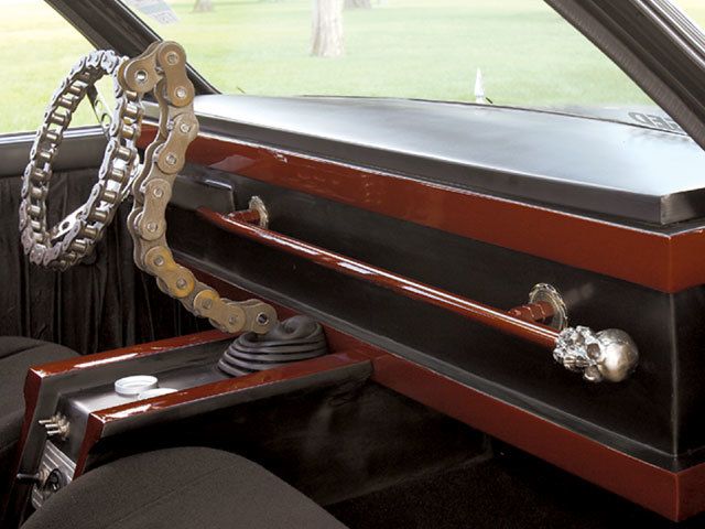

Toyota Paseo bucket seats covered in black tweed / custom-made casket dash and center console, color-matched to exterior / door panels wrapped in black silk / black loop carpet / custom-made chain steering wheel and shifter / Faze temp and fuel gauges
BY: Brad Blair
