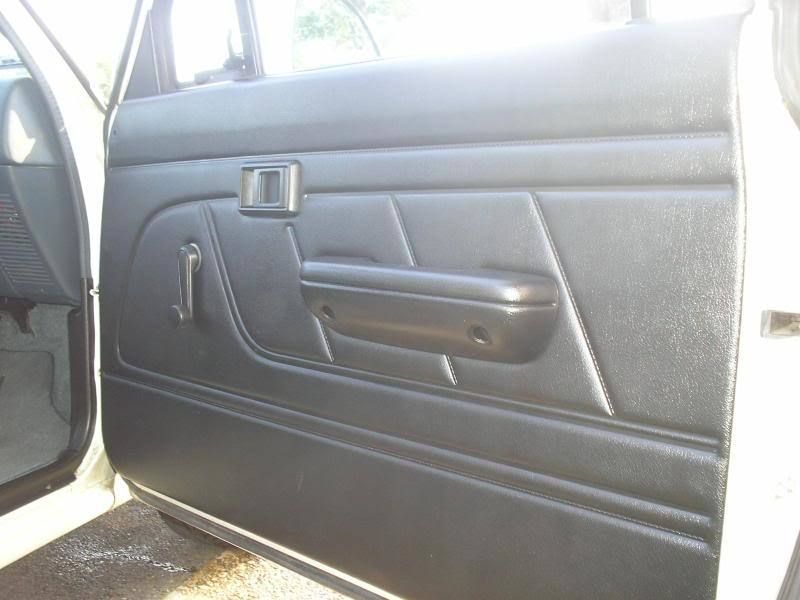

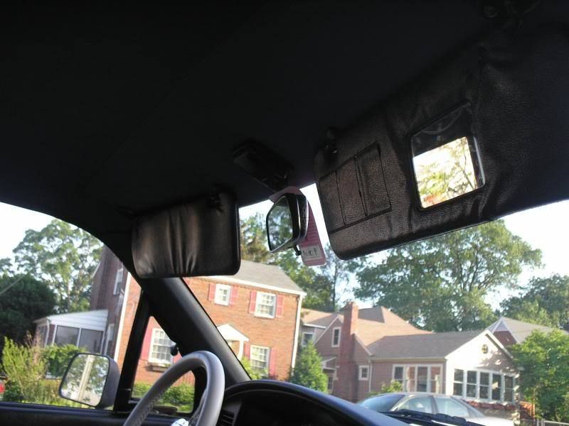

With this long weekend I thought I should do some work on the roach. I needed to clean up the interior some and I had blue panels that the truck came with and I have been adding 4runner parts and tacoma parts so they were gray and all the color was making me sick. So a trip to Auto Zone and some prep time and a few cold ones I got it done in only a few hours. I hope you all enjoy. Not the high tech stuff but it worked real well with the correct prep time. I will let the pics speak.

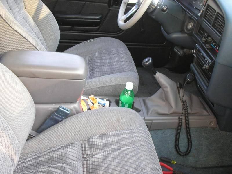

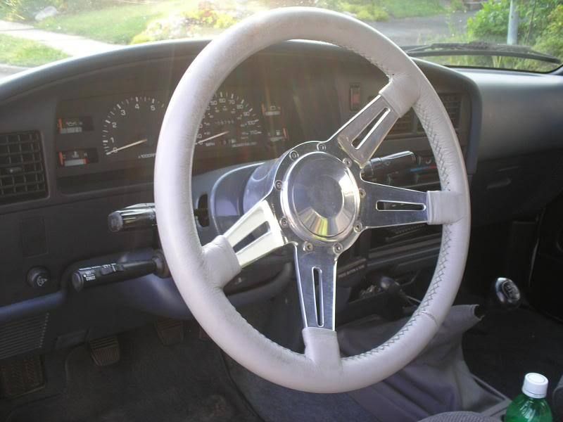

02 Tacoma Full console. Fit like a glove.
Lecarra Wheel and Hub

Looking good...I used that dye to do the visors, dash, part of my door panels & other interior parts as well. I have to say that its some good stuff if you take your time!

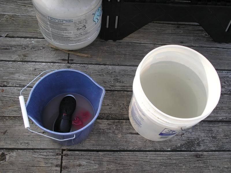

It does not take that long but take your time. I washed the parts with water and ajax then let them sit in clean water. Then used wax and grease remover. Then used the adhesion promoter and started to paint.

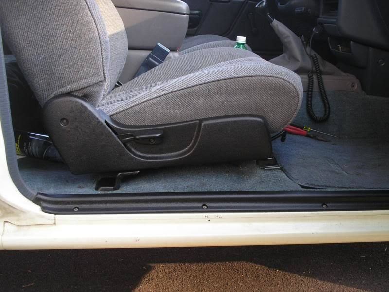

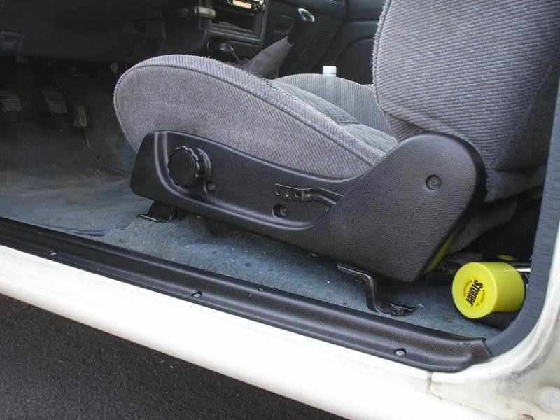

WHAT SEATS ARE THOESE?? AND THE CENTER CONSOLE IS 02 TACO? RIGHT I LIKE THE WAY THAT LOOKS AND IM DYING FOR SOME BETTER CUP HOLDERS THE STOCK ONES DONT EVEN HOLD MY COFFEE CUP!! I I NEED THAT WHEN I LEAVE MY HOUSE A 330 AM FOR WORK YA KNOW....
da_roach
Seats are 92 4runner Sport. They have the adj lumbar support. And yea 02 tacoma console. Owning the tacoma and this i try to "cross bread" the parts that come out of my tacoma that I show.
