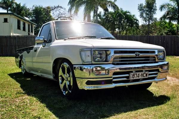

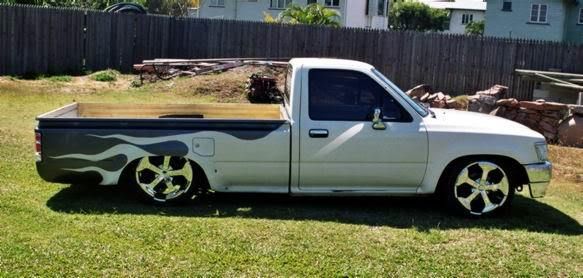

Hey all.. I'm Benny from North Queensland in Australia.. New to this forum.. So this is my 89 single cab long bed hilux.. It was my first ever vehicle I've ever owned!! I still have it after 6 years.. I didnt know a thing about what to do about air suspension of fab work but learnt on every step of the way..
These are the oldest photos I have.. This is what it looked like when it was a "complete" truck.. lol

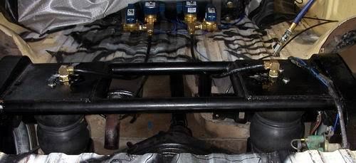

Bagged the front with a modified bolt on kit to lay frame with dreams of trying to get my truck legal in this state and tubbed it.. Converted the engine to EFI from carbie.. WE dont get efi 22r's over here.. Also I've got a T3 ar .42 turbo ready to slap on for a bit more sting..
That went out the window so we decided 4 link it and body drop it...

Got the 4 link in.. Was tricky for our first time.. But when you got beers and a good mate anything is possible... haha

Scolloped the chassis. pushed the bag into it as far as possible.. About 30mm.. All new crossmembers.. A bolt in gear box x member for ease of install- unstall for "when" it goes back from a power increase.. lol
Used a bit of 6mm pipe, belt fark outta it until it match the radius of the bag..
As usual fashion I went crazy industrial with my gussets
Engine x member lifted 25mm and horns trimmed... Lay pretty dam flat with no zee..

Wow, good first post bro. Hello and welcome to Yotascene, glad to have ya! Keep us updated.
btw, the Mercedes was hot.

what year does the aussie yota not have that lip on the beds
TB
tommy b
none.
the 89-96 xcab doesnt have it and the newer than 96 xcabs dont have the bed gutter.
we also really only have standard single cab trucks and xtra cab trucks, no shortbed single cab, although many people "shorty" thier frames and run an xcab bed.
