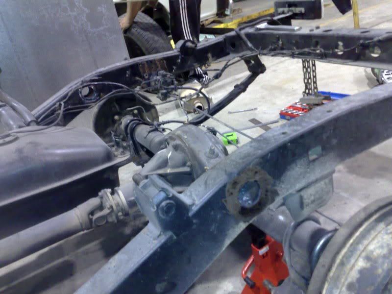

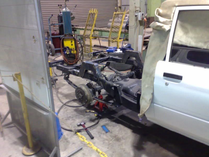

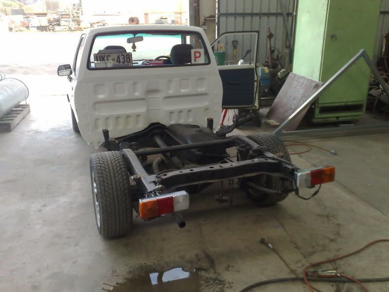

well picked it up today I pulled the tray off it which I will be getting rid of and quickly made some brackets for the tail lights so I can get around for the time being!....just looking at it the brake setup is mounted to the chasis right about where the notch will be does this have to be relocated? mulisharider I am going to use a three link...

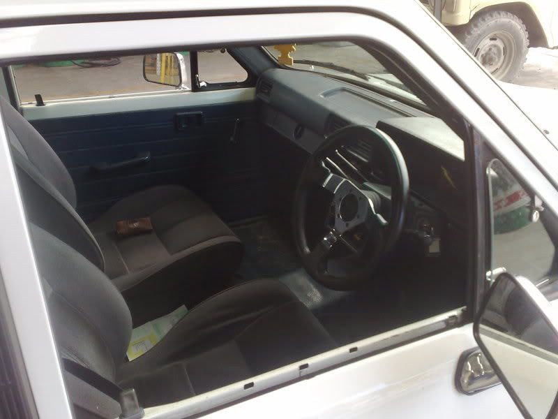

thats a clean lookin runner right there man........ man what i wouldnt give to have right hand drive on mine!!!

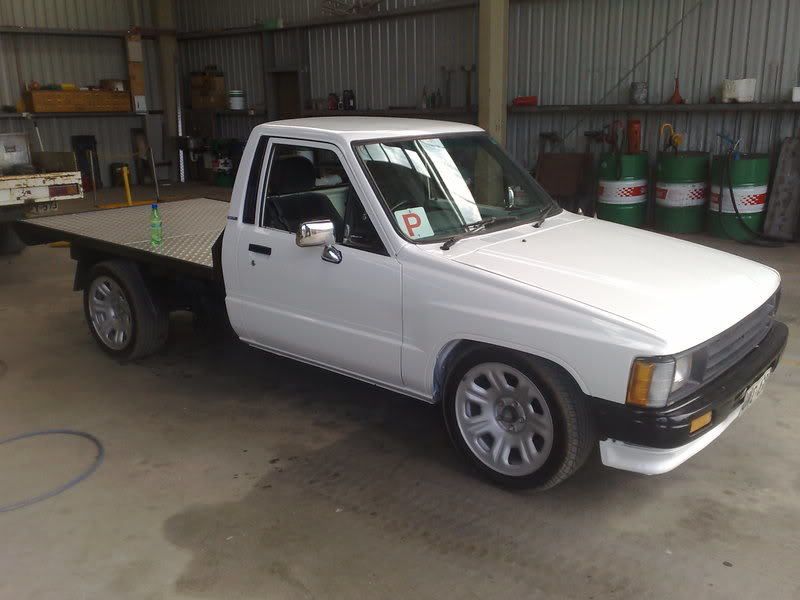

DAMNIT...i love those parklights...i want a set of those so bad and those wheels are bad ass..what truck do those come off of...and size?

they come off a ford territory and they are 17s....they are very common over here on luxes because you can pick them up for next to nothing!...I am getting mine powdercoated black...
