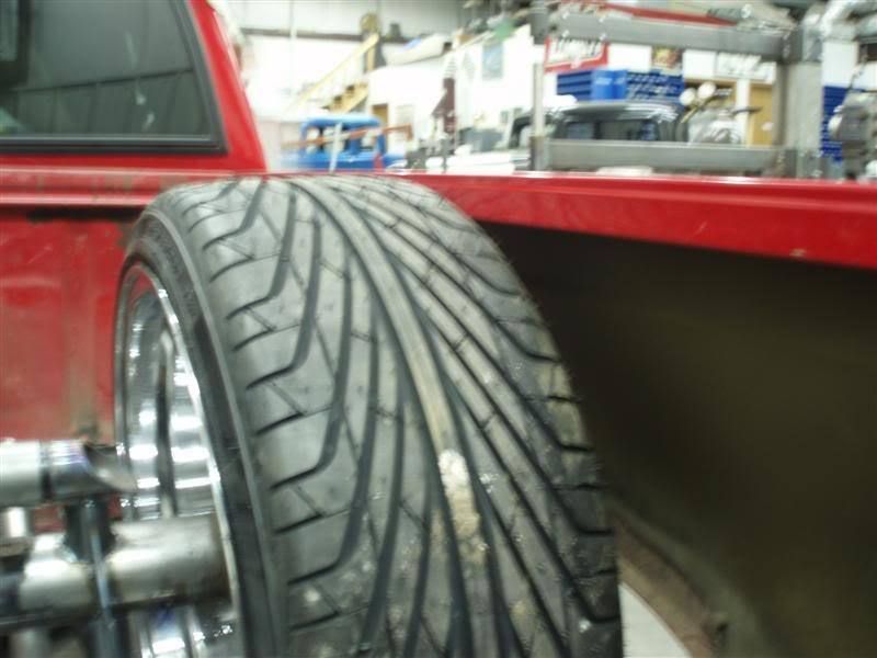

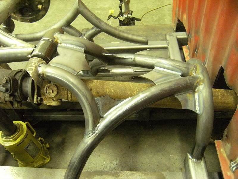

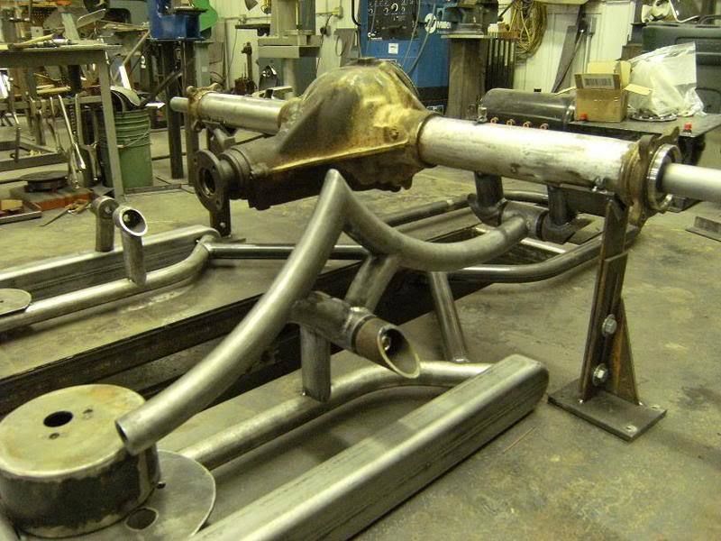

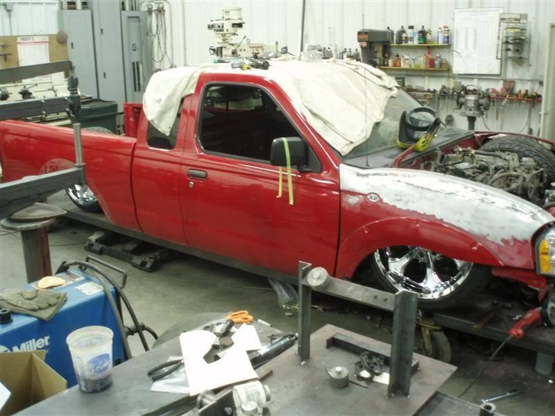

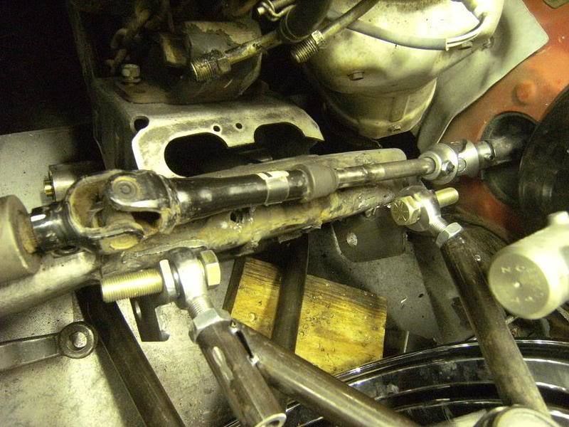

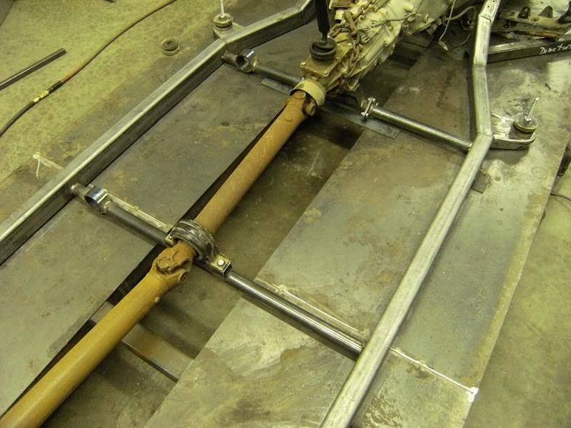

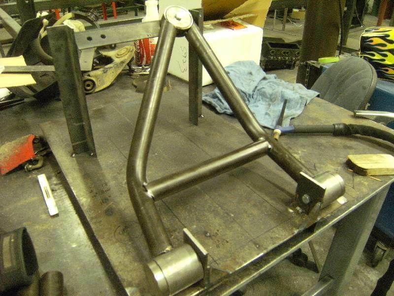

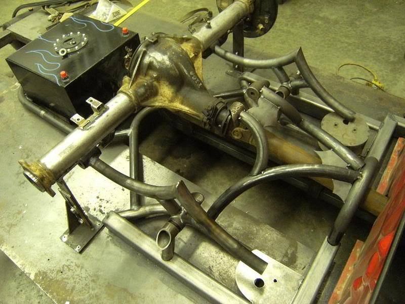

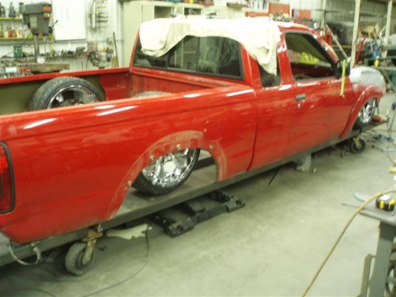

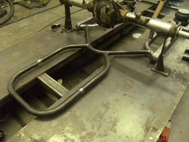

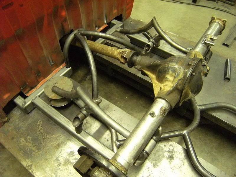

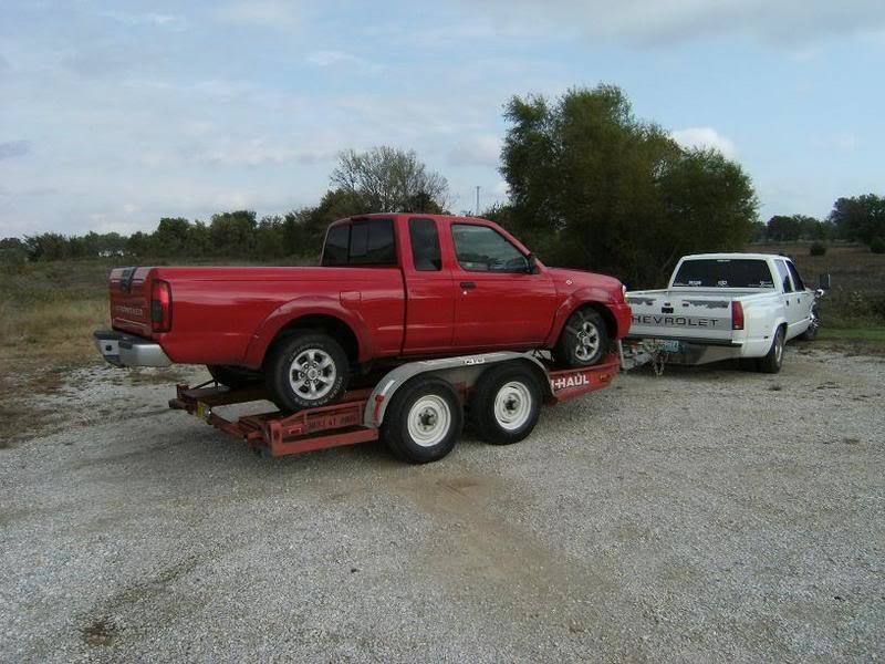

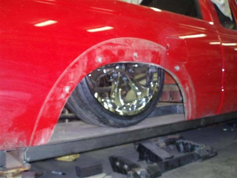

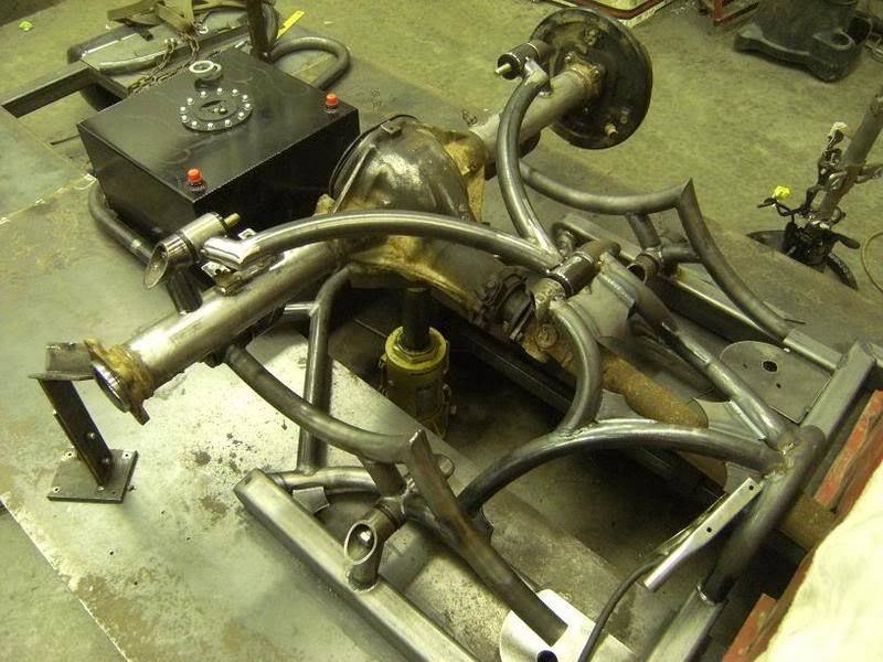

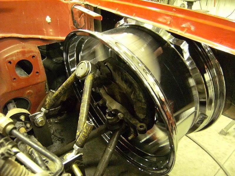

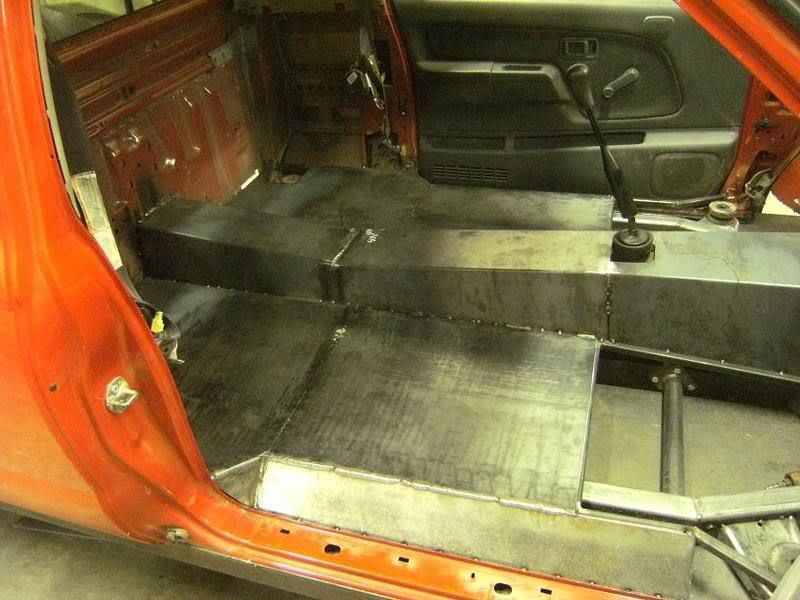

Heres what ive been playing with since my yota is up in KC. Its a 2001 Nissan Frontier that came from a friend in Oklahoma.
Plans are:
cut to the doors (true door)
20''X9.9'' Martin Bros Hammerhead wheels
255/35/20 tires

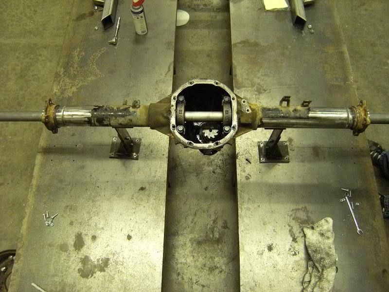

Narrowed rearend 7 3/4''
Custom upper and lower arms
flipped drag linkage (helps with toe in)

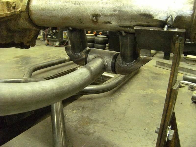

1.25:1 Cantilever link setup
underslung frame

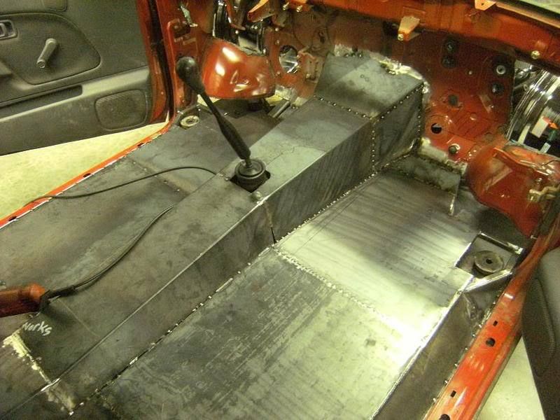

smooth sheetmetal floor
Canti arms
Floor

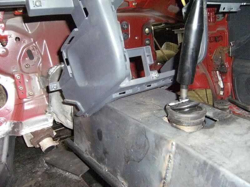

Stock dash fits back in

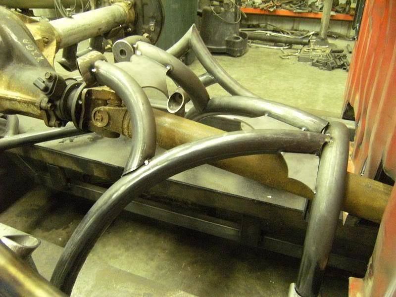

LCA
Most recent work with my new 180* die

I gotta get a bender that does more than a 35o ,that 180 stuff is dope .
Looks killer man ,words cant say how !!
