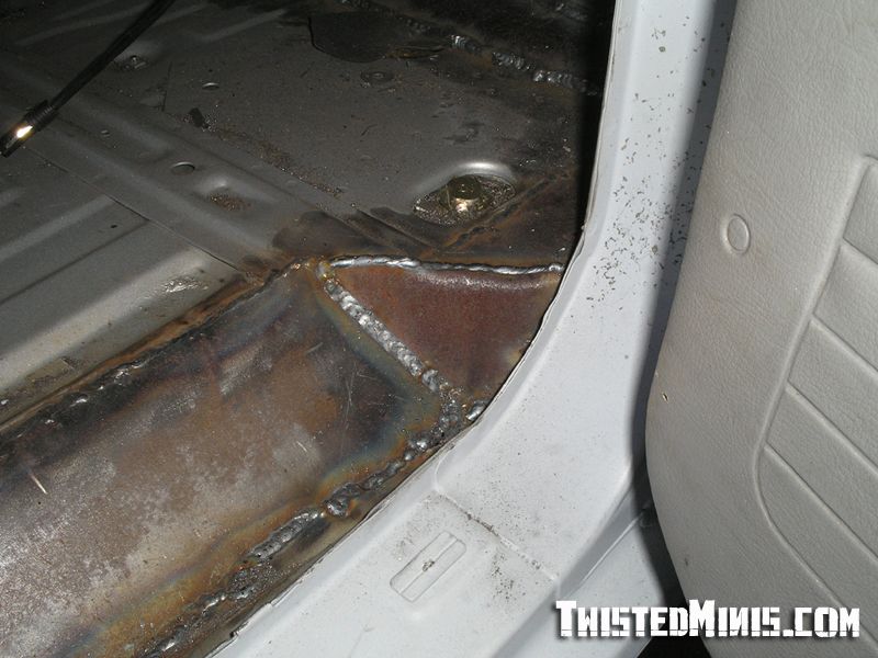

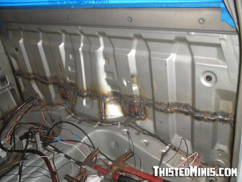

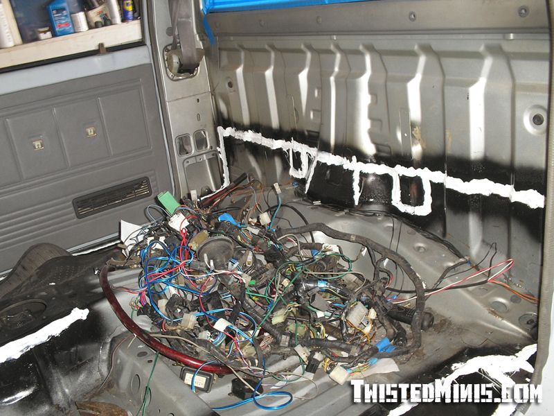

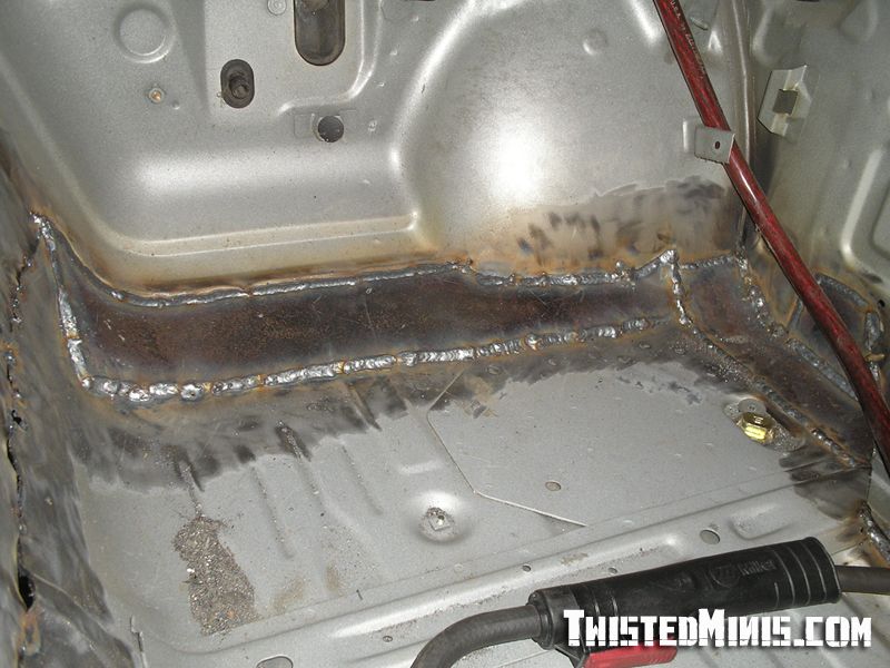

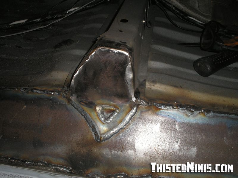

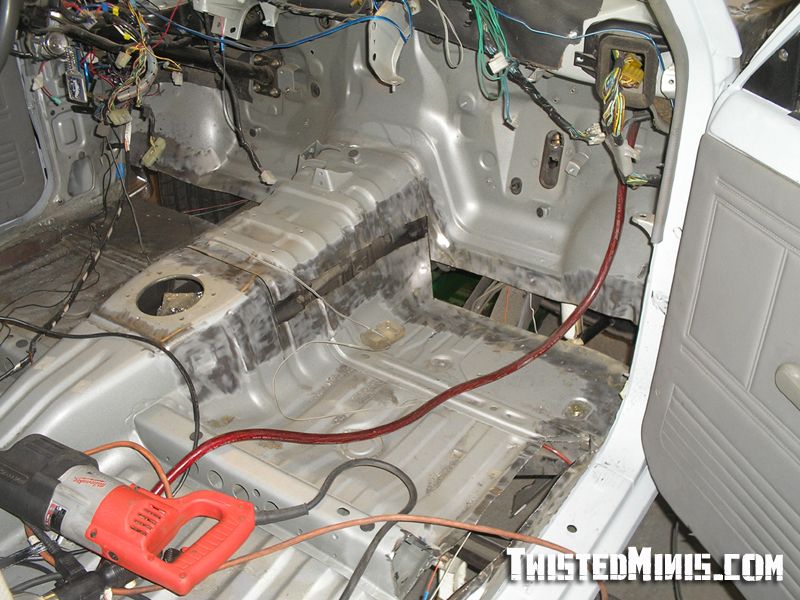

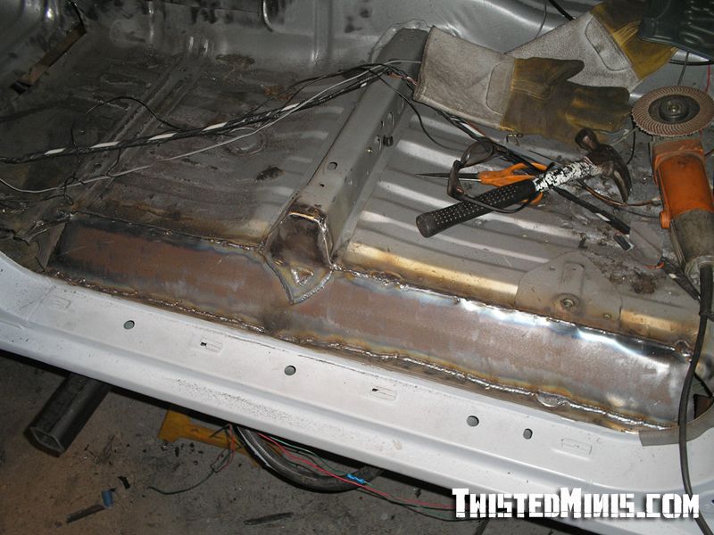

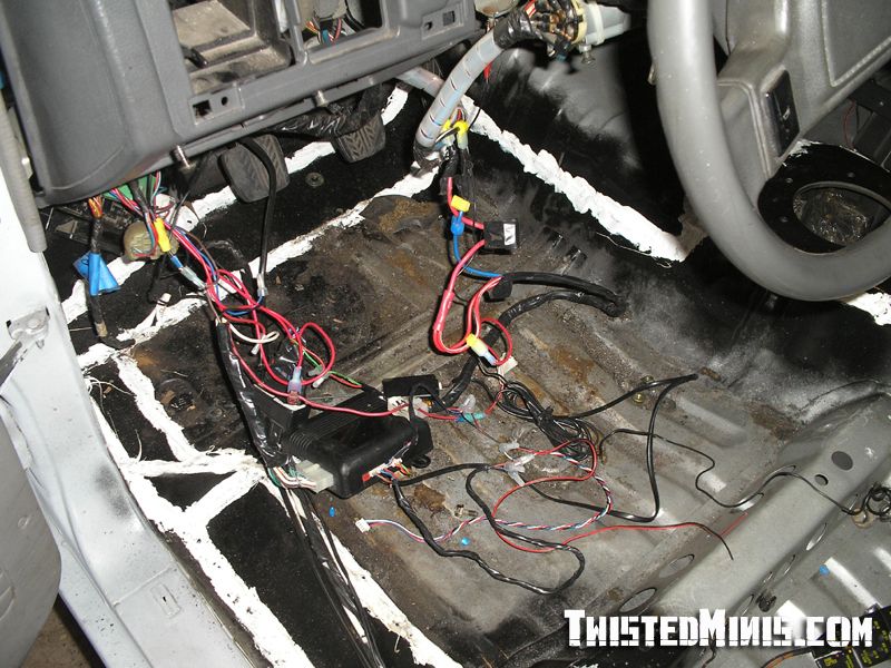

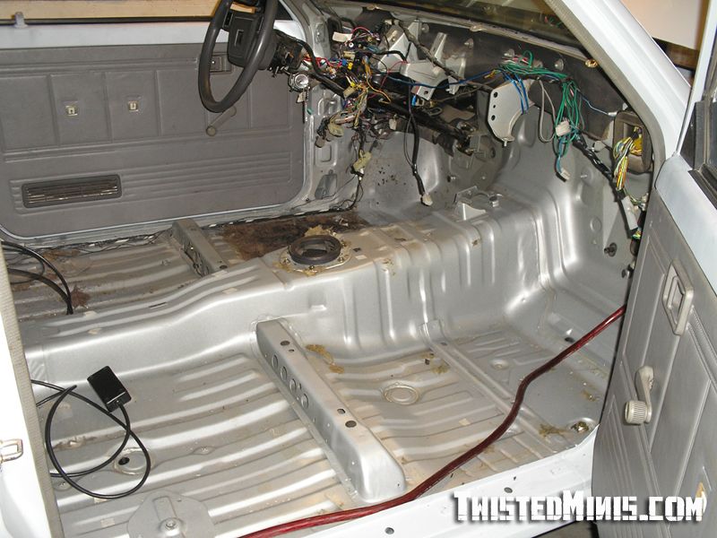

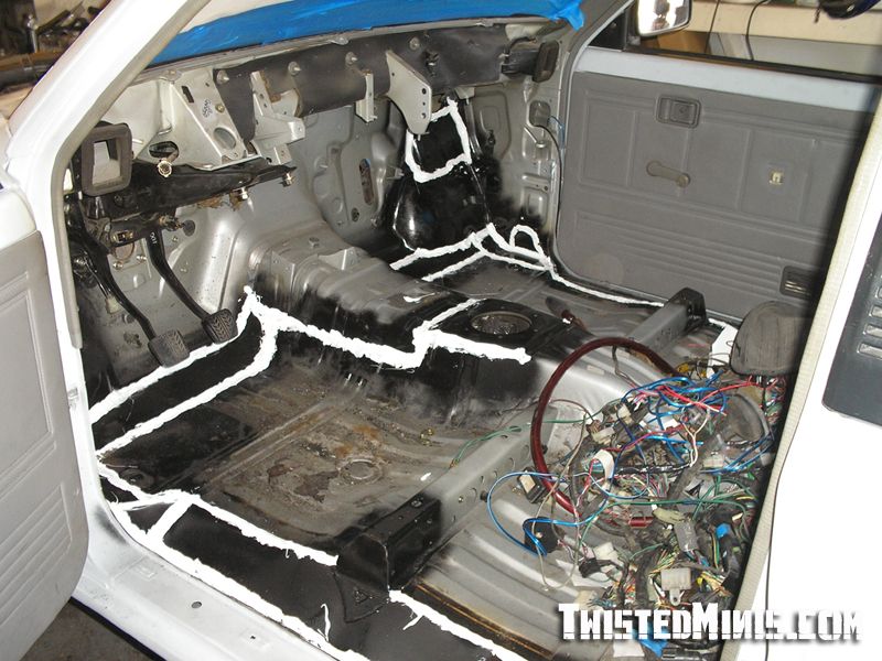

that shit at an angle... like / not | ?? just asking, cuz im close to doing mine truck
and, how did u know where to cut at in the front, under the dash?
no1lowr's avatar
no1lowr
yea its angled, better for carpet, door panels, door seals fitting back into it correctly. also doesnt look as nasty as a giant curb in there.
twisted minis's avatar
twisted minis
What he said. ^
As far as cutting the front, its a little different on a Toyota. You cut above the transmission tunnel. Mazdas have freakishly large tunnels with excessive clearance.
vegasyota94's avatar
vegasyota94

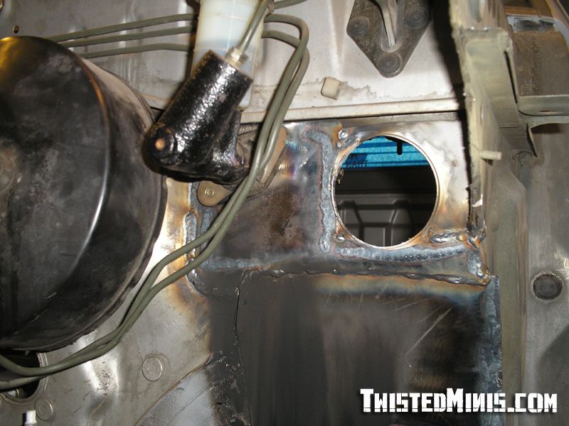

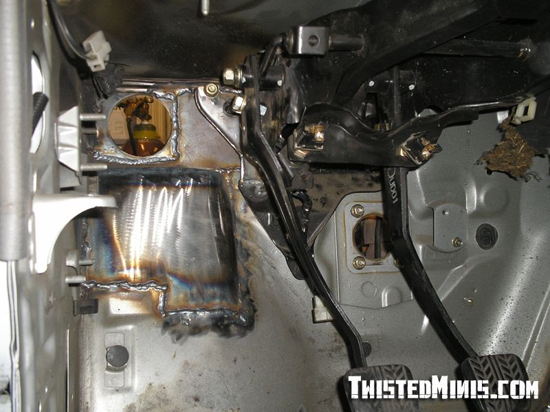

ok thanks.. i will have to take a look at mine.. the firewall is the part im stuck at.. i understand the sides, and the back...
then when i get that done ill need some help with the frame horns...
b4 i cut the cab, does the fenders, and grille need to be taken off?

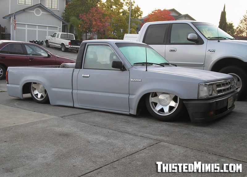

haha seth you make it look like it all happened in a day posting all the pics at once haha, shits tight though man i dig
smctoy's avatar
smctoy
Looking damn good Seth...If I lived on the west coast Id have to body drop
my truck!!

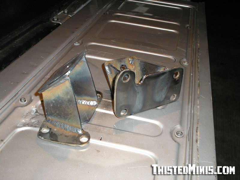

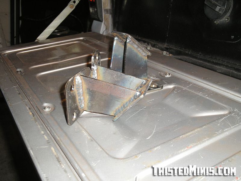

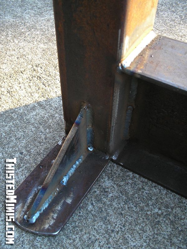

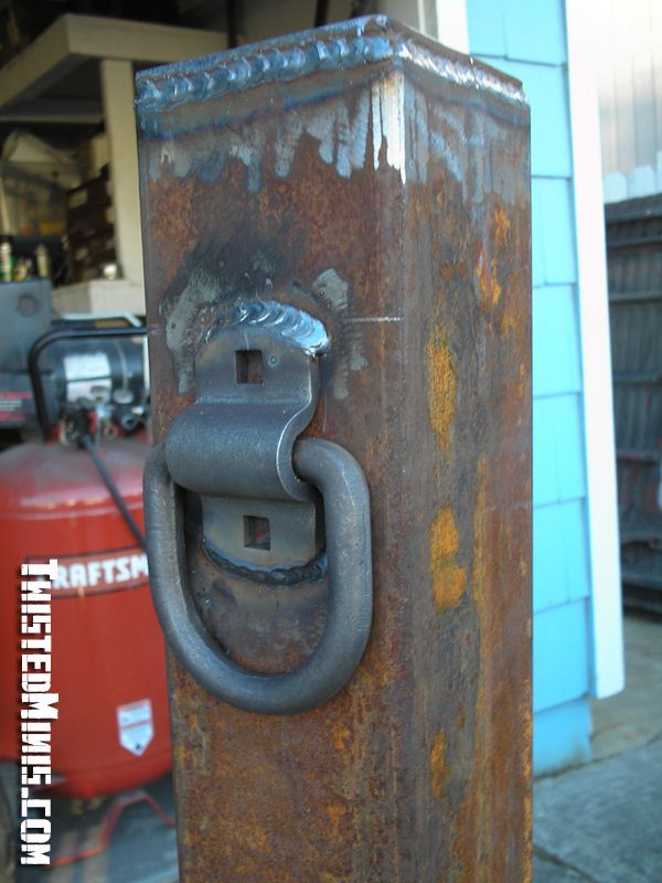

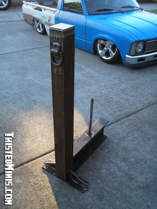

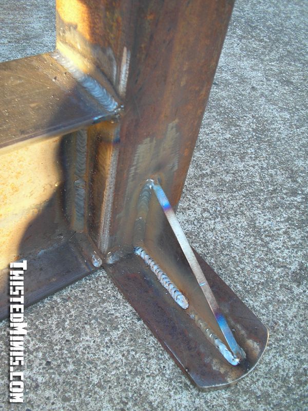

Got a random side project today, so I focused on that. I'm not entirely sure what it is, but he said it is going to get some weight stacked on it, and get pulled against. Said something about a treadmill as well. Its kinda beefy for a workout machine if you ask me, but I think it turned out nice. Everything is 3/8" wall, so its heavy.
Those are the smallest D-rings I could find.
airgasim's avatar
airgasim
LMAO...I dont know what it is...
Dude your going to build a weapon for Osama And not even know it.
Make sure you put a twisted minis sticker on it before you ship it back to Afganhistan.<---Dont care how to spell it ,at least i tried..
Great looking welds Man.Nice work
