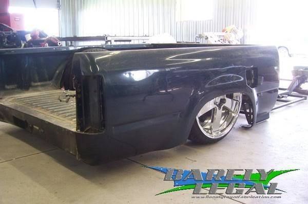

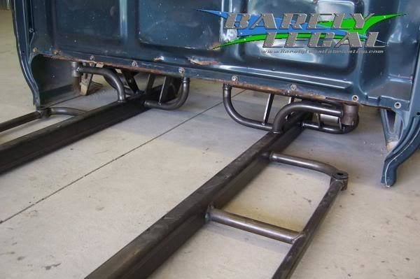

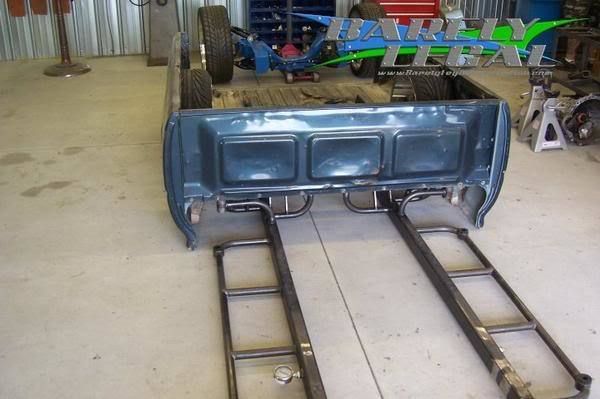

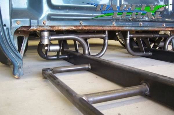

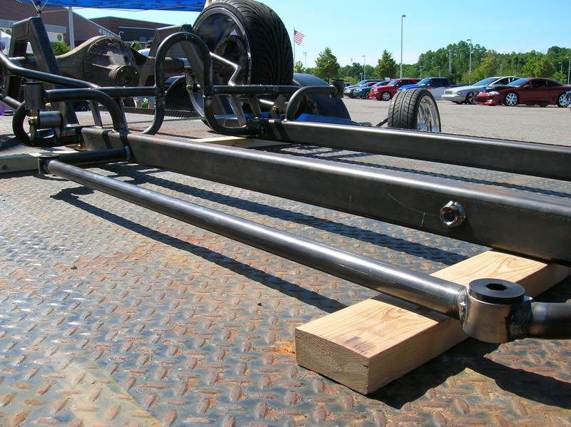

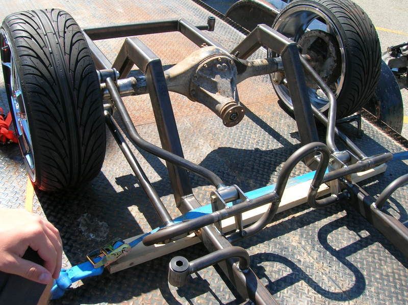

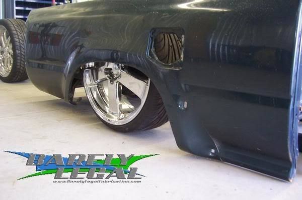

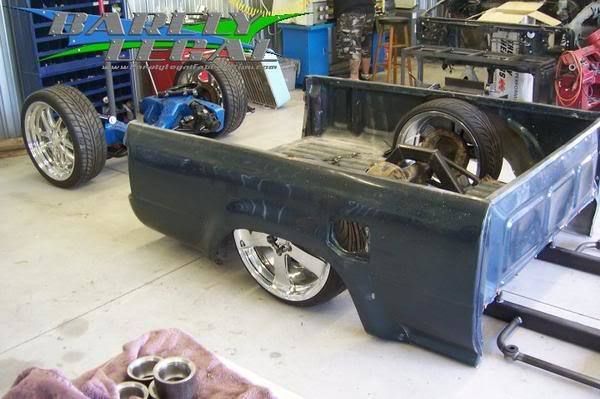

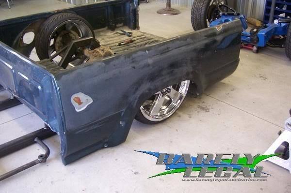

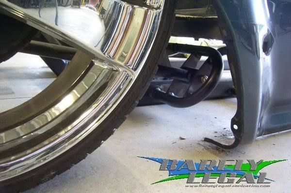

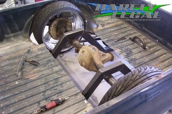

94 Pickup. The frame is being built rate now a Barely legal. Its stock floor bd on 20s the frame is going to hold the air its caped at the end(pass and driver) where it conects to the stock frame, the whole 3x2 is holding air.. It is 5.09 gallons.

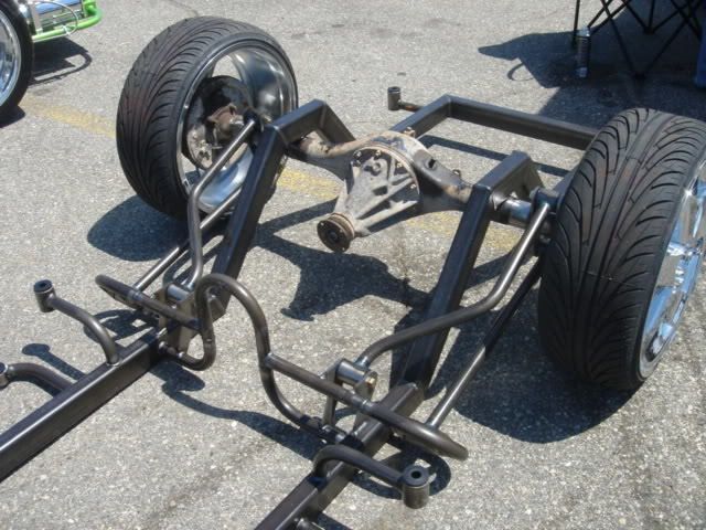

We are using air over shocks and a forward leverage link(round bars not square bars) for the rear. And new one off tube control arms for the front with anouther pair of air over shocks.
Heres some pics

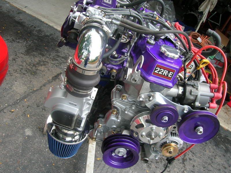

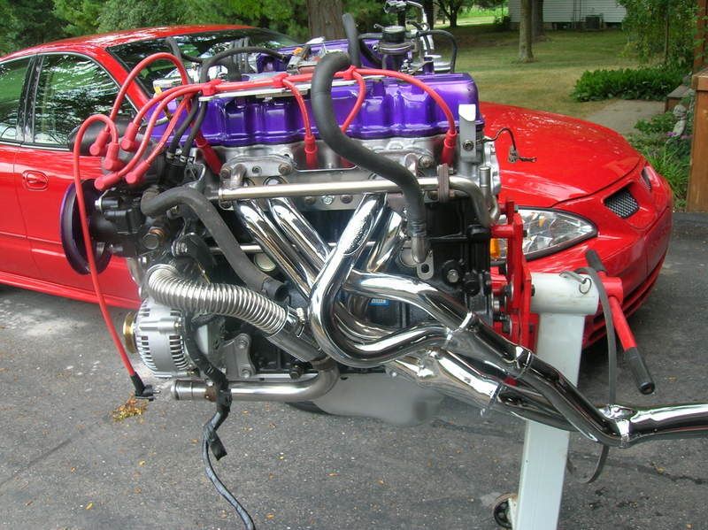

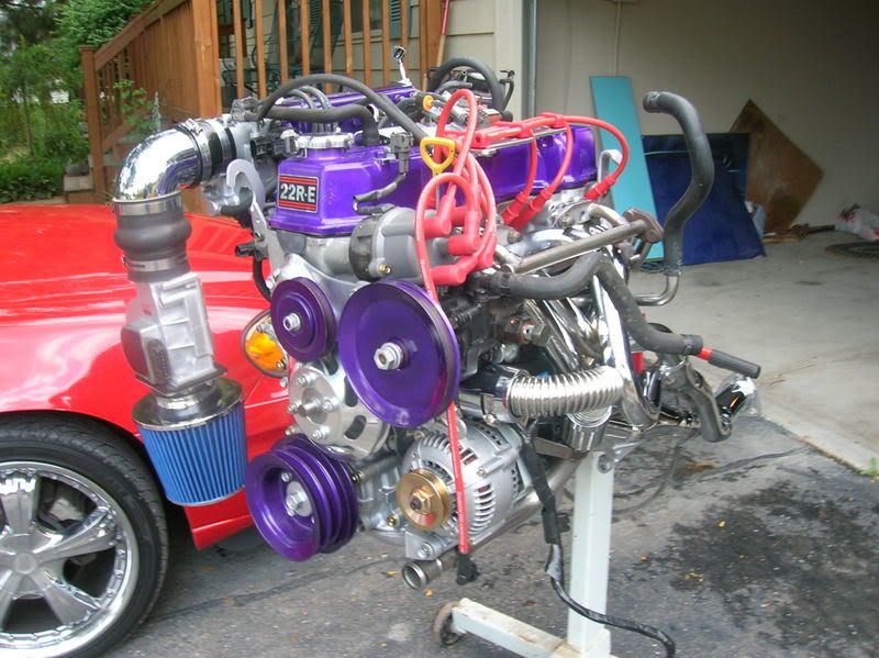

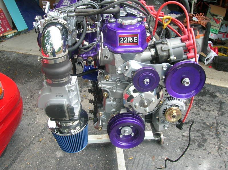

How my engine started 250,000 miles on it

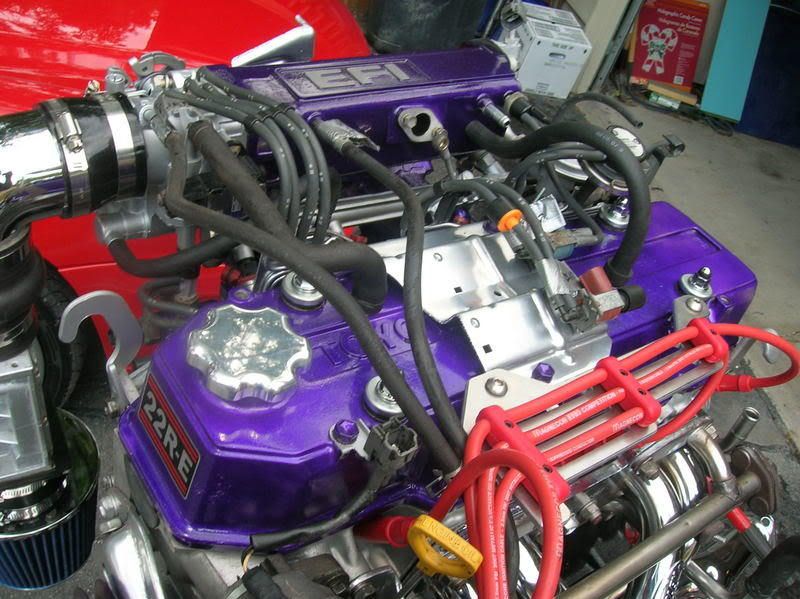

engine after me and my dad worked are buts off and alot of time and money

nice work. I like that frame, pimp. is there any lateral axle location needed with that link setup?

very nice...awesome color on the intake & valve cover!!
toyotaman89
is that the original oil dip-stick? Mine is all metal, bent to a circle at the top, but its a 22r...
smctoy's avatar
smctoy
The oil dip stick on my 91 looks the same as his & its got the 22re motor as well.
W
watatoy
Thanks guys yeah its the original dipstick

I like how the 4 link bars look parallel but because of the bend and where they are attached to the frame its triangular. Nice.
loweredtoy
could just be me but are they gonna brace those new rails for the cab mounts?
