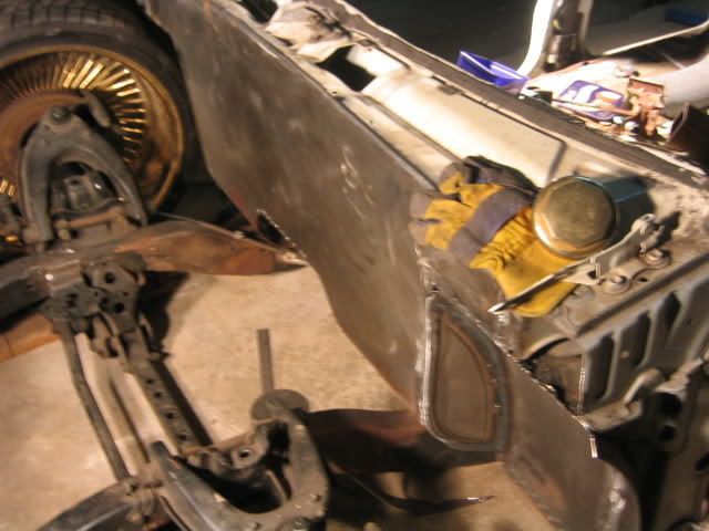

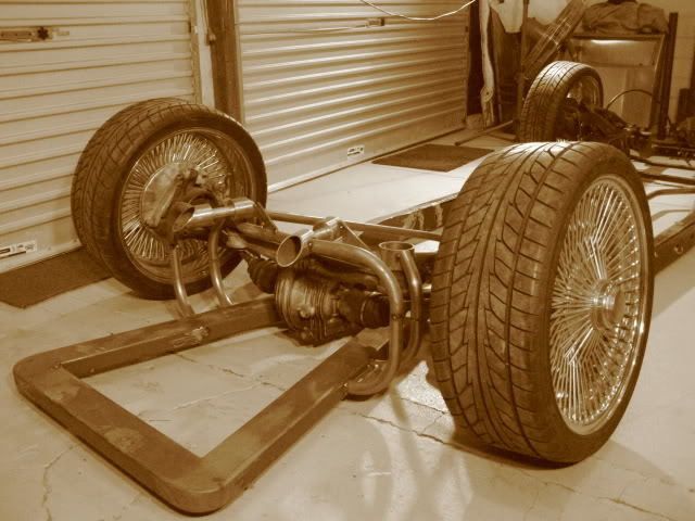

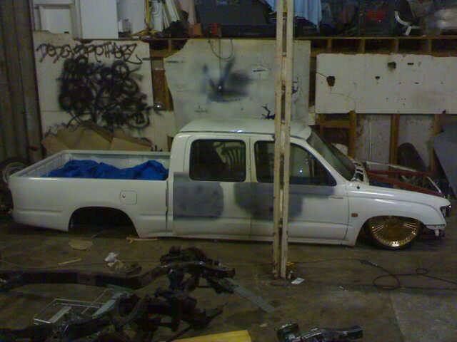

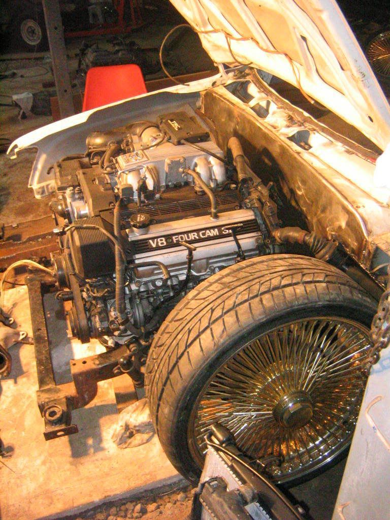

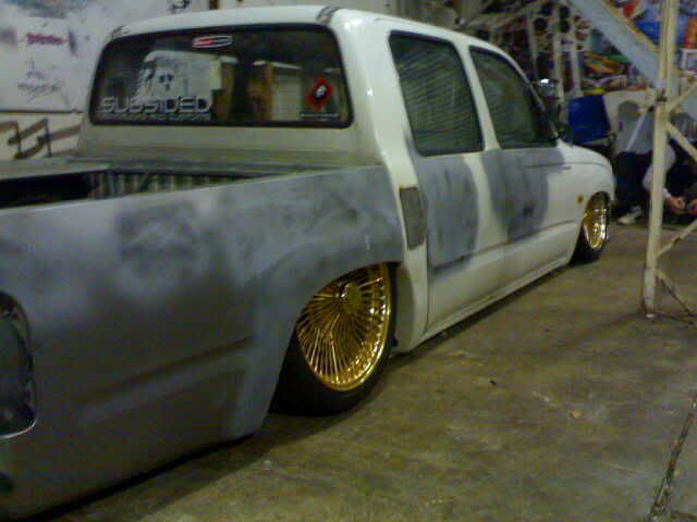

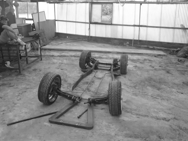

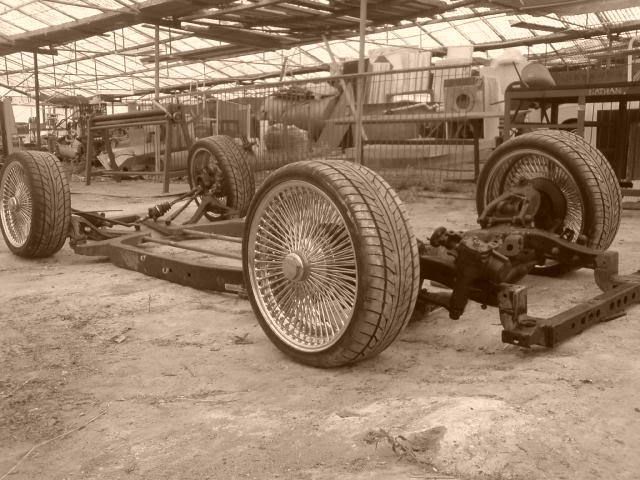

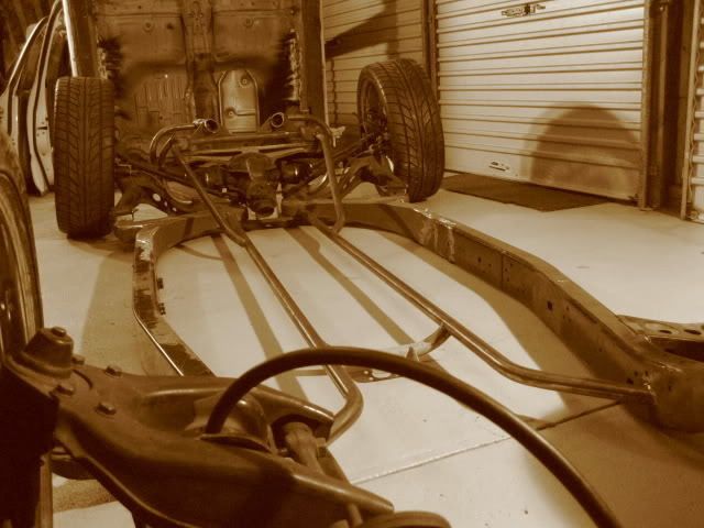

my names brad from aus..been building my truck for quite some time now..well workin on it when ever i get the chance..which isnt often since starting my own business..but its coming along...i pulled it off the road about a yr back ..cut the old rear clip off and started designing the new one to be built..started shopping for a rx7 irs set up..since then ive built the frame from the centre bearing cross member back..i chucked out the sub frame from the rx7 and fabd up some new brackets to mount the rx7 trialing arms to the frame.

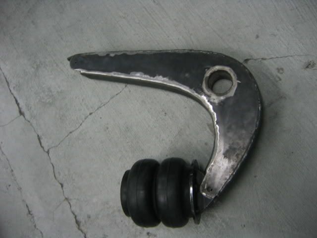

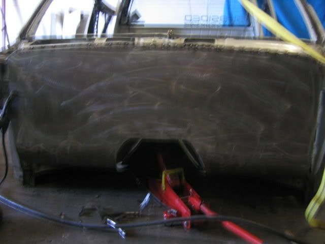

ive body dropped it 3 1/4 inchs ( an inch past the pinch) new fire wall and rear fire wall..both tubed for 22s. im currently workin on a rear cantilever set up for the rear..and also custom stainless steal tubular rad support ..sporting some fance lights behind a phantom grill..
also lurking behind the phantom is the 1uz-fe replacing the 3rz..
the interior i havnt thought of yet but i may use the stock lexus dash that came with the front cut...
welll i could go on for hours so here are some photos of when i first bagged it
and here are some with the new work i have done..ill have some close up shots of my irs set up in a few days
