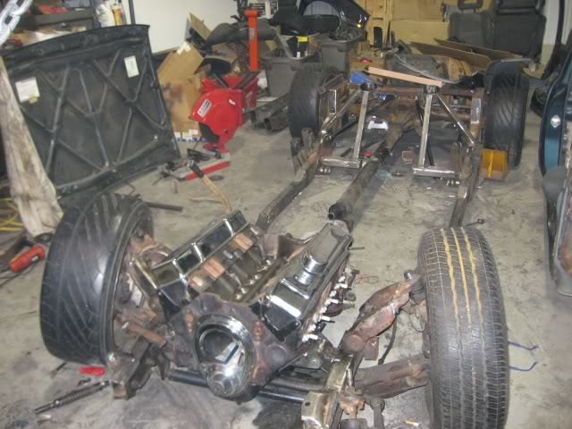

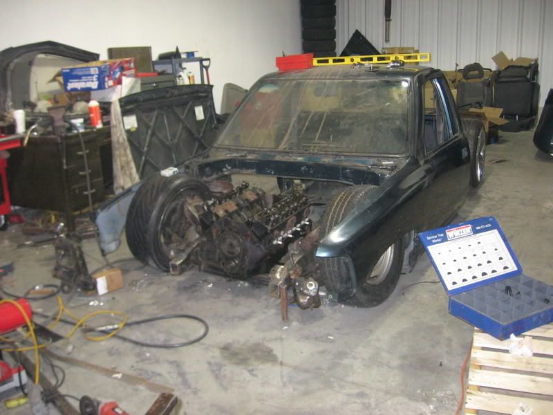

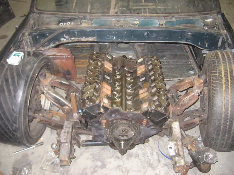

Well. ive had this truck since decemberish.. some of you probly know me from mazdabscene, or s10forum, i had a bodydropped mazda on 18s, and a ext. cab longbed silverado bagged.. Now i have this 95 yota. bone stock.. well. WAS bone stock. plans are bodydrop to the rocker. shaved up, on 18s. progress is slow but stready.
when it rolled in:

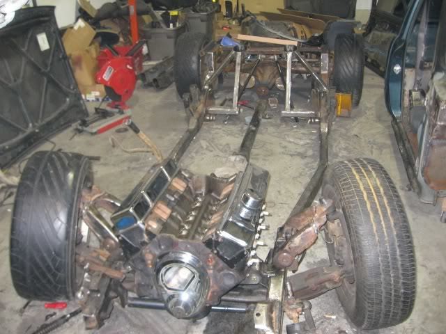

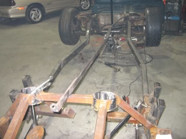

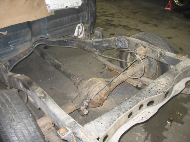

frame stripped:

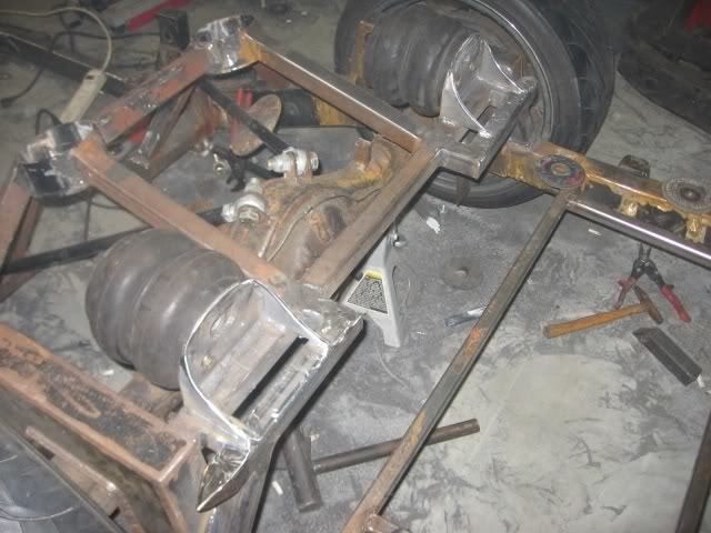

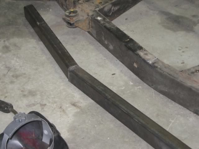

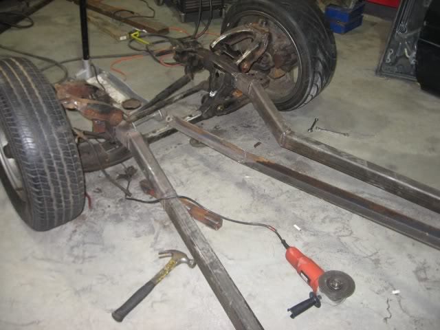

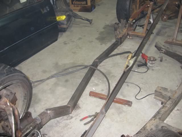

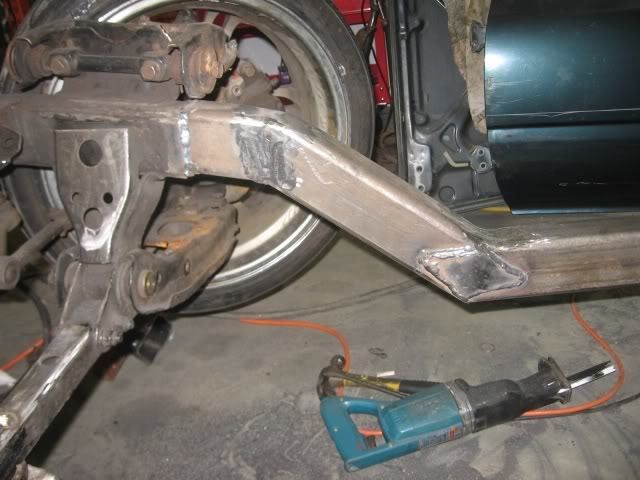

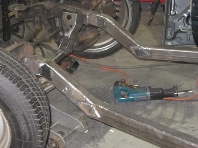

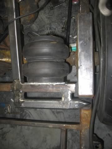

Notched:

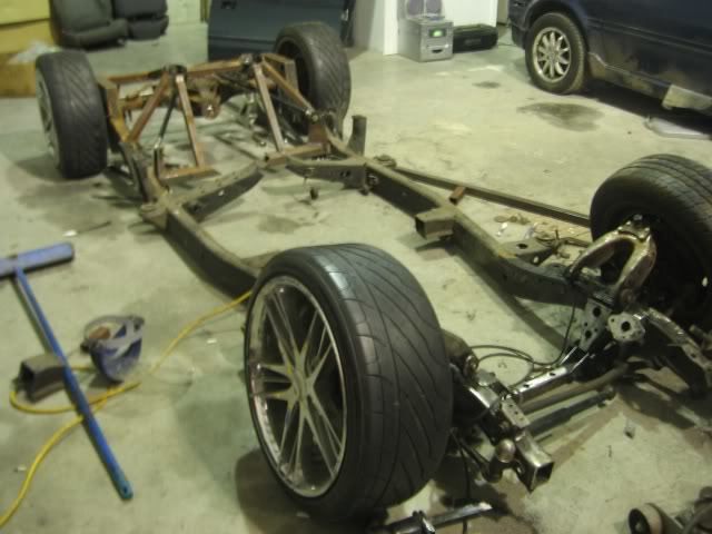

Notches are 6" notches. I figured that would be enough to lay 18s and still have a little bit of room left. I didnt want huge ass notches like some people do, i think it looks stupid with 8" between the axle and the bottom of the notch laid out lol

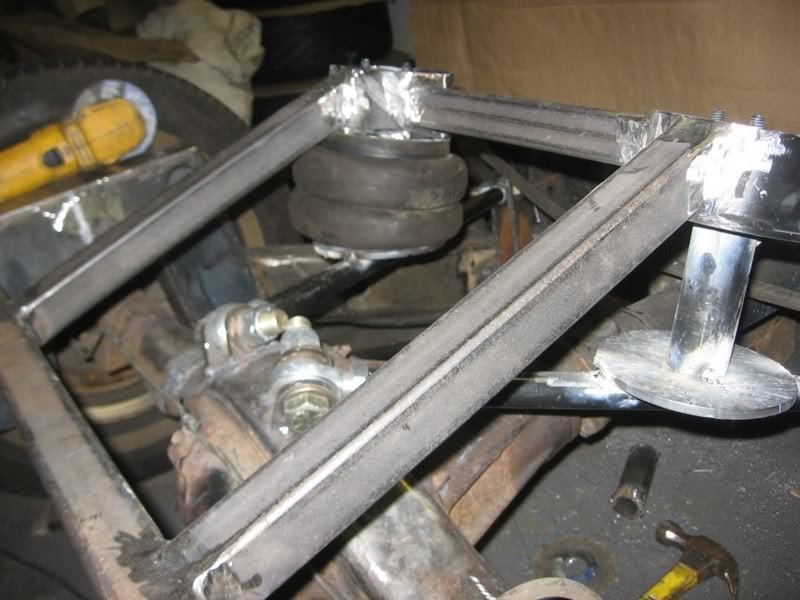

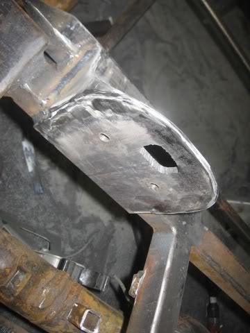

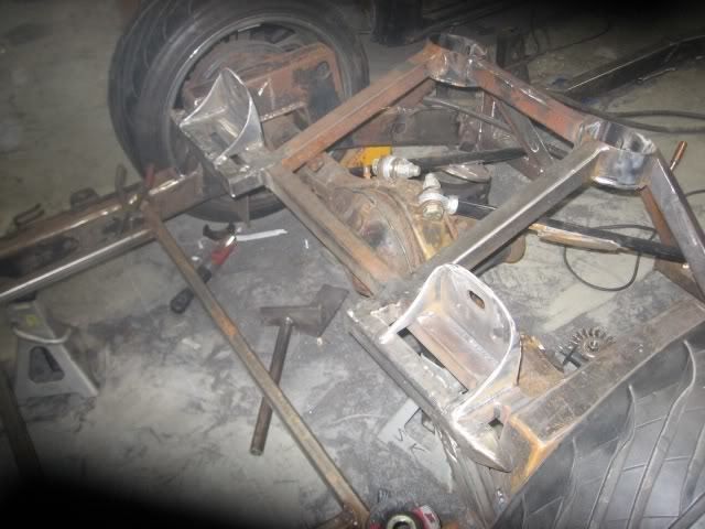

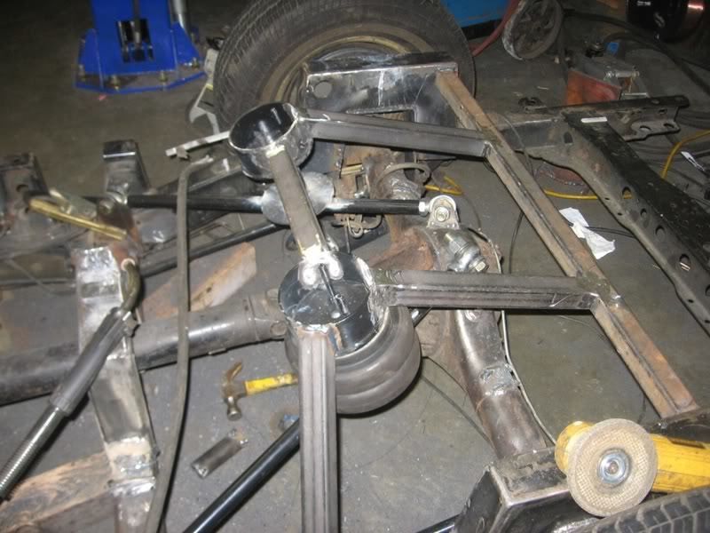

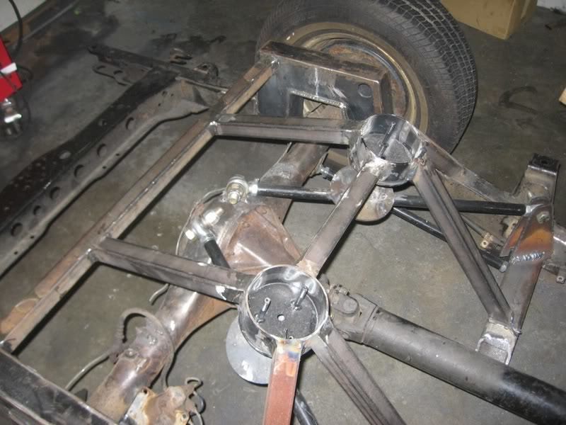

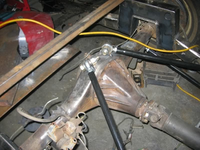

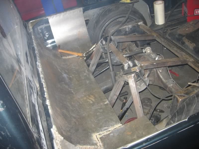

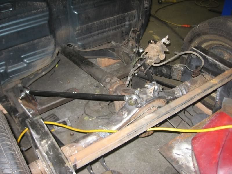

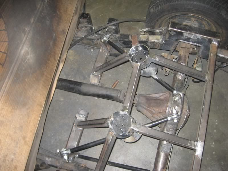

4 link:
its an fbi universal link with 5/8" heims, its actually a pretty nice link for the $150 i got it for. It will be more than enough for what i need.

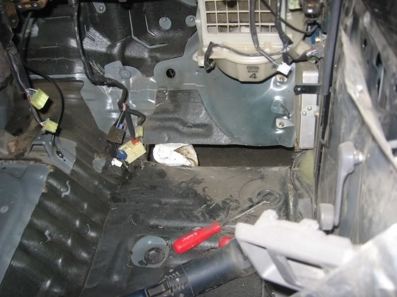

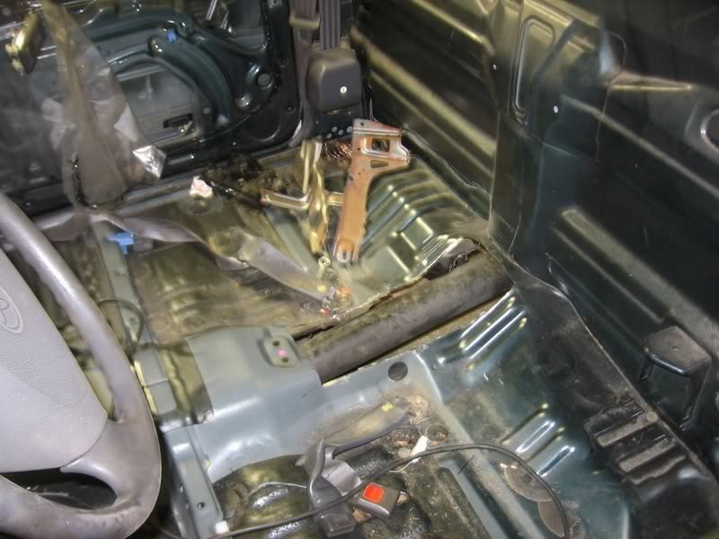

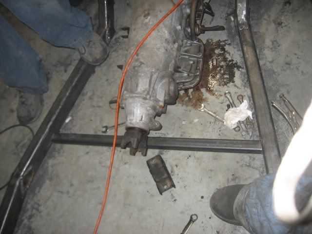

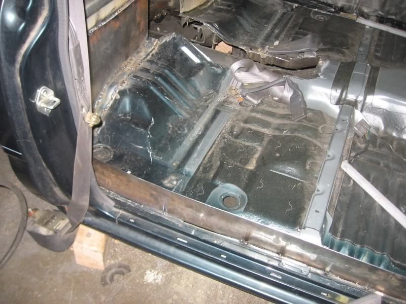

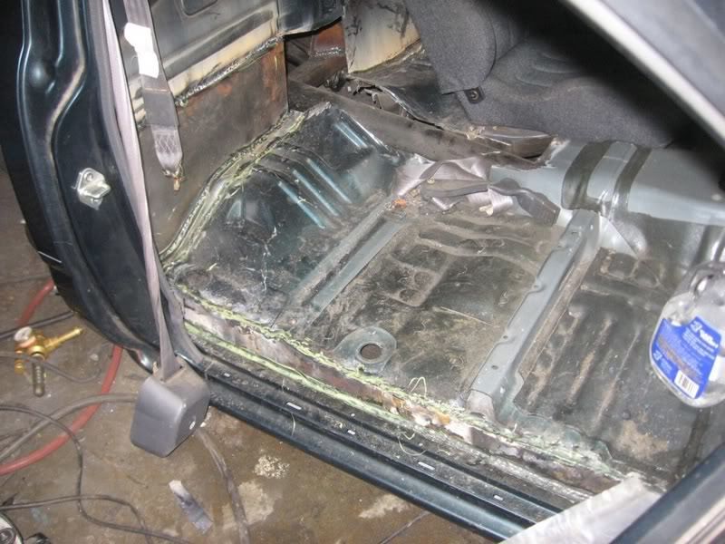

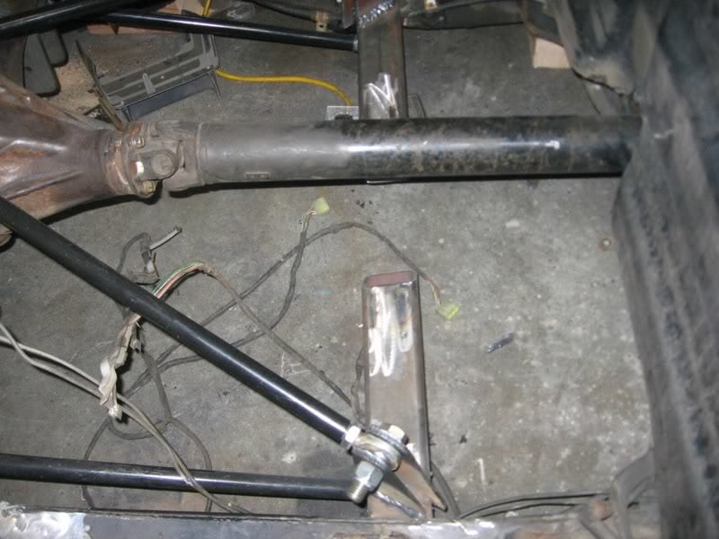

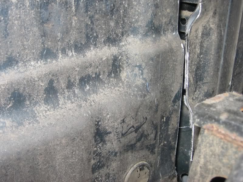

driveshaft tunnel cut:

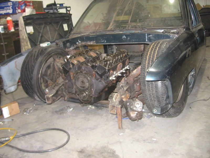

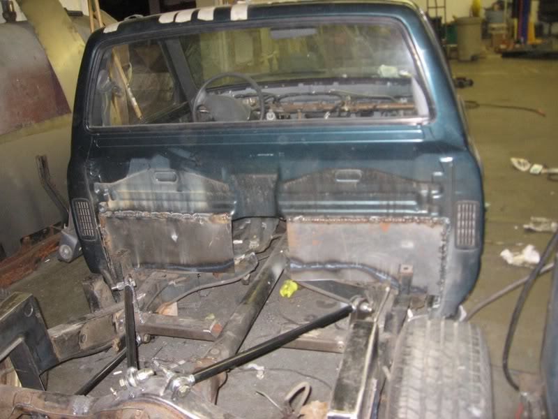

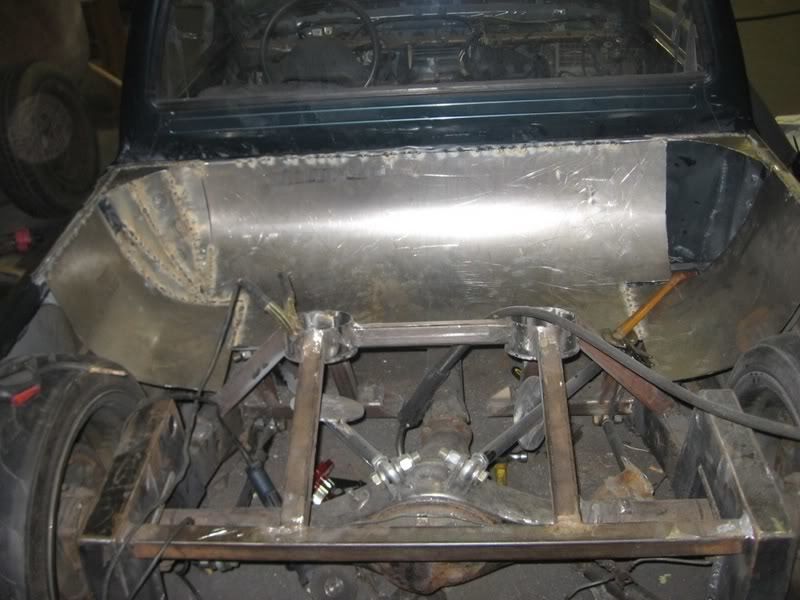

And started cutting the firewall:

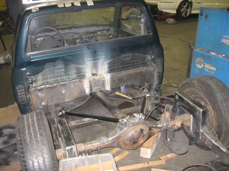

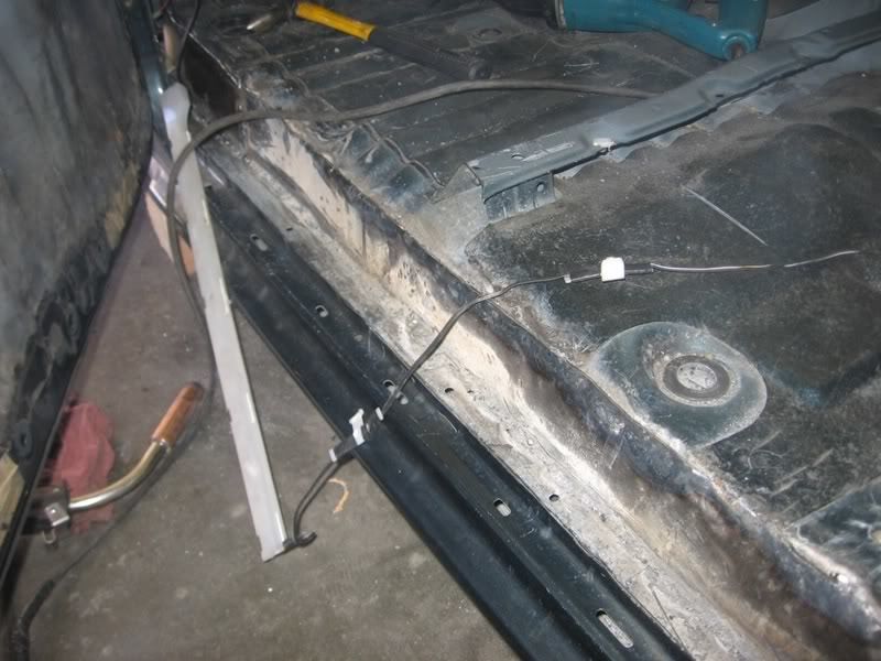

Last night i got the rest of the floor cut. all i have to do to drop the cab is cut the back wall, and the frame horns. and that should be done today. might even start welding it all back up today.

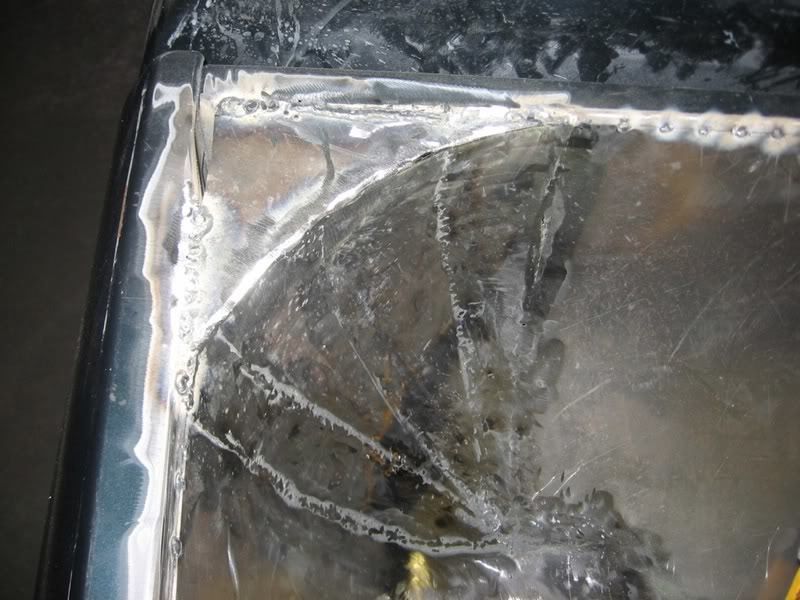

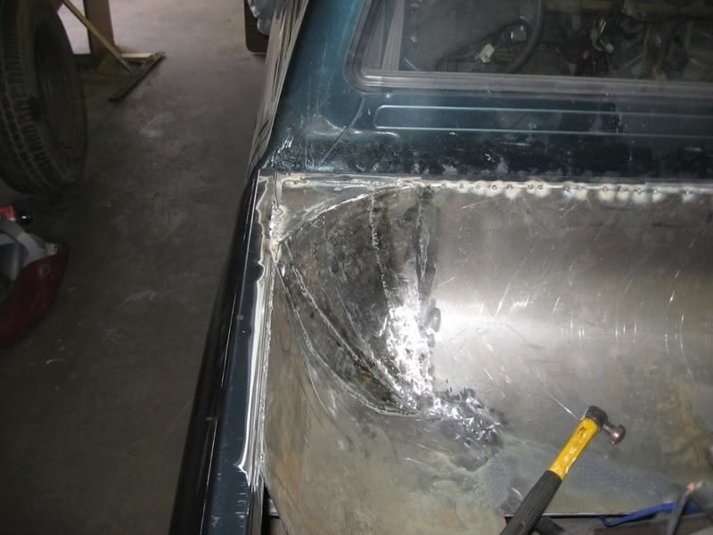

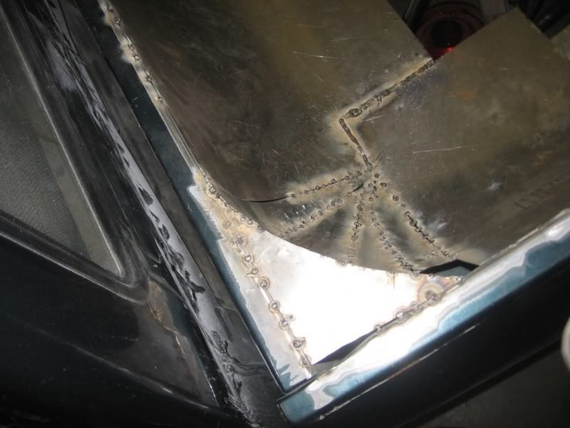

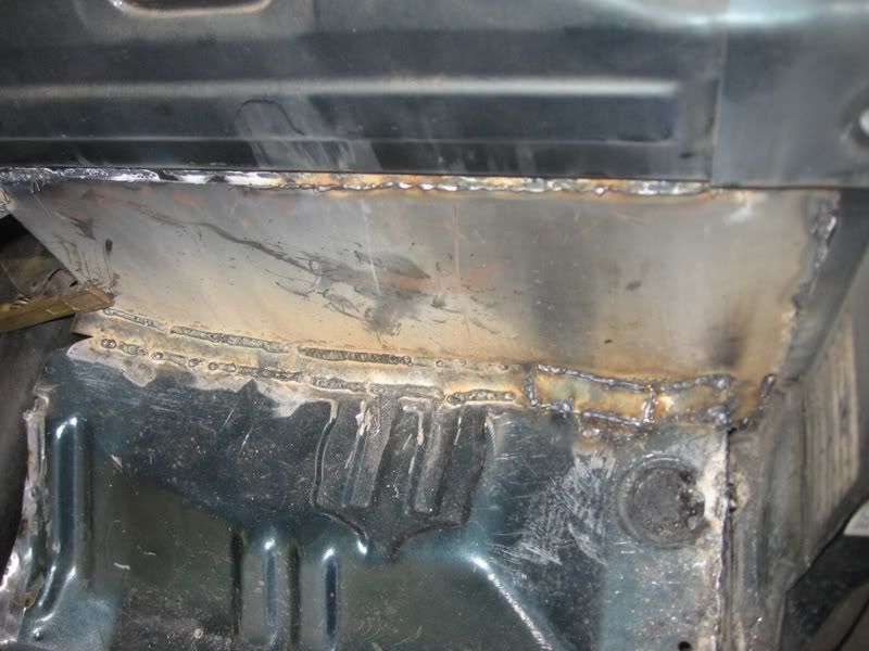

got the cab dropped and started welding up the back wall today. ill take some pics tomorow, my camera died on me, and i had no batteries. tomorow i plan on finishing up the back wall and hopefully start on the side fillers.
