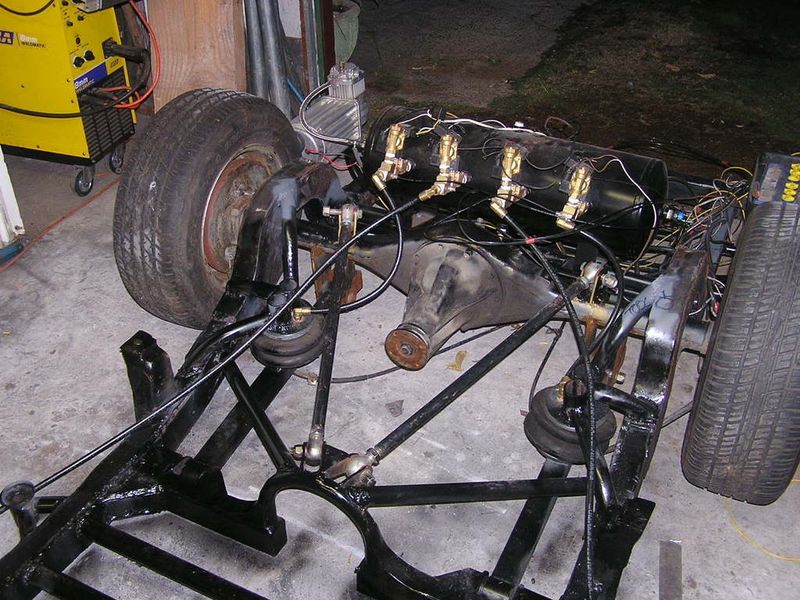

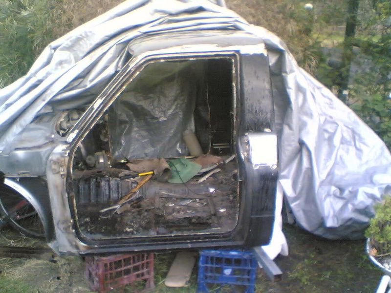

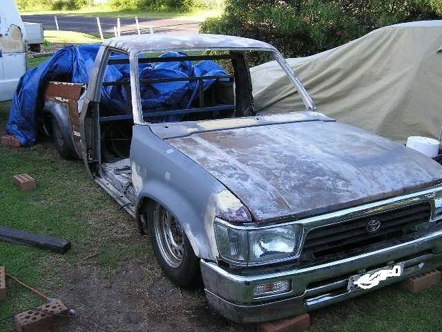

i picked up this yota about two years ago, i stumbled across it in a local trader mag, at the time i was working on a 79 yota, it had major front end damage, i bought a 81 cut the front end off and gave the 79 a new front end, the motor siezed on the 79. not my fault i had a cover over the engine and the place i was storing it at a guy there decided he needed the tarp for something so he ripped it off and rain poured i to the engine over a few weeks and screwed it, on my way to find a 18rgeu twin cam motor i found a 82 truck locally with the motor already modified and running in the truck so i bought it with no gearbox or bed and used the three trucks to make one decent 82.
i took the 82 off the road last easter to bag it and got carried away and have redone things many times cos i was stll learning the whole way but now basically the frame is still in my garage all most finished with the following work done

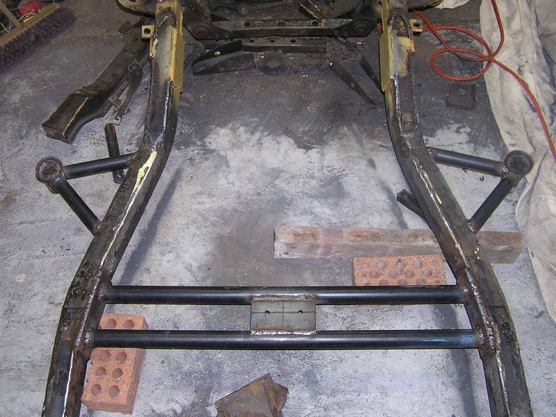

airide notch

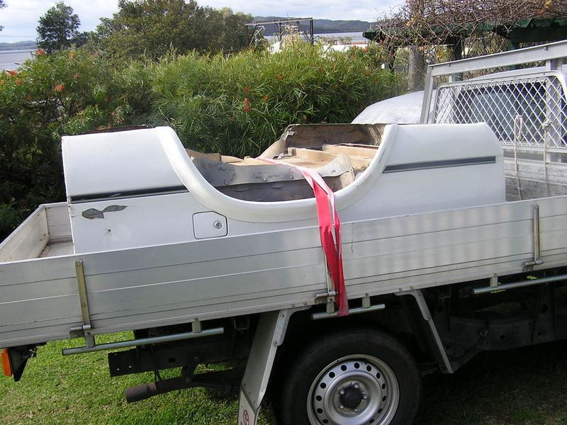

shortened frame 240mm so i have the shortbed look.
tuck shop cante 4 link
stock floored
zed notched
umm another zed notch up front to lower the cab horns
castor rods gone, hoping to make some adjustable half lowers
1987 IFS setup.
chassis tech drop spindals, the only one i could get in the country at the time.
shaved gearbox xmember, no spare tyre xmember
18rgeu motor

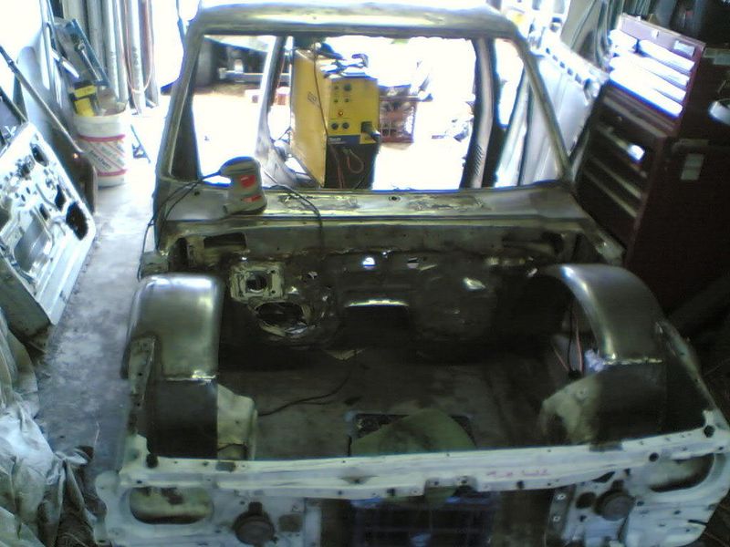

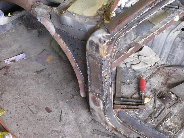

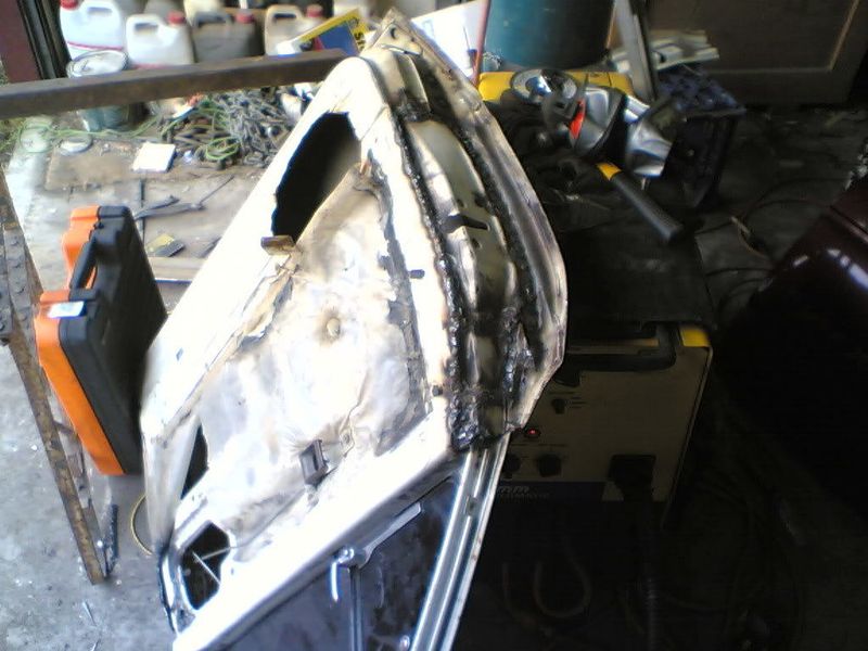

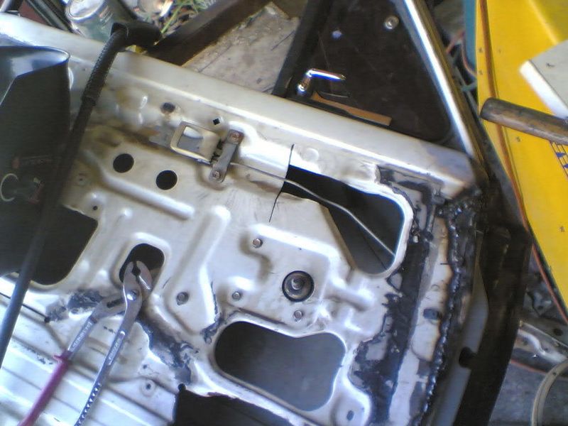

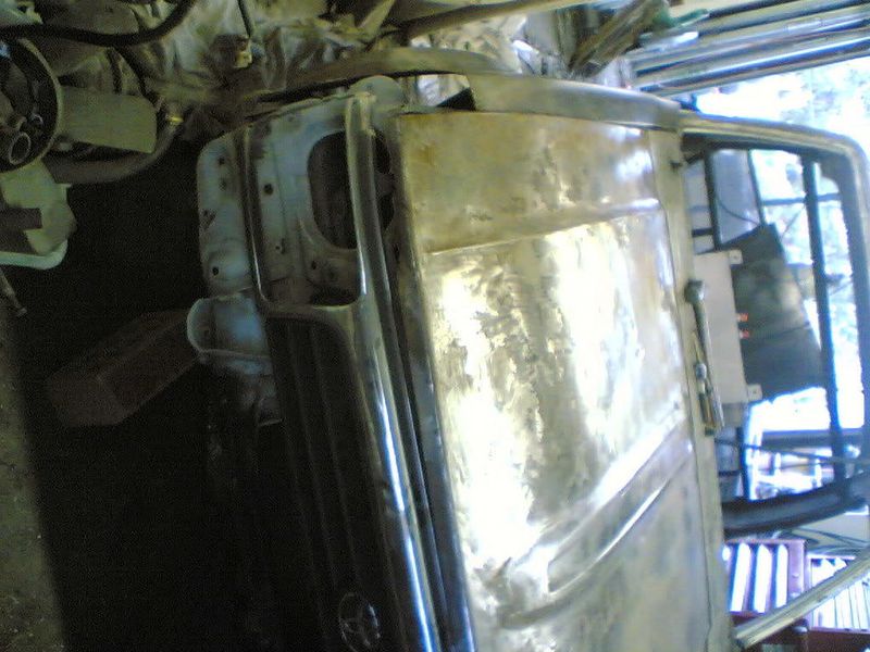

shaved cab n doors n tubbed firewall but havent really worked much on the body in a while.

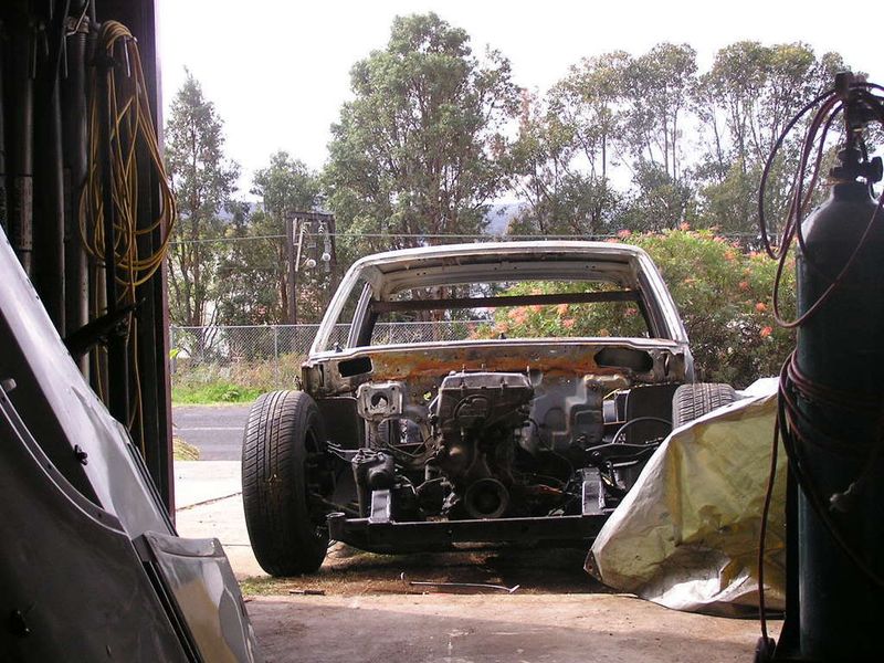

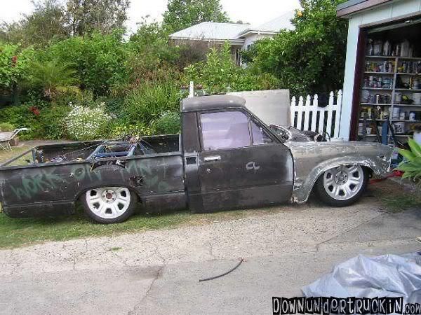

heres a few lil pics.
when i threw the cab and bed on, no spindals then
latest bit of work up front of the frame

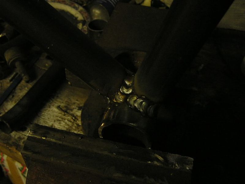

oh yeh i dropped the motor mounts as well, u can see them on the 2nd pic

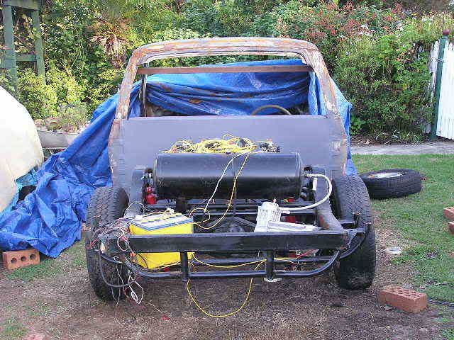

been a while, but yeah rebagged the front and got a van to get around in

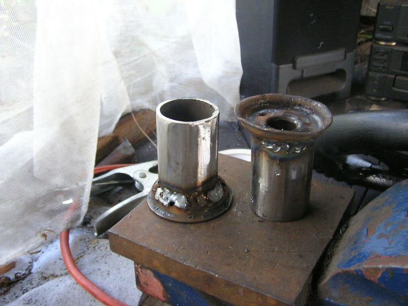

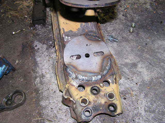

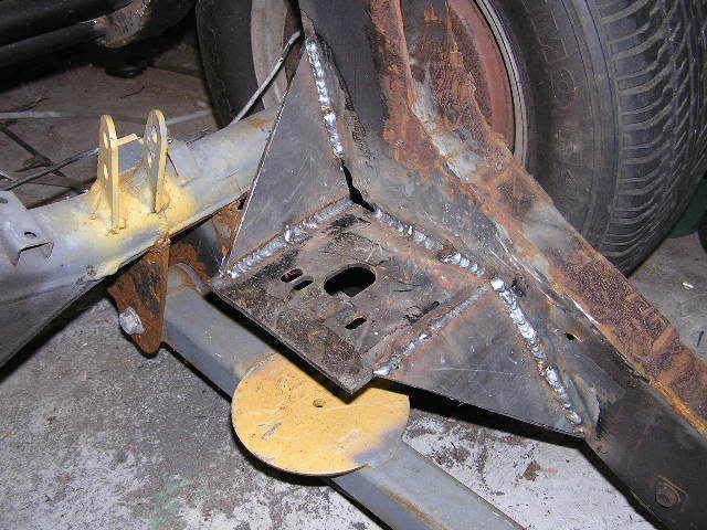

wtf did you do to those mounts!!!! lol
phatboislim
modification 01
TB
tommy b
the upper control arm mount?
took the outer skin off it cos it wasnt doin anything and put the nuts back on it
