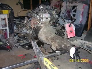

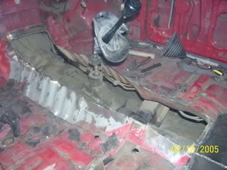

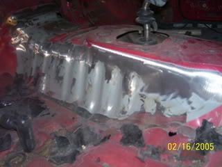

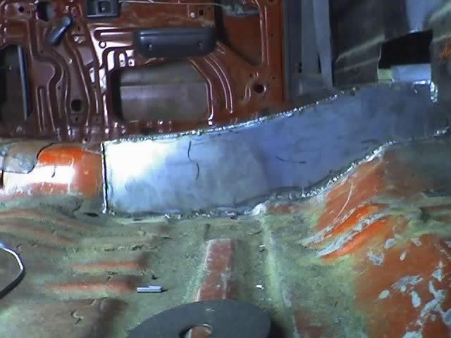

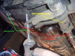

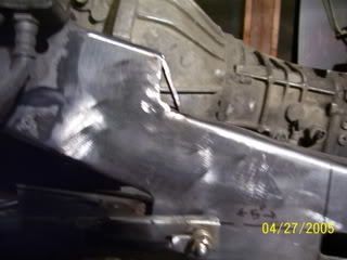

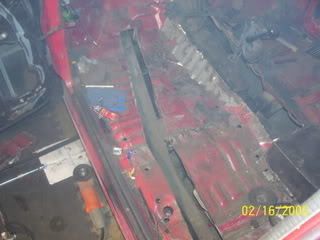

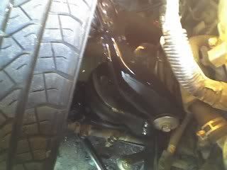

Well i finally wanted to get my project thread going, I got some pics of what i have done so far.
This Is my first bagged truck so bear with me if i F somethings up.
I figured I will have 2 stages of build.1 was just to get it bagged and ROLLING!Well while doing it I have learned so much ,that i want to ripe it all out and do it again,but I will finish what I started and roll this summer.
Next winter I plan on being Z'd and bd to the rocker, on 20's.And a lever system.
I did some editing on some pics earlier to help some buddys out so dont mind em.

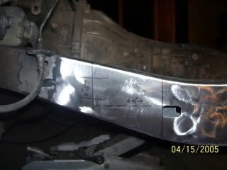

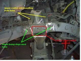

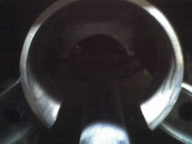

remiving the torsions
labeling my front

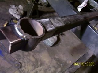

cutting her up

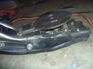

doing the lowers
front done

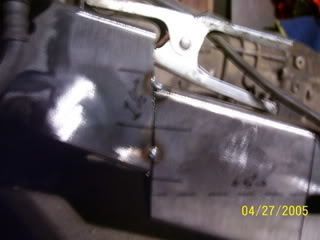

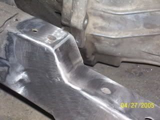

doing the notches
temp x member

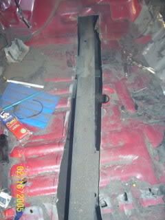

drive shaft tunnel
the bare necessites
I still got pics between but eh thats enough for now.

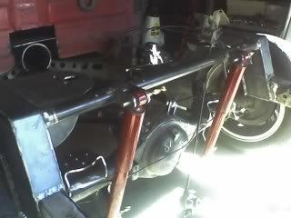

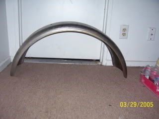

The newsest addition to this project
I mite try to get'em to fit for this summer but i will have to wait and see.

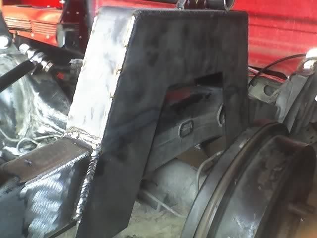

mulisharider11x
got ne more pics of the front bag brackets?
airgasim's avatar
airgasim
Yea .I will post em tonight .Around 8 pm.

some new pics.
://i65.photobucket.com/albums/h213/airgasim/100_0296.://i65.photobucket.com/albums/h213/airgasim/100_0285.://i65.photobucket.com/albums/h213/airgasim/100_0286.://i65.photobucket.com/albums/h213/airgasim/100_0282.
twisted minis's avatar
twisted minis

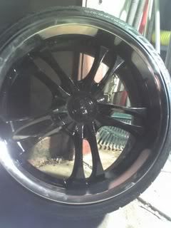

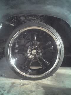

Is that as low as it goes in the front? And is that a HD emblem on the grill?
airgasim's avatar
airgasim
As for the front ,thats it for the front with the 20's,Hits the shit out the firewall pinch. .I just wanted to get a couple shots in daylight.BUt yea thats a harley emblem.lol.
It 's kinda stupid when people ask me "did that come like that" ..lol

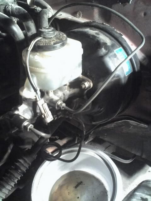

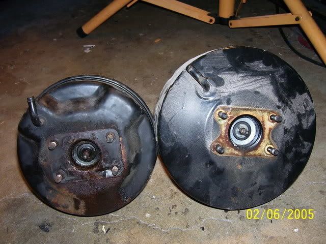

Got my booster.
side by side shot showing the diff.
Some flash rust but its good.
So gotta clean it ,paint it and reinstall it.
Oh cut some pinch and wacked in the firewall a lil to get em to tuck a lil more.Just till I get the tubs right? right!
twisted minis
Looks good.
Did I send you that booster? It looks like one I sent out last week. Lol.
airgasim's avatar
airgasim
lol..no..(got mine from action minitruck dismantlers so elmonte)
So i had to mock it up."just to make sure"
So my 91 master ,and a donor 82 booster.This process was str8 bolt-up!
took off mine ,toss the spacer,bolt the lil one up,put my master on,Pedel lines up perfectly no-mods.
laidout94toy's avatar
laidout94toy
I should get a booster like that, I dont really need anything smaller its just way close to my wheels.
The one you got is from a 82 Toyota?
