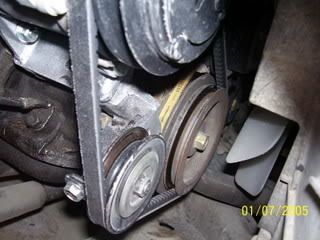

Heres a couple shots of it installed .I didnt take any pictures during the install,cause itwas a pain to find the stock a/c stuff.My truck didnt have a/c to begin with.But i do have the bracket that supposedly mounts on the factory a/c but never had it to check for sure.

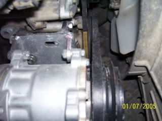

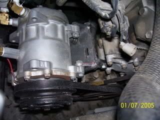

I installed mine tonight and it fits perfect where the ac comp went
Bracket:
Installed:
