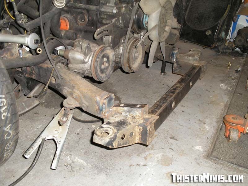

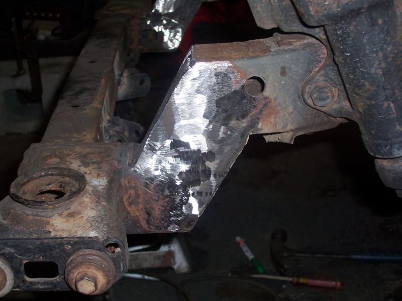

we strarted my frame proyect this week and this is what we got so far!!!! does anyone have a picture of the radiador support after finish z frame?

You want pics of the front framehorns after the Z? Because the front core support will still look the same.

yes i want pictures of the frame horns, that is what i meant.

the front of the frame stays the same...the part under the cab that angles up drops down so your truck will lay flat w/o dragging the arms and xmember to death...

No, the front framehorns do need to drop as well. If you do not drop them the same amount as your Z your front end will not line up.
Heres a good picture of mine.
Yours won't be as drastic, unless you are bodydropping it too.
