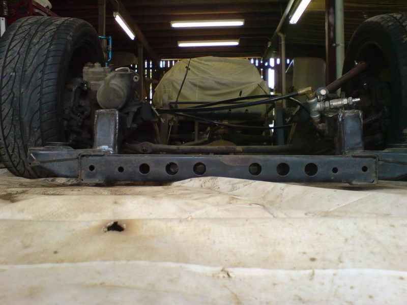

hey buddy!! this is my Z'd on my 93 toyota lux chassis! I went with a 40mm z'd which allows the engine gearbox crossmember to remain 5mm of the ground when layed out flat!!! you'll also have to lower your front horns so your radiator support fits!! my horns have been lower to allow for a 3 inch body drop also!!

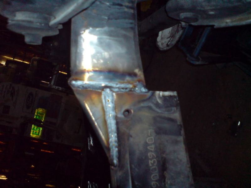

must put filler plates in (only top is in in pic but u do need one on the bottom
Gusset the Z'd for strength and weld it in
front horns lowered
