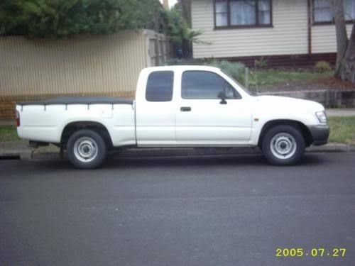

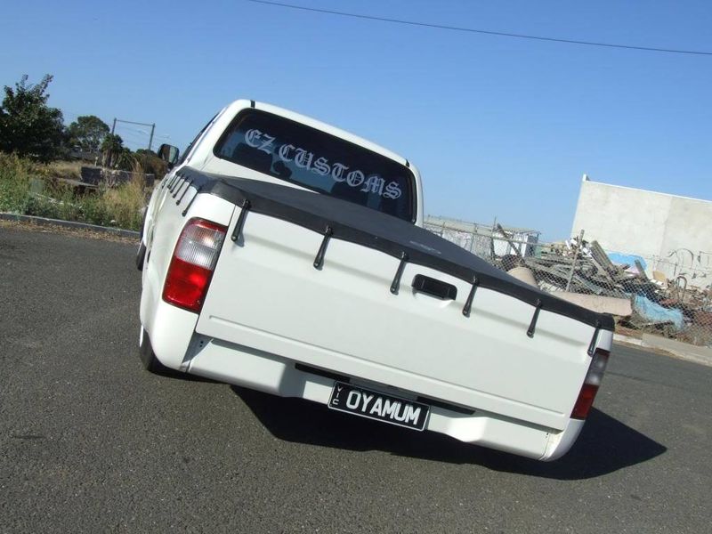

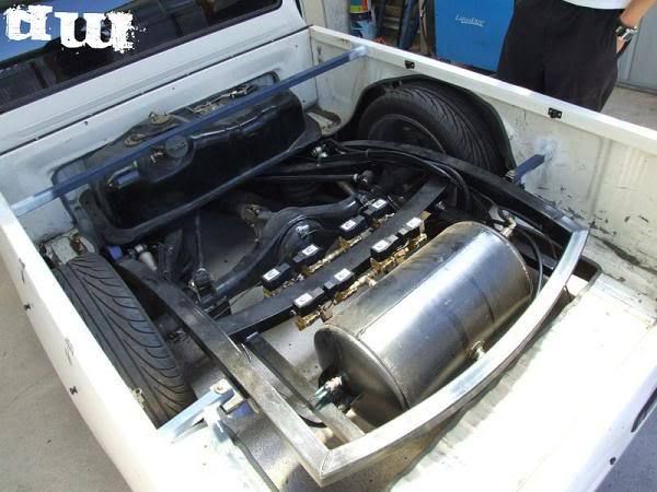

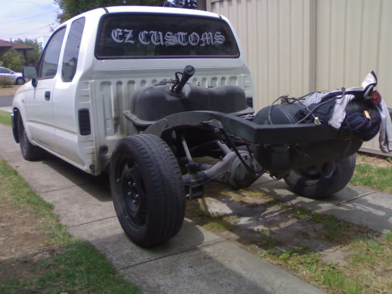

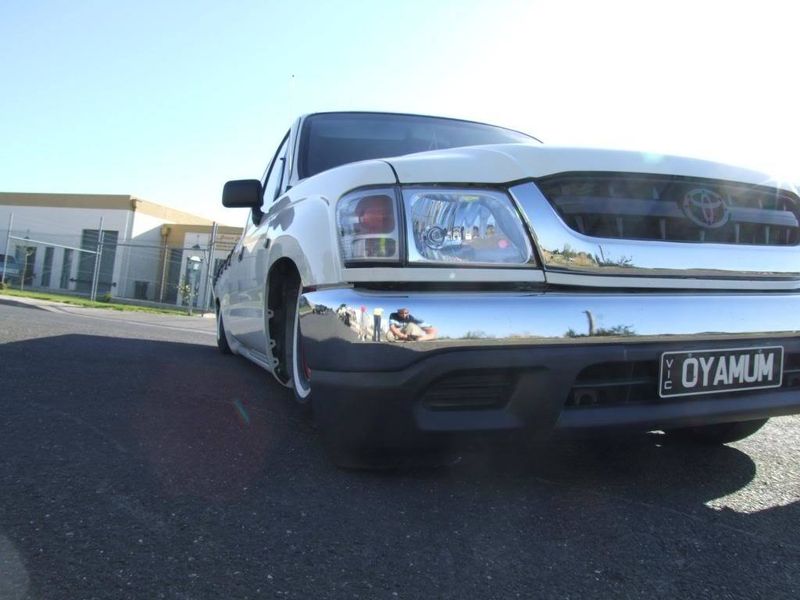

hey im new to hear so i thought id post a build up... iv got an 02 hilux x-cab bought it bought it nearly 2 years ago as a complete stocker and since then its been bagged front and rear with a tubbed firewall drop spindles in front has cantilever 4-link rear with firestone bags in the ass with a custom rear chassis clip and slam bags up front have an air zeneth compressor and a 40ltr tank... iv had the gearbox crossmember raised up so it lays frame front to back it will lay frame on 20s in the front and 22s in the ass and 1 day when i rob a bank or win lotto i will buy that 20/22 billet combo i want but untill then 19s will have to do... iv put a 4wd front with flush mount sr5 headlights and iv put in a mild system with a 7" moniter dvd player mtx front splits and an alpine 15" sub with alpine amps at the moment im in the middle of shaving it up and putting in a monster moon roof so ill try and get some progress pics when i can... so anyway let me no wot ya think all comments are welcome thanx guys....

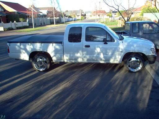

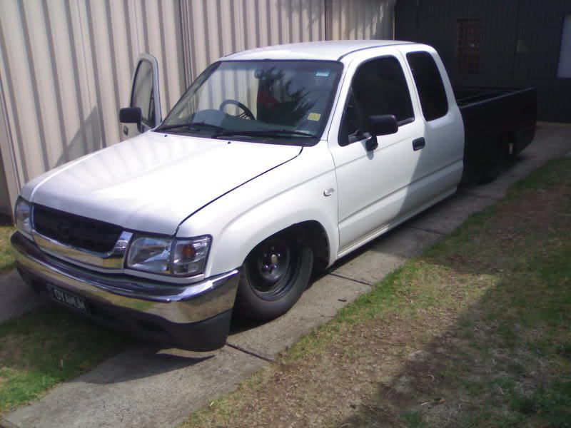

when i first got her stock as

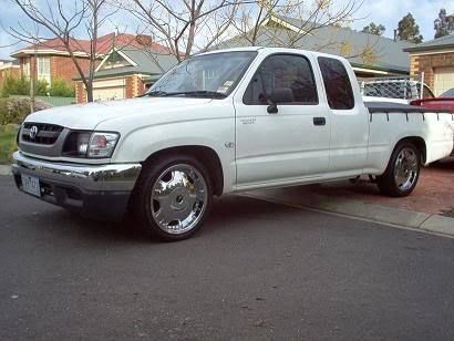

my 1st set of rims (18s) note the stock height mmm yum lol

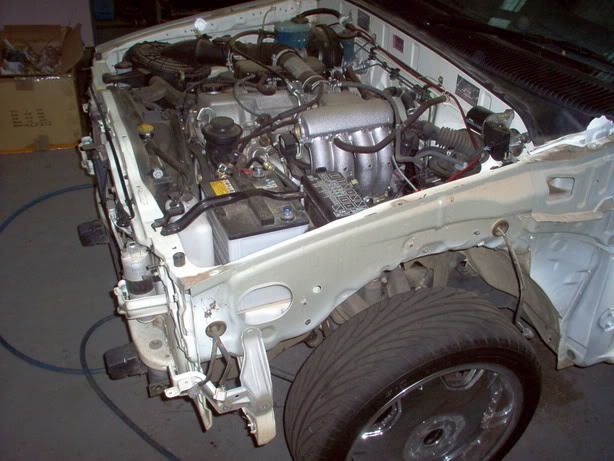

putting on the new front...

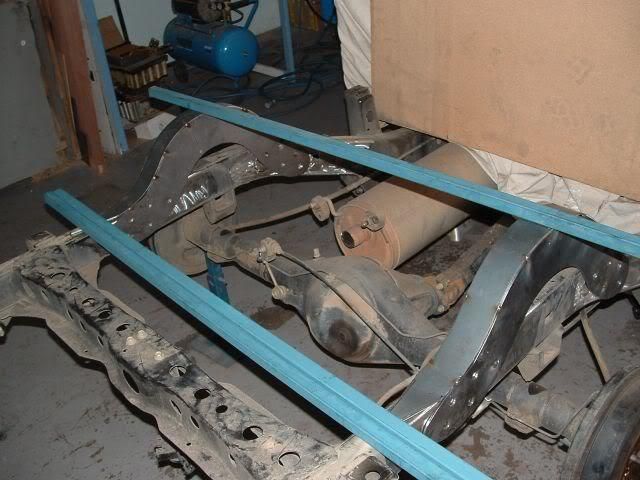

when it was 1st notched with just some flipped leafs and wound down torsion bars...

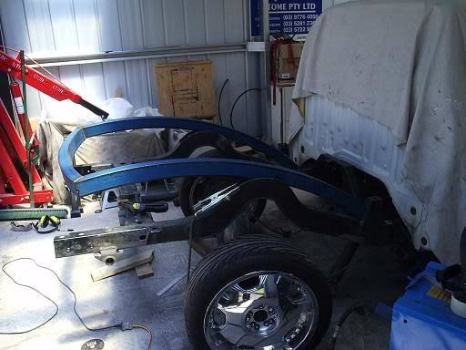

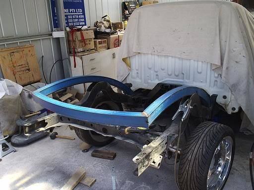

then we decided to fuck off the normal notch and do a full rear clip..

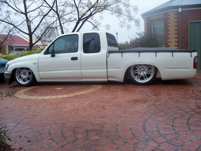

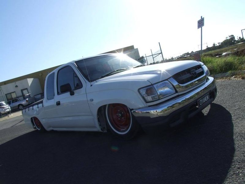

this is after she was all done with some nice red stockies and white walls...

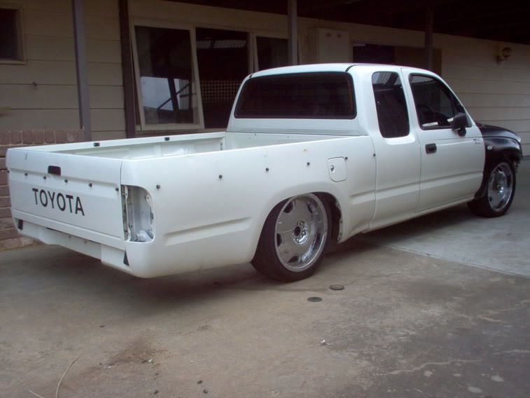

and this is how she sat last week b4 we started choppin her up again..

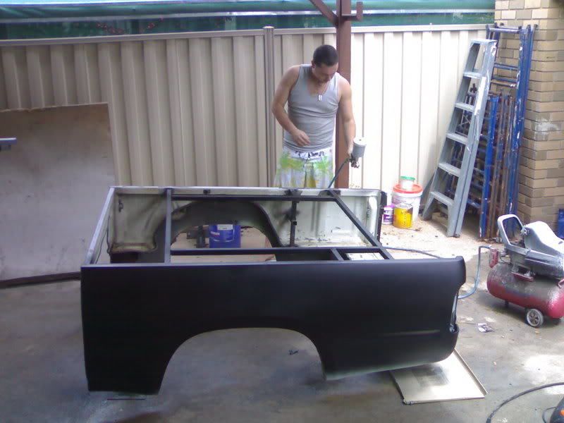

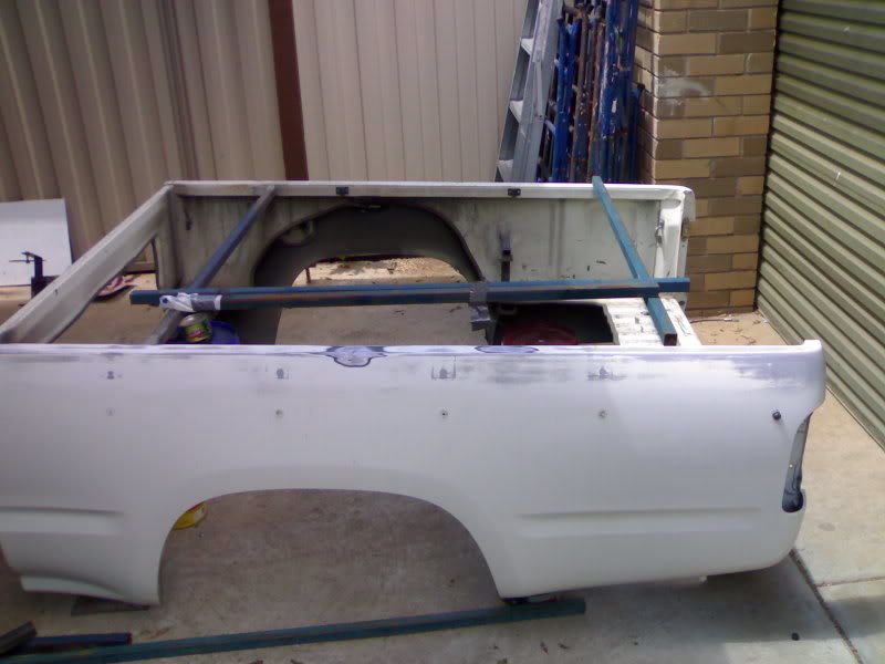

here she is with shaved tie downs with my mate benji doin some paintin....
gettin her ready to drop off at the panel beaters to get the roof cut out....

u didnt buy a new rear tub for this today did u?
looks good man I love how you did the rear frame rails!
oyamum
nah mate i didnt get a new tub recently... i did buy 1 a while back which isnt on it yet... just using this tub as a practice to polish up on some body work skills then i wanna put my new tub on which is a single cab tub so its chassis stretching time hahahaha
