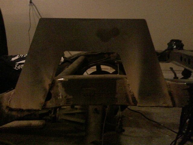

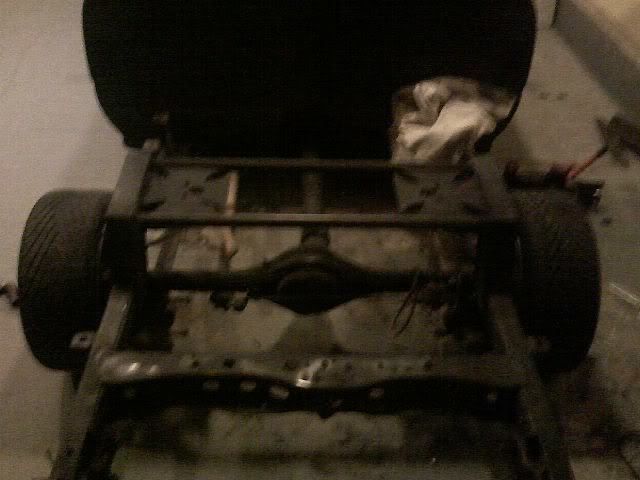

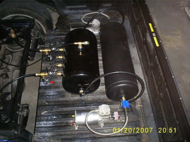

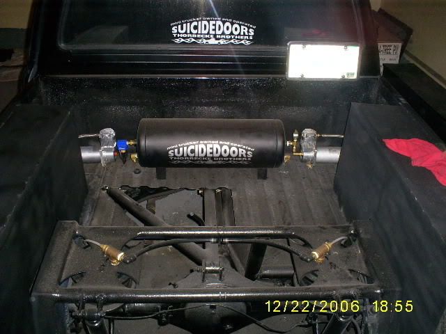

OK so you all know what im doing Here are some progress pics..
ocb_dave_ocb

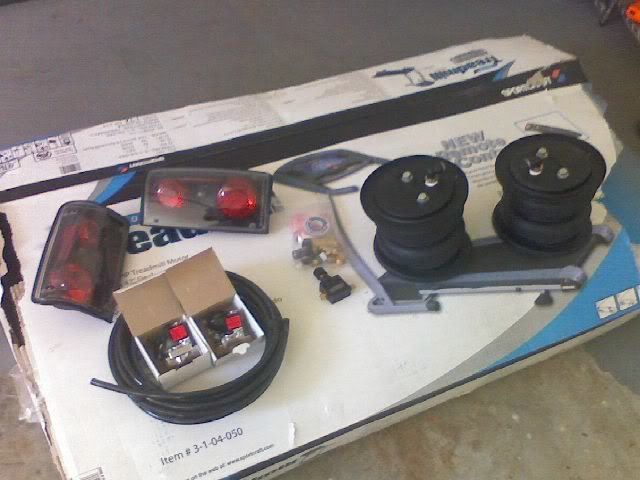

I just put in my new order at SD
Qty. Item: Price:
1 1/2" OD x 3/8" NPTF Male Connector-none-none 5.04
2 Airlift 2B7 2600 180PSI Single-none-none 109.98
1 Free Gift-none-x-large 0.00
1 110/145 PSI Non-Adj-none-none 18.99
1 25ft of 1/2" DOT Reinforced Air Line-black-none 19.99
1 3/8" Brass Tee-none-none 3.72
1 3/8" Hex Nipple-none-none 1.04
1 Loctite 545 Thread Sealant Small Packet-none-none 1.99
So far my build cost is at $484 and I still have to get my tank and comp.. There is another $200, plus my 4 link for $200.. My grand total on the back is going to be right at $1,000 then after the front is all done im going to have $1,400 in everything F.B.S.S.
Does that sound about right?
twisted minis's avatar

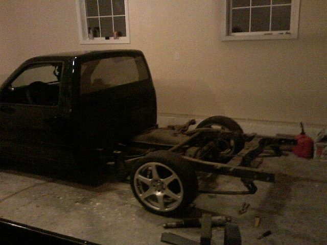

twisted minis

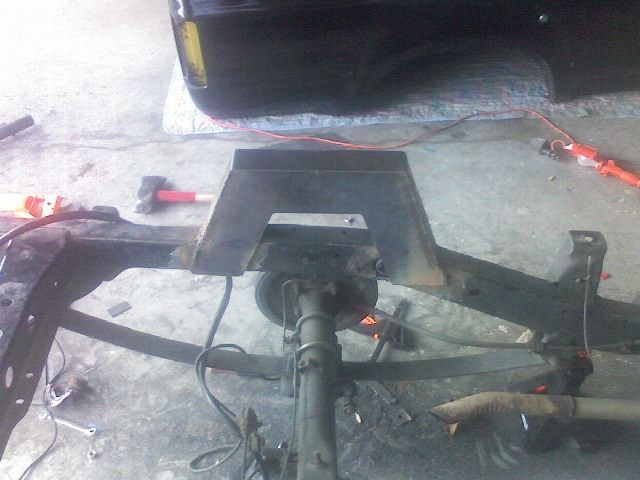

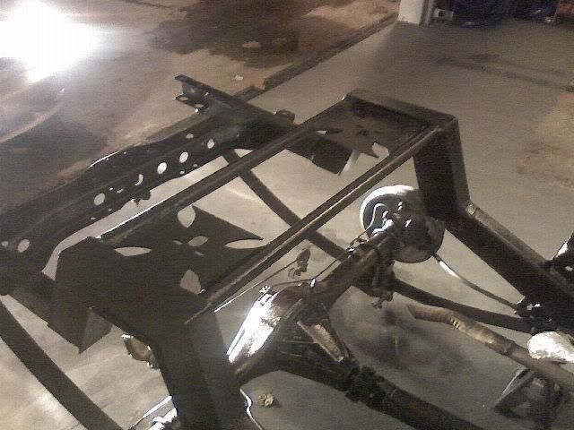

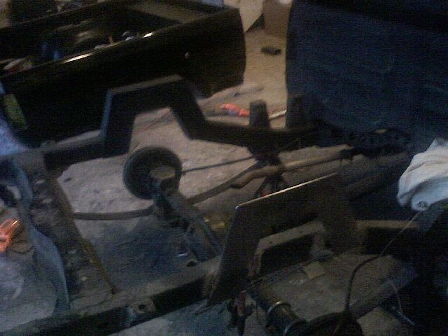

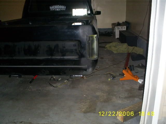

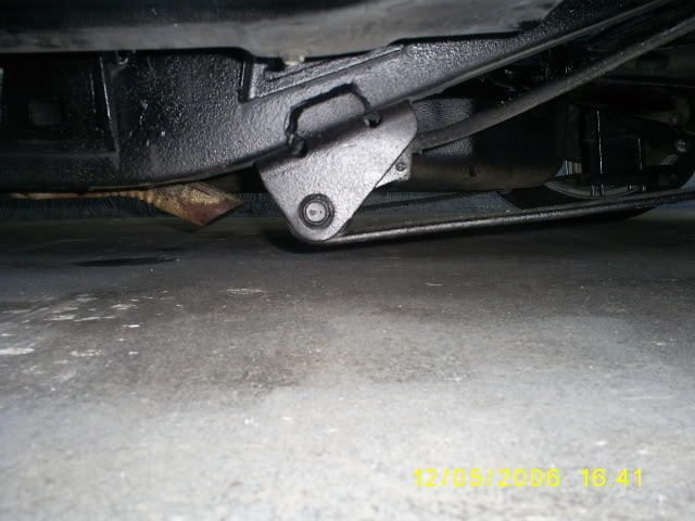

Why did you weld on the inside of the notch?
johnny5's avatar
johnny5
yea you don't have to weld there yet untill you cut the center section out
kdcgrohl's avatar
kdcgrohl
gonna be fun cuttin that out...
ocb_dave_ocb
I did because VEGAS did.. I didnt really think about it until I already did it... im gonna cut it out today and fix it

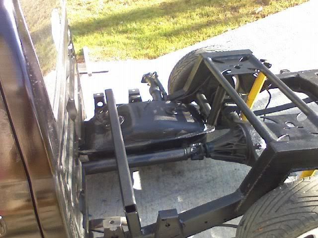

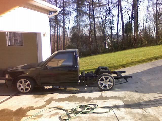

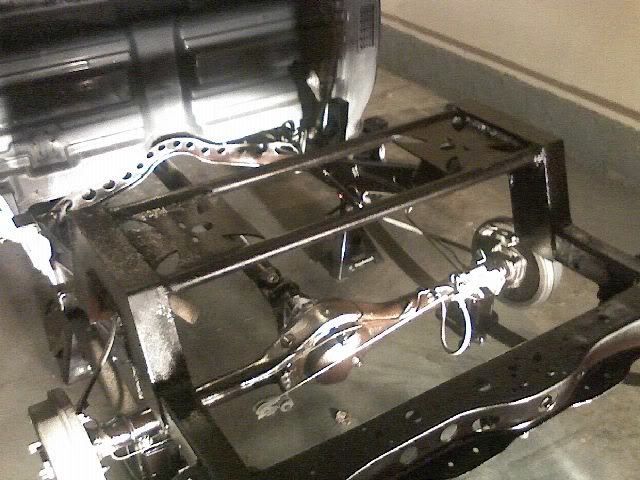

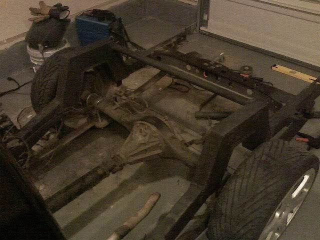

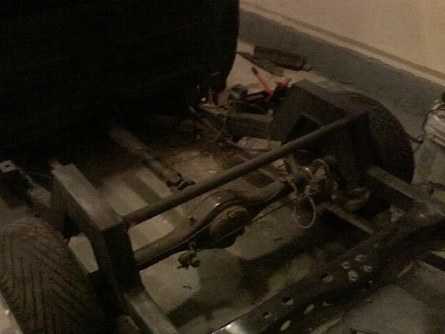

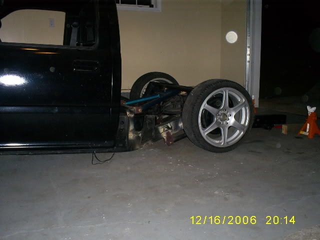

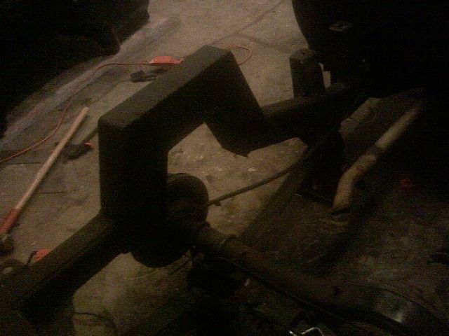

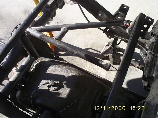

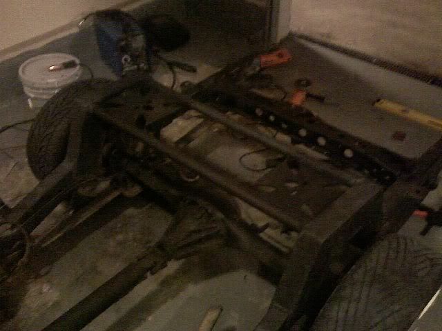

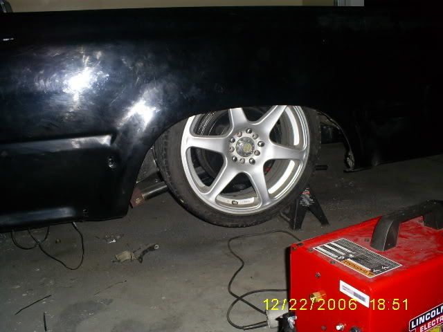

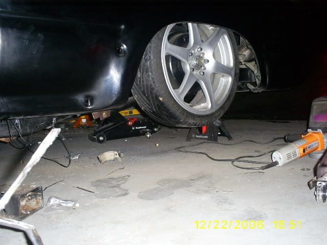

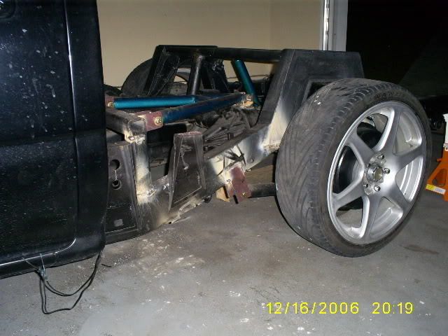

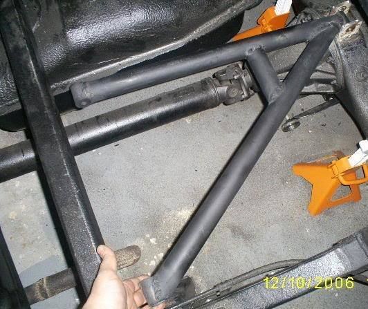

ocb_dave_ocb

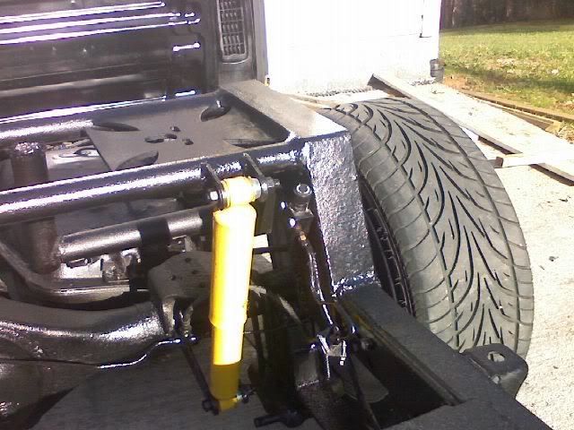

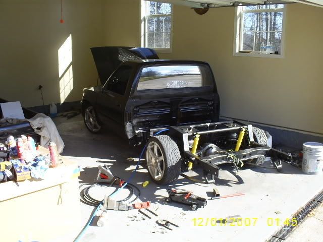

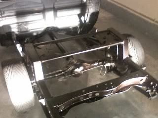

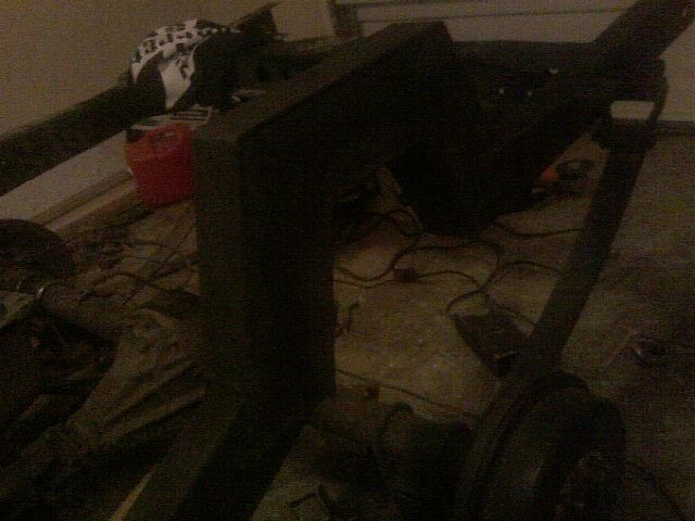

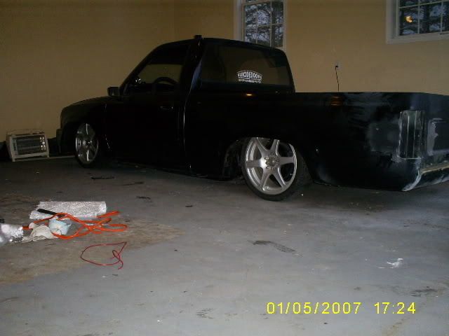

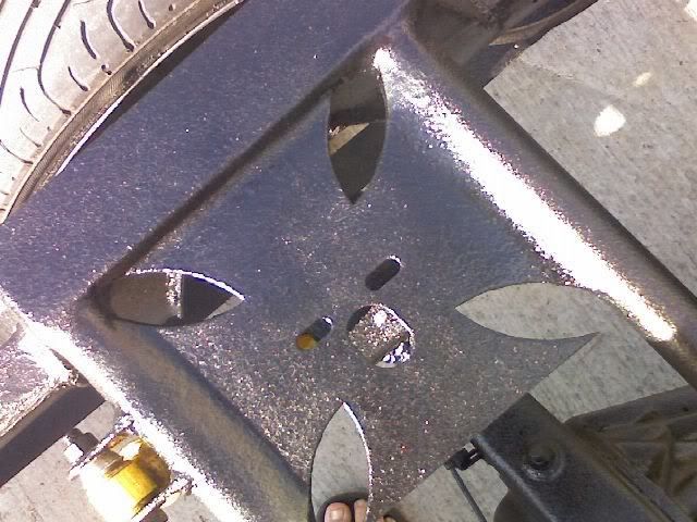

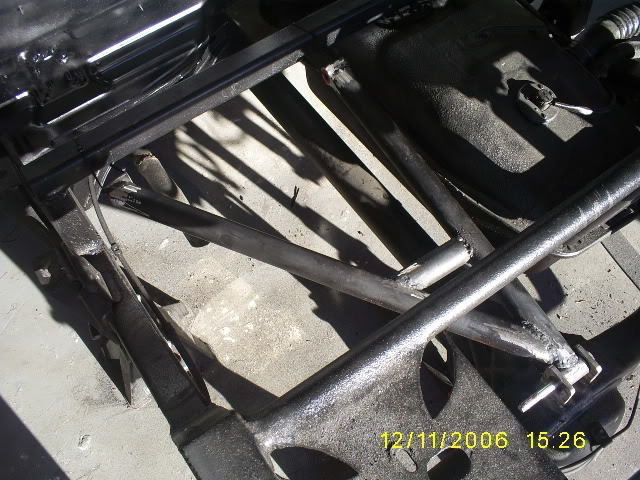

here is another small update... Im getting ready to cut the frame rail out and weld in the bottom piece... Wish me luck....
vegasyota94's avatar
vegasyota94
lol yeah i did that to one side then said wtf am i doing.. lol
just some xtra grinding..
twisted minis
Damn, both you and Vegas are setting up for 24s. Shit, lol.
johnny5's avatar
johnny5
lol did you see my notch seth? i have a 10" notch lol
