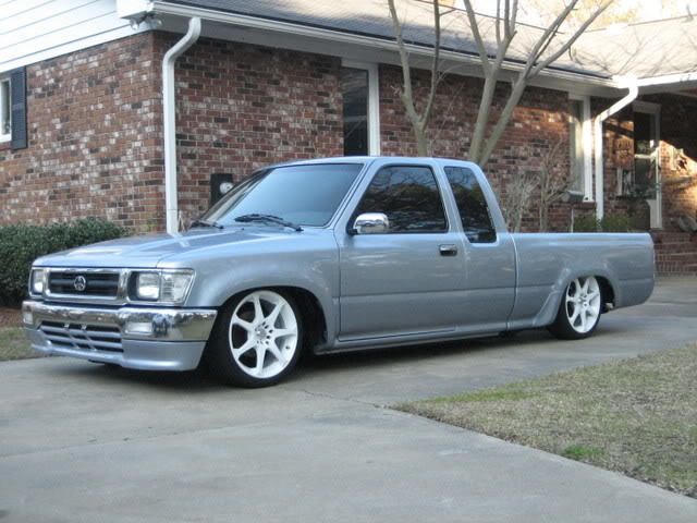

My 91 model...lowered in the front with DJM lower control arms, reset torsion bars & Toxic drop shocks. The rear has raised-front leaf spring hangers, 4-inch angle blocks, mono-leaf, small c-notch & air shocks. Oh & my rims are 17's with 205/40-17 tires.

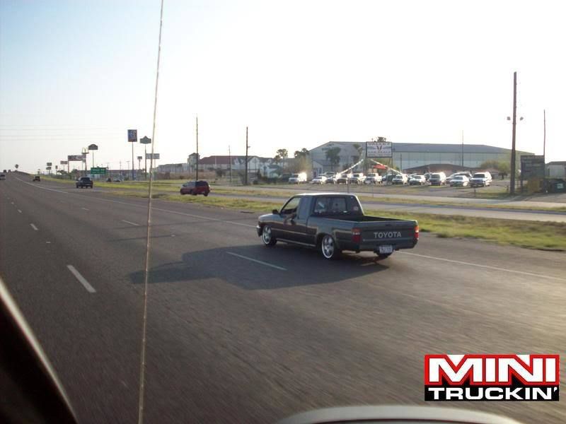

Heres my 93 with cranked down t bars, 4in blocks, middle leaf removed and small c-notch. Im rockin' 17's with the 205/40/17's. (I personally think its too high...)

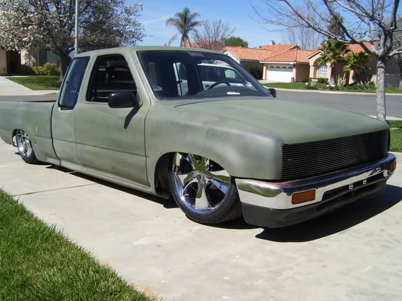

heres mine on 18's and a body drop
