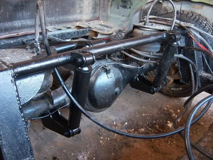

The rear setup a little messy but its comming along

I really like those wheels. Shock mounts leave abit to be desired, but i like the wishbone.
chinkys10
It looks real good with those wheels. What did u do to mount the rear of the bed?
lowboytrucks
there is a section of floor (about 6inches) and i made mounts off that..untill i redo the box witch will be soon..and yes i no the shock mounts suck but they work for right now lol...is there a smaller shock i can usefor that backi am using stock toyota shocks now
kdcgrohl's avatar
kdcgrohl
good lord yes, go to napa and ask to see their passenger vehicle shock absorber book. hundreds of lengths, pick the extended, compressed, stroke and end style you want. just look in the back of the book.
lowboytrucks
oo shit nice i will def do that...the stock jobs are just too long

Monroe has awesome info for their shocks. Click here to download the charts. I use these charts every time.

use a set of shocks off of a 69 beetle. THey are 10.5"colapsed if I remember correctly. Ive got a set on my toyota.
