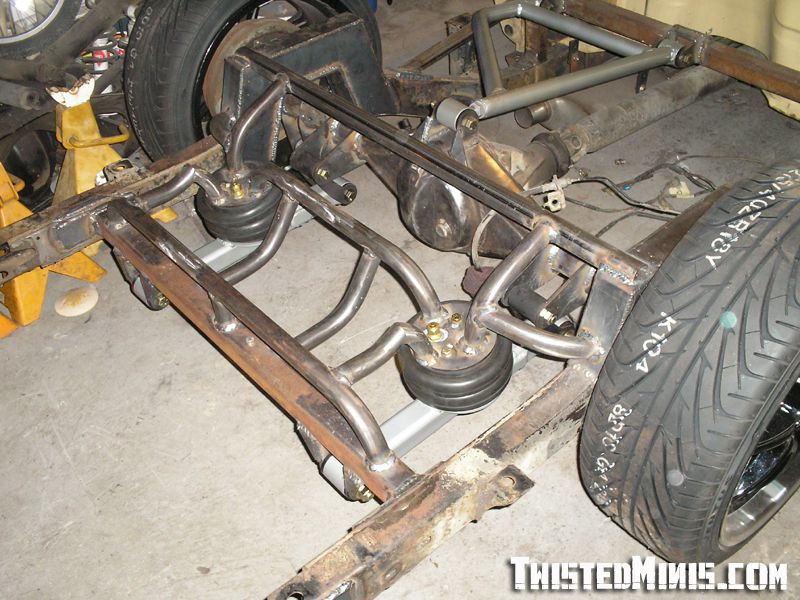

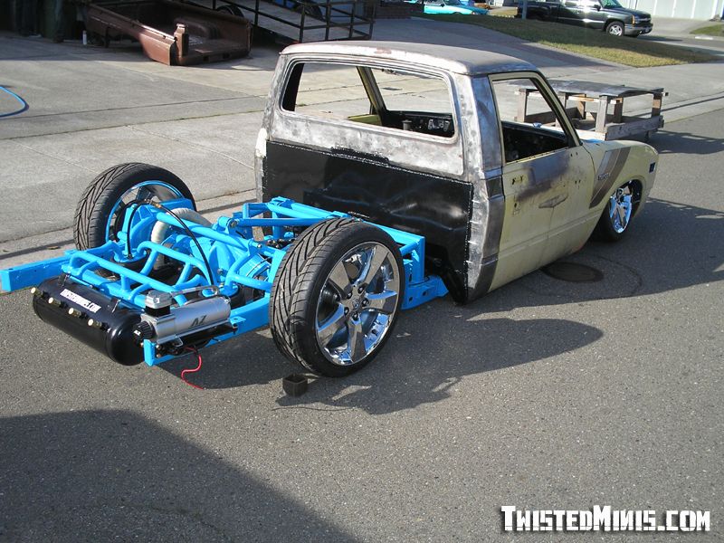

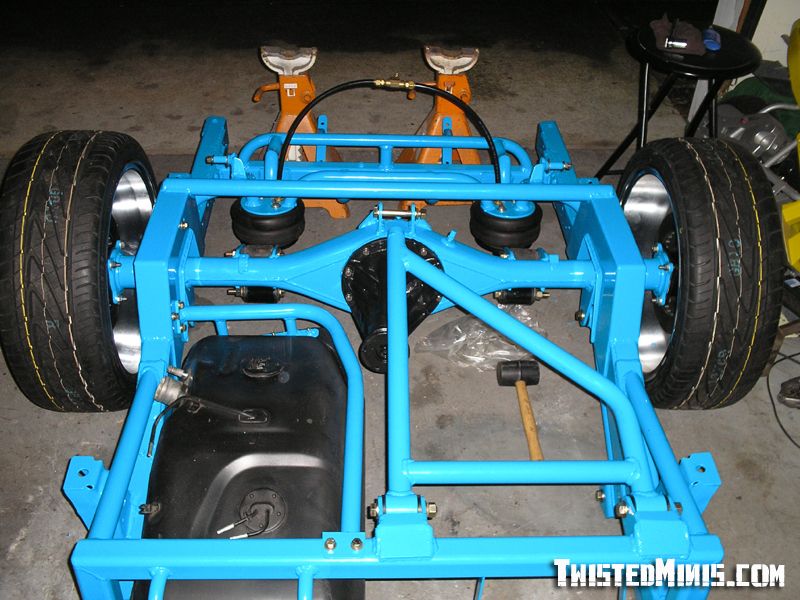

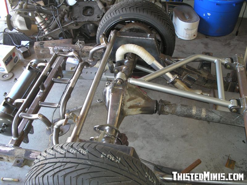

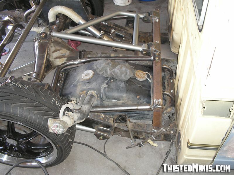

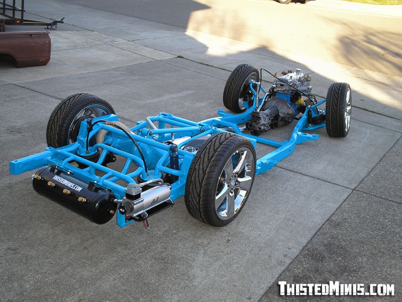

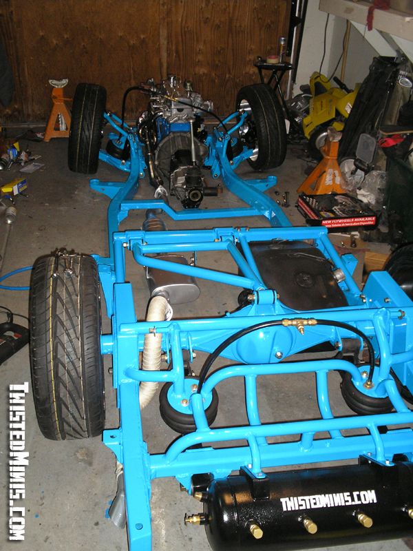

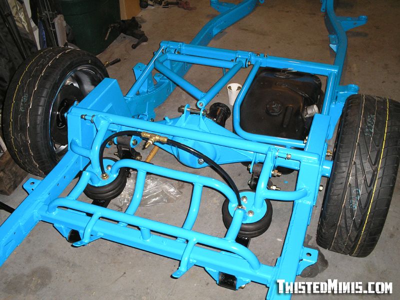

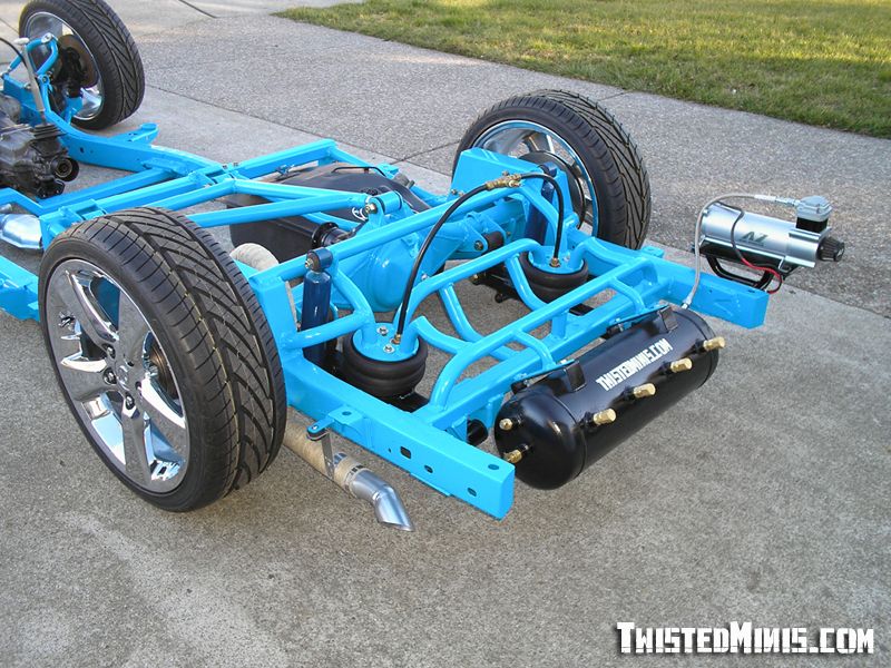

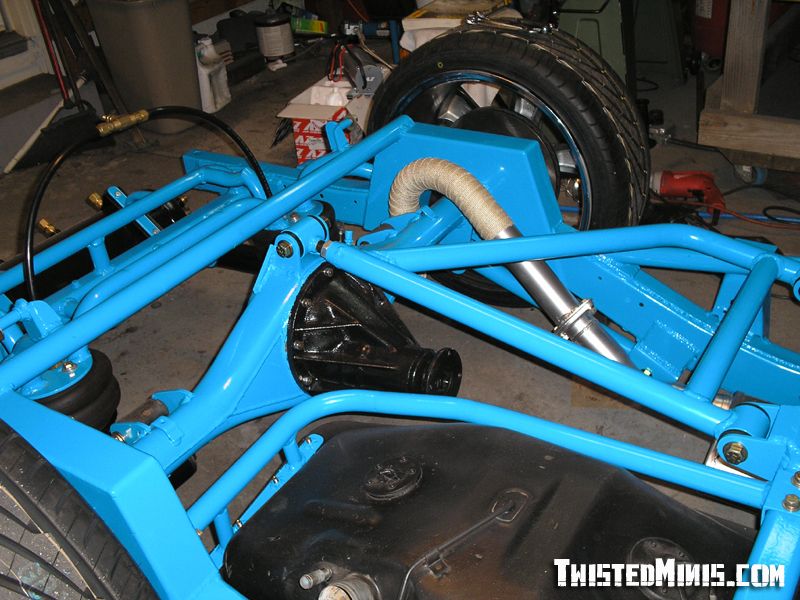

I've got a forward 3-link, gas tank in stock location, and bags on bars.
