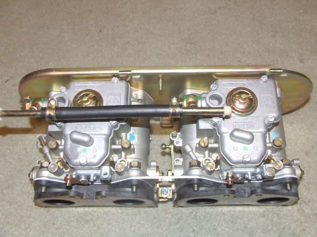

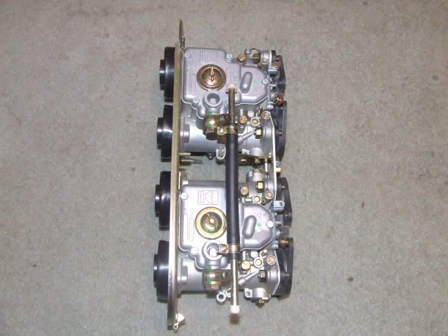

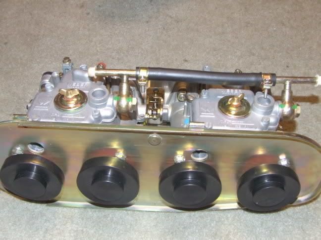

Wahooooo this showed up at my door today......40mm DCOM carbs

Its a cannon manifold I think and the linkage Ill get pics of it up and a tech set up of the install.....also I had to get a regulator cause Weber side drafts only like about 4psi not the 7 or 8 the factory pump puts out.Once I get it all in and good pics then that should tell the tale on how this is done.....I havent seen this done much and I dont think I have ever seen it done up close......btw these carbs came from a guy in NY....I paid 499.00 for both brand spankin new with everything you see....

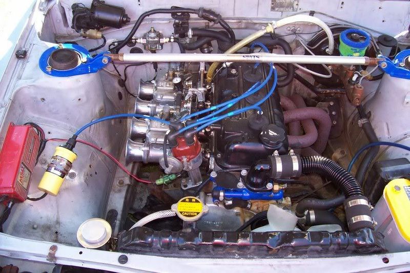

I had my 44s on my Toyota Corolla You can get one of the Facet pump that run about 3-5 psi and you will be fine I ran 2 1/2 psi on my Corolla with my .510 lift and it ran fine
Thanks on the manuels I have a Mikuni one here and Webers are way easier than Mikunis
Here is a pic of my Corolla
This is how it was before the massive rebuild going on now 45mm ITB's and a 5mm over block

Hey how did that work for ya running open cans??
3tcrob
It ran real good I have a ITG filter kit for them but you have to richen it up a couiple of points plus it slicenles them a little if you never had anything with sidedrafts you will never go back once you hear them suckins air you will be in love
I over reved this motr and flatened out the rod jornel on the rod but the bolts were still intact(ARP) and there was no sand or grit in the motor at all
I'm running a open carb now on my truck

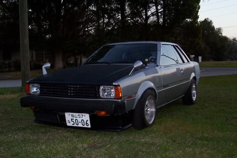

phatboislim
that corolla is tight shit..you sold it didnt u
