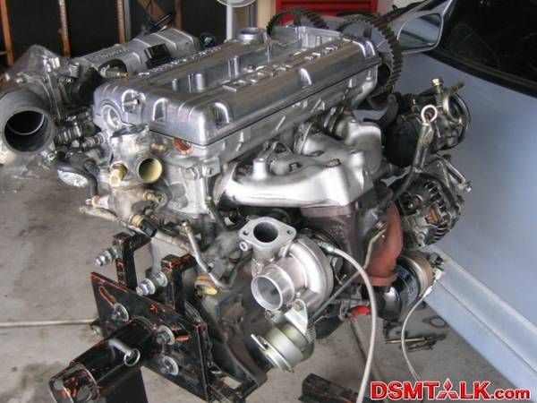

Hate to bust your bubble but this is NOT true. Every eclipse and talon and laser equipped with the 4G63T from the factory have an oil feed line directly from the oil filter housing. Go to any DSM site or go look at one. I have owned 3 of them. And had 4 different year turbo motors, they all use the the same port.
The head spot works, yes, but it is not factory. You should research before trying to call someone out.
Perfect example. You can see the braided line going to the turbo top and comming from the oil filter housing.

lol, I too have owned DSM's and have a 4g63T right now waiting to go BACK in to my truck. Maybe the 7-bolt second gens come like that but I can tell you for sure that the 6bolt motors come stock with it off the back of the head. And it is not a braided oil line stock, it is a pos thin metal line, I know I had to replace it with braided line and hose ends when I had to flip my turbo 180* for my swap . I wasn't trying to call you out either, just stating, but if you dont believe me go search on DSMtuners.com for the answer
EDIT: BTW, I can tell from that picture that's not an oem turbo feed line. Most people go to the oil filter housing because they feel you'll get the best possible oil pressure there and that the oil is "cleaner" coming from there instead of the stock location of the back of the head where oil has already been passed around to the valve train.

No your right, I appologize. All mine I remember comming from the housing, I did have a 6 bolt, but maybe never messed with that line on that one. So anyway, 6 bolts are from the head and 7 bolt 2G's are from the housing. But it IS recommended to use the oil filter housing location.
That pic was just the first one I saw, the line isnt stock no. But the location is what I was going for.
