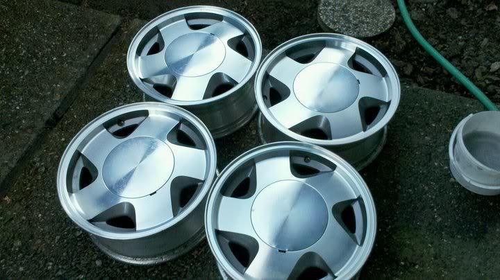

Got these wheels from a yukon. Supposedly they are 16x7. My eyes may decieve me but when test fitting them on the truck 2 problems arose.
1: Obviously the center bore needs to be widened. I heard of this going into them, but these wheels are flat for the lug nuts, mine are acorned to center the wheel.
2: The spacing looks to be way to tight. They are not flush on the hub yet and they almost touch the front upper ball joint.
Spacers > bore ?
What are you guys running with your GM 6 lug wheels?

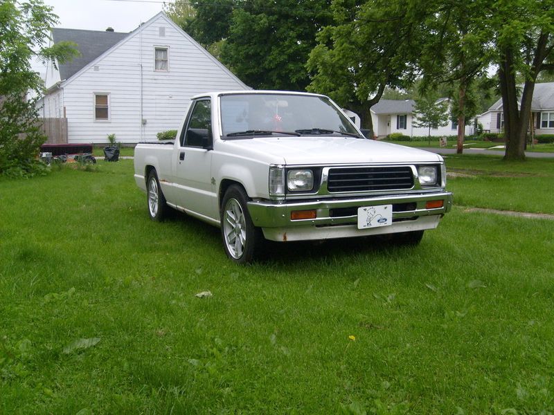

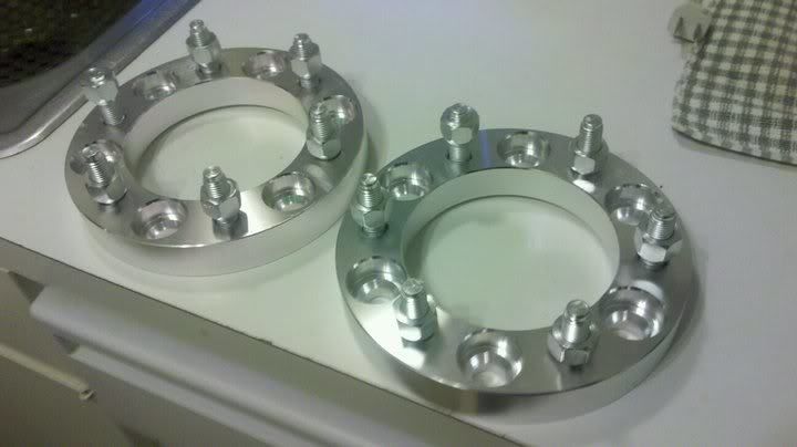

i am on 25mm spacers and ive had no problem with mine,, n my stance looks pretty cool

i also had to get diff lugs as well
