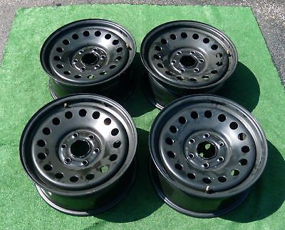

will the GMc steel wheels fit the mighty max . I have a set but the center hub center is smaller. lug pattern is 6x139.7.
wil they work ? not trying to run spacers .
" target="_blank
rxinhed
The GM wheels are hub centric when used on a GM. Cut out the centers and go for it, same bolt pattern.
