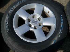

Will the titan 18's fit on our MM's without any need to bore out the center of the rim? Thanks in advance.
droppedmitsu's avatar
droppedmitsu
Yes you will need to router the center bore or turn down the centering tabs/rings on your brake hubs

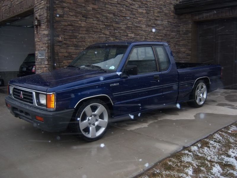

What about the fact of not having an acorn style nut for the wheels to fit flush? If you over boar the center out, has anyone had problems with them?
kpg2713
I ran those same wheels before. I just brought them to a machine shop and had them bore out the hub to match the mighty max, which he did for $40, and they worked flawlessy.
Here she is
