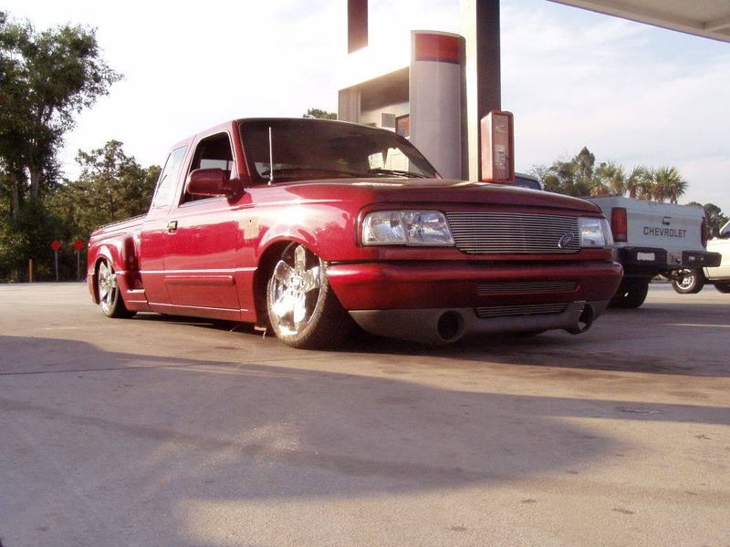

if you like the ranger front end then i would just update the lights with some diamond cut headlights and corners and use an all chrome grill. i had that setup before i went with the explorer and it looked really good.

xxxxcjxxxx
my splash with diamond clear healdights n corners n 3 billet grilles

that looks really good CJ. nice and clean bro.
