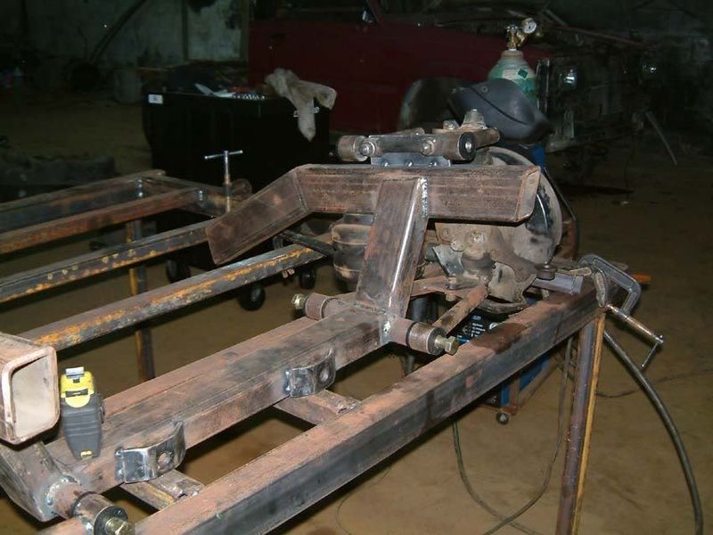

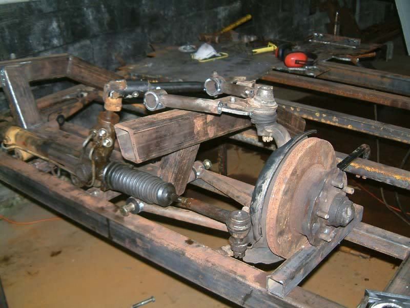

heres the latest progress on my front suspension.

is that an sdime suspension?

naw, that's the new Cris Collins front frame clip with some Cris Collins control arms

Correct me if I'm wrong, but I don't know about the control arms. The angle and width of the mount doesn't look wide enough to me. I mean, I know they are very short (which helps with the strength of them), but they don't seem right to me.

yea there the poo. yea there wide enuf. it doesnt have to be like a GM control arm and have a millino feet between the moutning point.

yeah its definitely not an s10 suspension. the only things on my front clip that are factory anything are the toyota spindles and the aerostar rack and pinion. everything else was designed and built from the ground up.

cris is a pimp..and a badarss builder...front setup looks flawless and they are most definitely wide enuf
