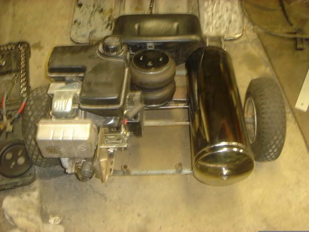

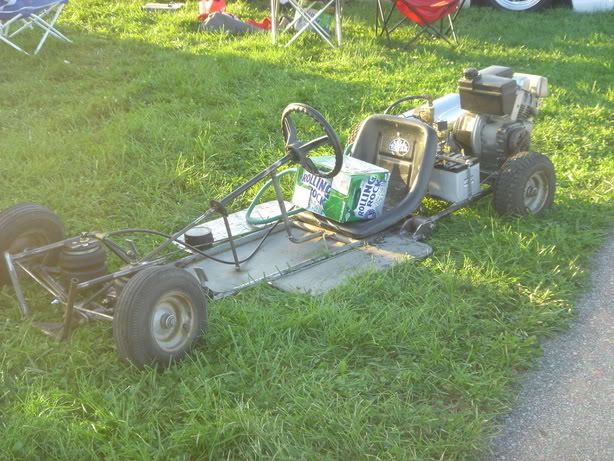

Here is my cart....I'll give a quick profile first:
Hand built control arms with airlift 2b6 bags. Rear is 2 linked with one bag in the center. Chrome 5 gallon air tank, all 1/2" up and 3/8" dump SMC valves, small airlift compressor. 2 motorcycle batteries, Custom rolling rock 12 pack switch box. 5hp tecu.....something or other motor.

Thats the basic set up. The compressor goes inbetween the motor and the tank
Front up ass down

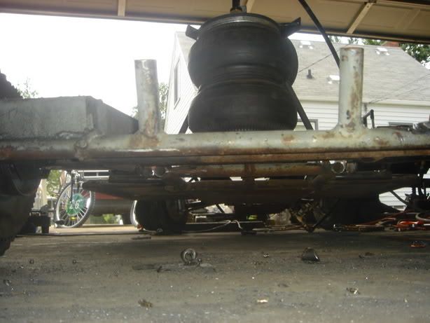

Rear set up

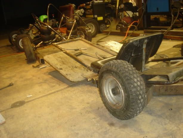

front view - during construction
