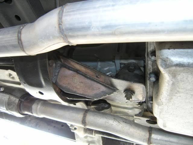

Here's the one I made for my 700R4.

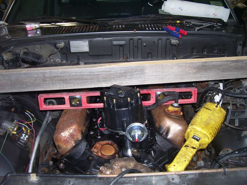

Here is an idea of my clearance issues, this was using a HEI style distributor that is taller than the stock style. It was a no-go, I got a different one that is more stock style in size and everything fits ok. But I did have to go with a drop-base air cleaner and 2 inch element for my carburetor, to avoid hood interference. I do not think I would be able to run an EFI manifold unless I removed the spacers and let the engine sit down further. But like I said before, if I had gone with 1/2 inch spacers I think I would have had the clearance without all the hassle. And now that I have the transmission and everything in place, I see about 3/4 inch clearance between my oil pan and the crossmember, its not nearly as tight as it appeared to be when I was first trying to muscle the engine into place.
bigphil76
That's a great picture for reference. I see what your saying... I don't think there will be any way around me modifying the engine cross member now. Shouldn't be too Bad of a job I just don't want it to look cobbled.

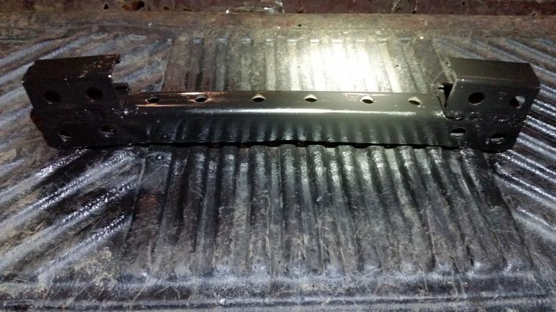

Tried to post pictures from my Samsung phone but can't quite figure it out...pulled engine and trans tonight with a buddy about 4 hrs without cutting any wires or breaking any sensors. Everything was pretty simple. The engine crossmember is already bolt in which I didnt know. So it will be alot more simple building brackets for it to drop down.
