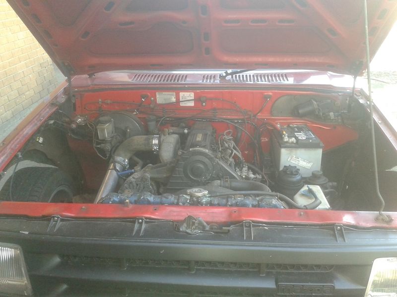

when I picked it up it had already had inner front arches removed for clearance but they had left the battery tray held in with 1 bolt and bending the bracket so battery was fouling the wheel along with light wiring and engine wiring every were close to tyres and suspension so I set about relocating battery up on to bulk head and redoing the loom

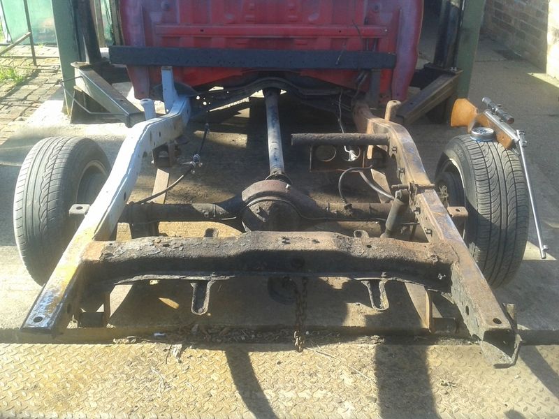

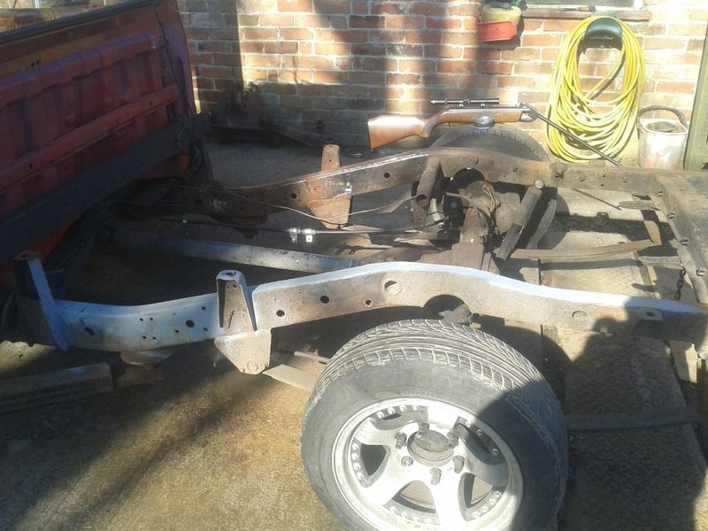

so I converted it back to 6x139 from 5x114 and I had been using the truck daily and its got a few bits I wanted to sort so I had been planning a few ideas for long term but after a boot full out of a junction I snapped a rear spring doing a fair bit of damage dented fuel tank killed prop bearing handbrake cables and flexi brake pipe so I stuck it on the ramp to get stuck in I started with replacing damaged parts but then changed my mind and decided id go all out and do all my suspension mods now

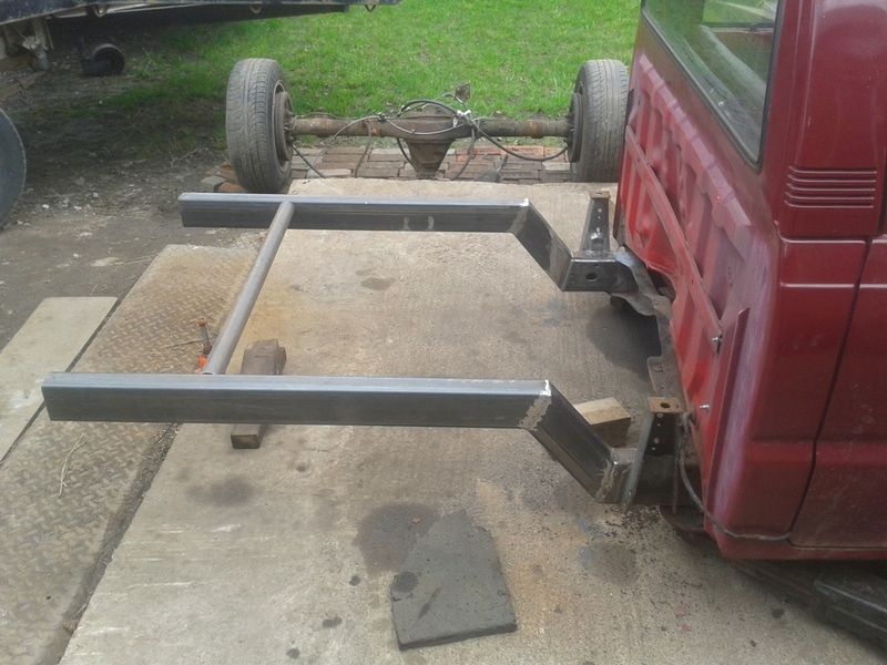

so I have removed the rear half of chassis from just behind the forward bed mount
and iv done a 12 inch crank in the rails and I plan on ending the rail in front of the axle
and im aiming for running a 1 link set up with upper sliding A frame with 3-1 cantilever airbag setup and from a few mesioerments im aiming for 32 inch of lift as im hoping to make this truck 3 wheel
