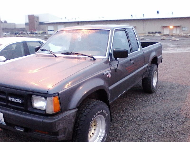

So this 89' 2600i g6 has really given me a run for my money.
overheating
coolant blow off inside cab, white clouds
new head new valves new gaskets
over heating
napa heater core doesn't fit, off angle 2 degrees
thinking of going electric element and totally bypass heater core
any ideas
