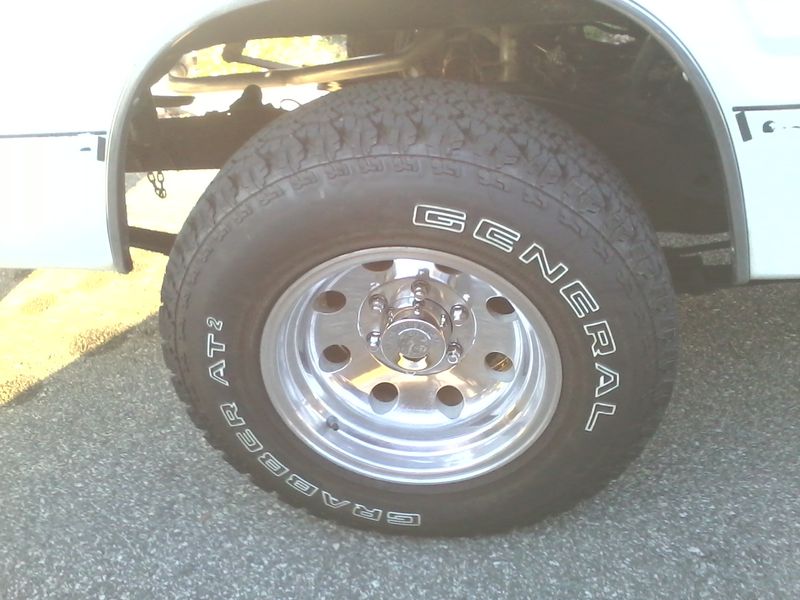

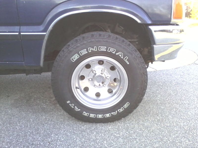

Me, I'm running a set of 15x7 American Eagle Pacer wheels with 265s in the rear and 235s in the front (what I had layin around.) The front is lifted with indexed and cranked torsion bars, 95% turned in, currently with stock shocks but will get replacements 3" taller. Rear has lift shackles and a helper leaf spring added to the pack.

Awesome thank you.What do you mean by indexed?
E
emjay
Take the torsion bar out, and rotate it by 3 teeth. clockwise for driver side and counter clockwise for passenger. Works the same for lowering but do the opposite. It allows for more lift but increases the tension on the bars and bolt.
To alieve some of the extra tension I will be making spacers for the ball joints. Solid aluminum 1.5" thick secured with grade 10.9 bolts (metric thread after all.)
