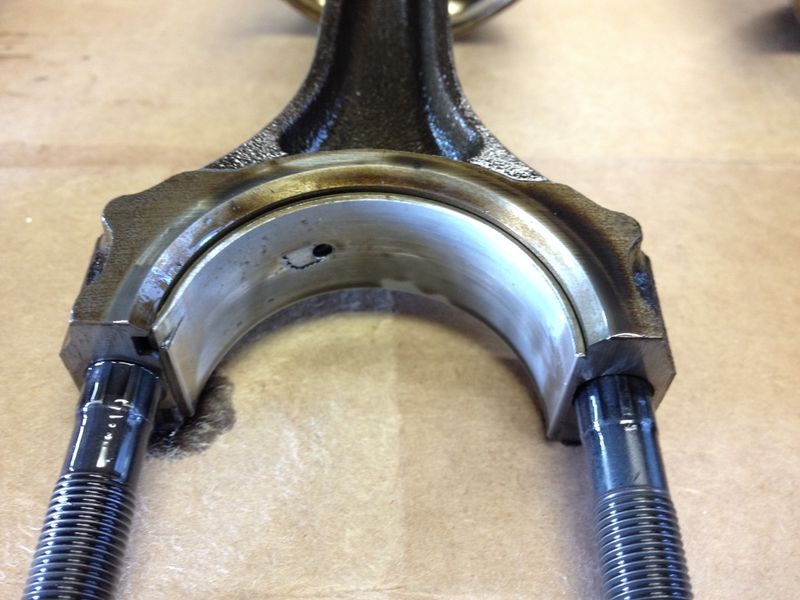

And then I pulled the first piston and saw this lovely bearing.
I didn't photograph the crank journal, it wasn't missing any chunks, just had some of those faint lines going around (is that scoring? I'm feeling stupid today) and looked fairly like any other picture of a disassembled engine I've seen. But, this is definitely in the area of "Don't really know what I'm doing" and the bearing on that rod don't look great.
I haven't pulled any of the other pistons, I was already not in the mood to wrench, so I just set the oil pan back on and put everything down before I got irritated.
I'm wondering, is this likely an indication that the crank will need some work, and that I shouldn't simply slap new bearings in and wait for my engine to explode in week? I originally didn't want to really foul with the mains, I just wanted to stick on the new rod bearings, hone the cylinders and drop in my new pistons and rings.

I was tossing back an forth non-stock engine swap or rebuild for a long time. But just went with the rebuild. Some of my Bearings had the same pitting. I replaced all the bearings, new rings, new water pump, new oil pump, new timing belt/ tensioner. I had a machine shop rebuild my head, clean and hone my block and the ordered a reground crankshaft. I did the disassemble and re-assemble and spent around $800 or so. Mine smoked before but not after the rebuild. I did end up replacing the carb, EGR and a bunch of vacuum lines. Then I passed the smog test!
There are a handful of guys on this forum that have rebuilt there engines a few have some write ups. I wouldn't give up, keep at it!

Went out to the garage again today, decided to pull the rest of the pistons, just to see what THOSE bearings look like.
And the answer is, more of the same.

Look at my engine rebuild thread, in the signature part at the end of this post, has photos. My B2200 had 183K on it then, and my bearings and crankshaft journals were absolutely pristine. So I just added new standard size connecting rod bearings to go with new pistons and new rings, and had the head re-done. That is just shy of 3 years ago, now 201K on it.
