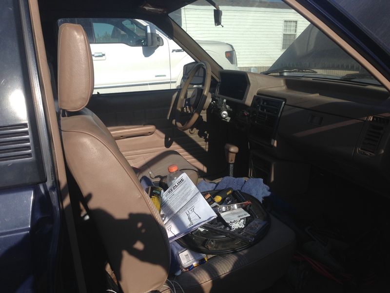

muth_33

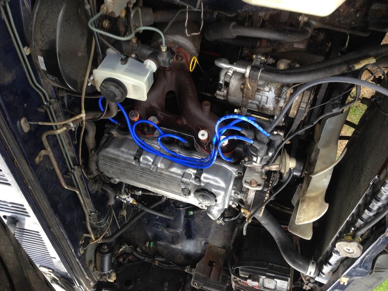

interior, overall pretty good shape. I need a new column cover. I also installed a new blinker/wiper switch. Super easy to do!

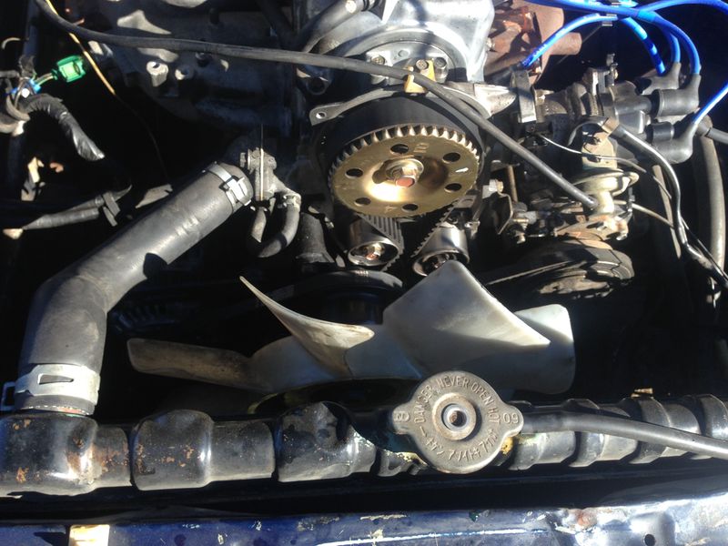

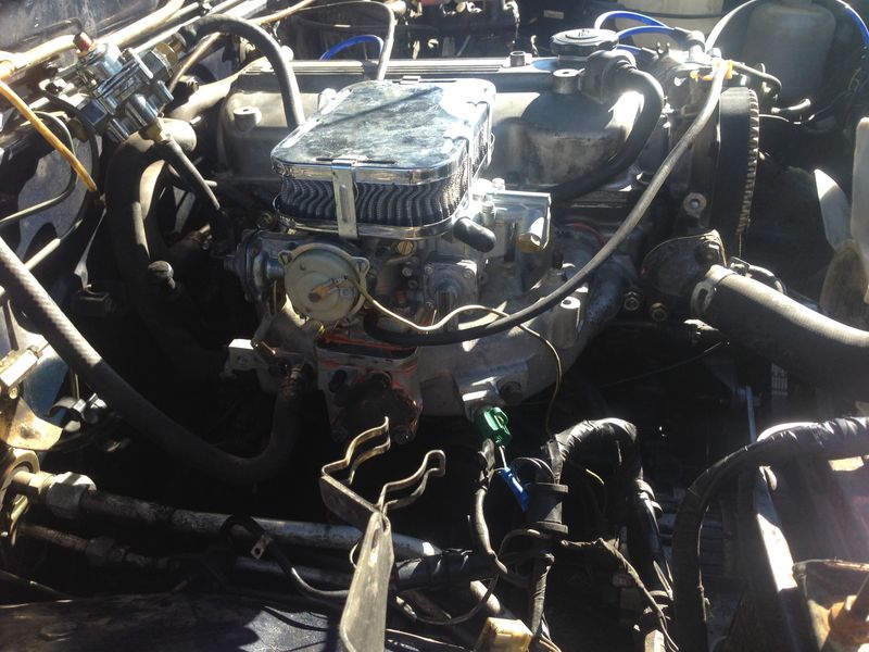

muth_33

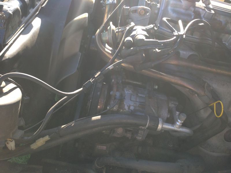

engine bay, after original weber install. I still need to clean up all the excess, unused vacuum lines

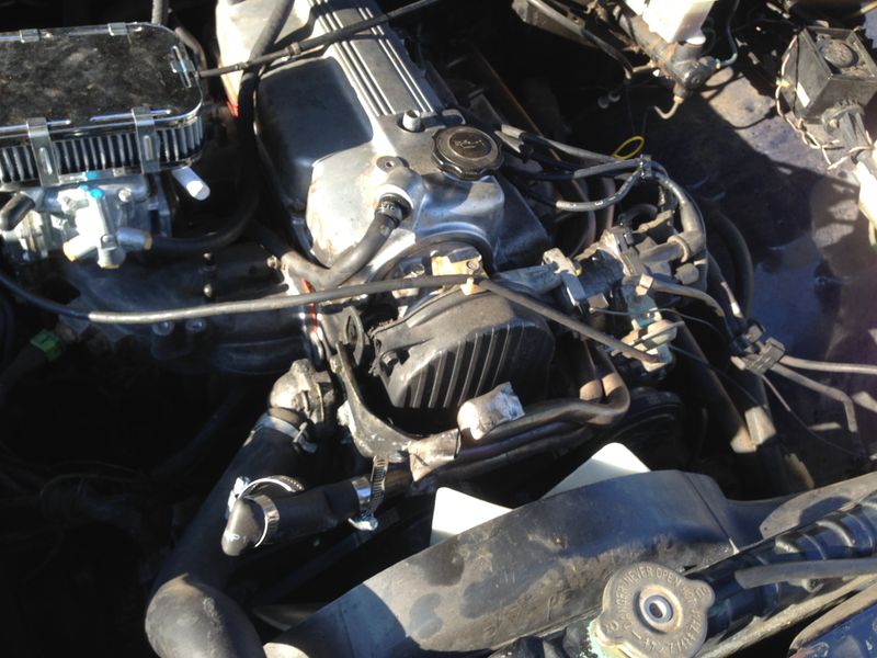

engine bay again. just a reference photo for myself.

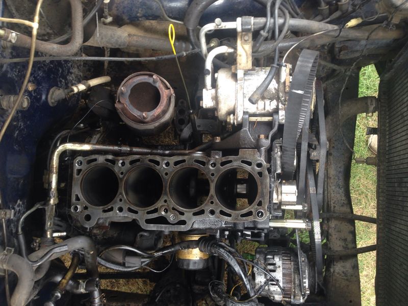

muth_33

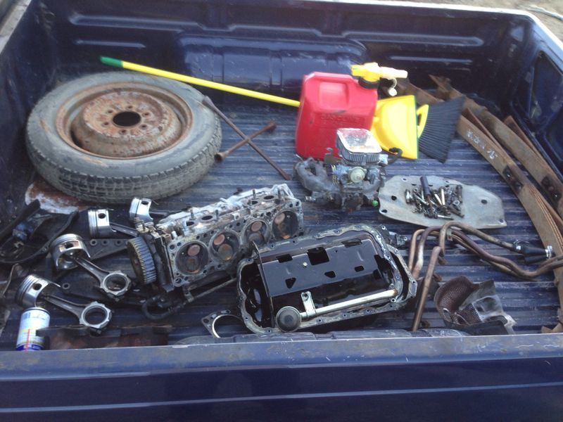

motor after pulling the head
muth_33

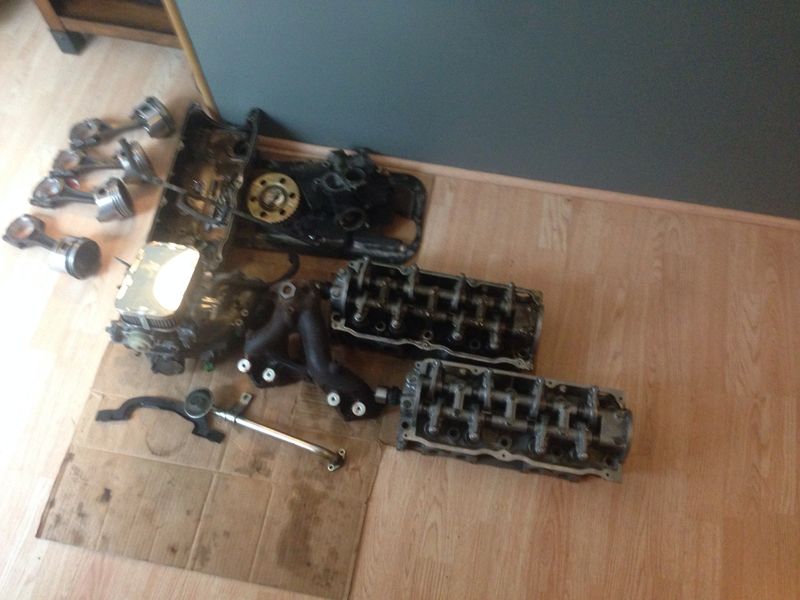

the old head

Rebuilding this engine isn't too hard. Just take your time.
You probably could have taken that head to a machine shop to be rebuilt for less than buying a replacement. That's what I did with mine.
muth_33
It really doesn't seem to bad, after watching a bunch of you tube videos and reading a bunch of tech posts on this sight. I was thinking about having the head machined but I saw someone say they spent $200ish to have it done. The refurbished head was only $300 plus the valves are adjusted and everything is clean, so I can have a fresh start. I probably didn't need to order new pistons and rings either, but again, the idea of a fresh start is what sold me. Plus they were fairly cheep.

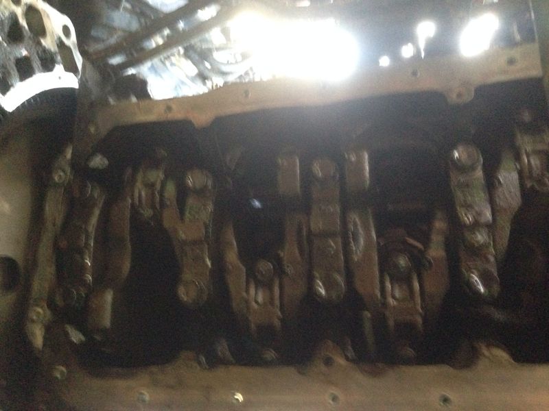

muth_33
Day two of trying to pull the oil pan was another failed attempt. Borrowed an electric impact to get the cross member out of the way, got 3 bolts out, couldn't get the fourth. I need a good, long cheater bar to get it I guess. All the pan bolts are out, tried hammering and prying, but with zero success. Any ideas and tips would help. I am starting to get a bit frustrated!
