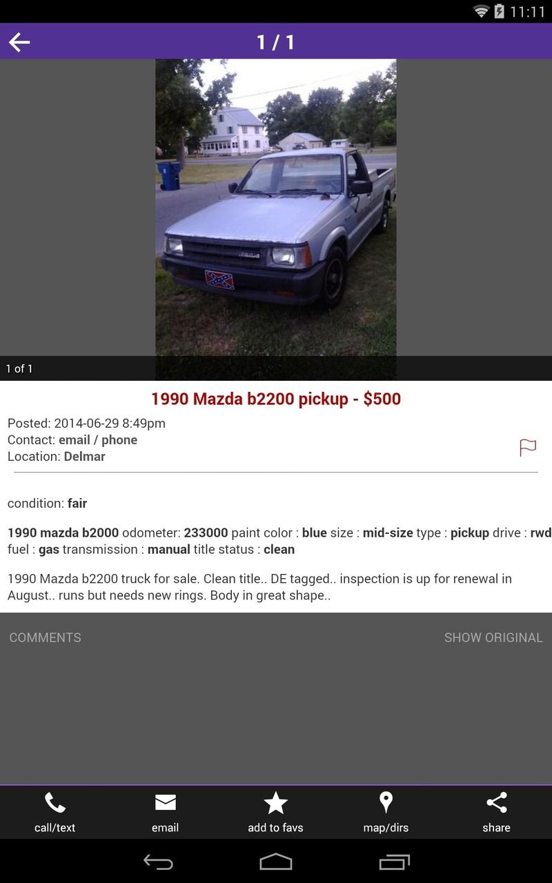

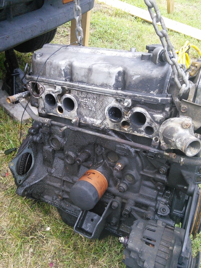

So here's where it's all started. Picked er up for $500 off craigslist. My intension is to have a clean dependable daily driver to keep the miles off my k2500 and put some gas money back in my pocket.
matt1094
So then the obvious next step...

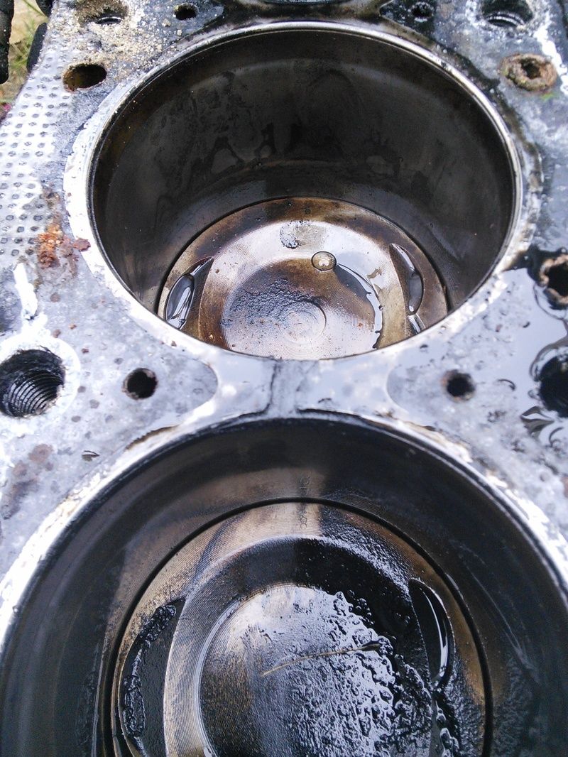

Just to find that not only does it need rings but cylinders 3 and 4 have scoring/pitting
and 2-3 blown head gasket.

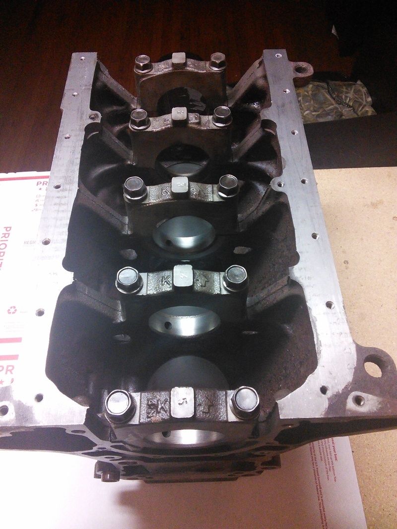

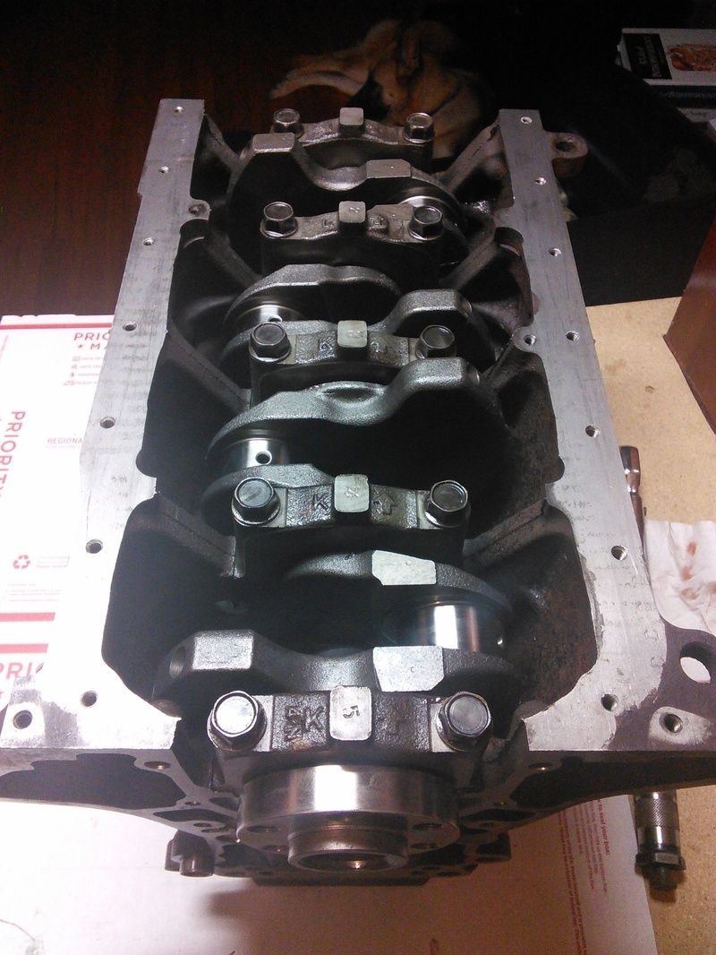

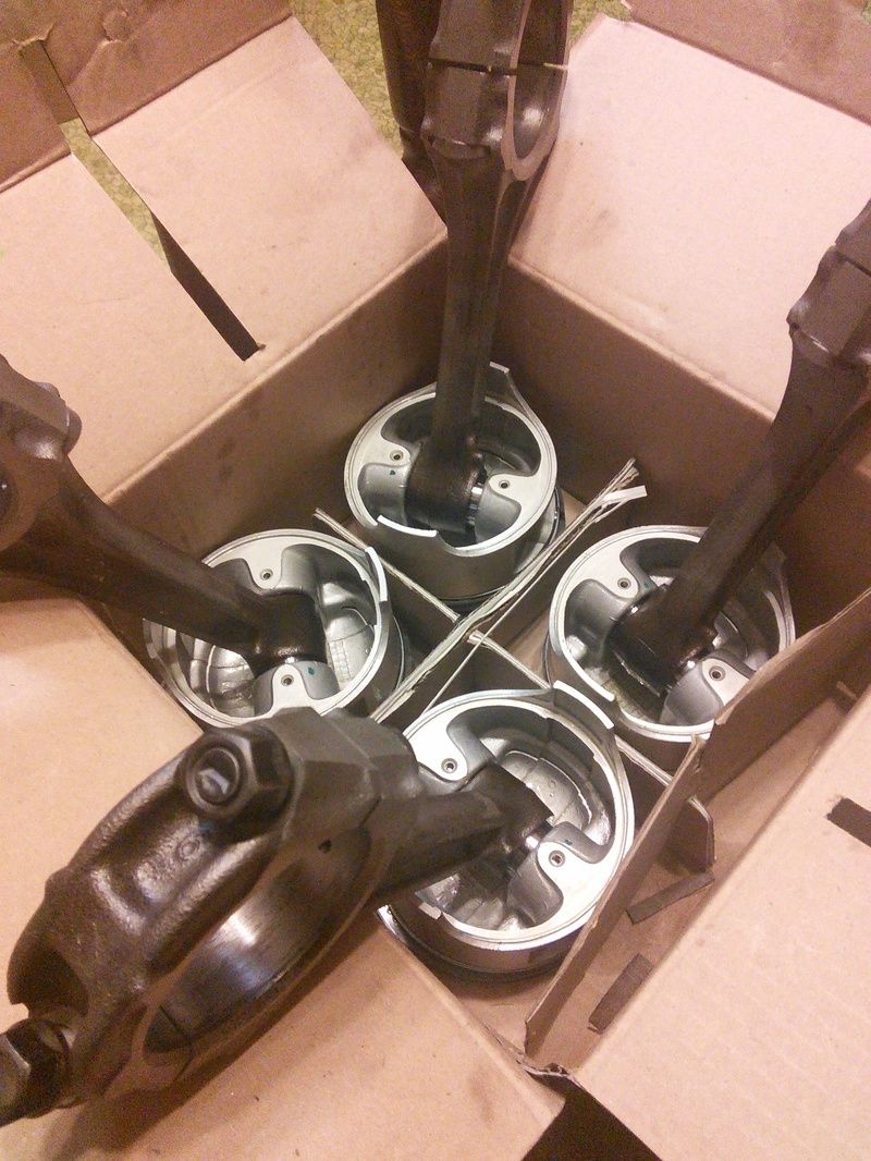

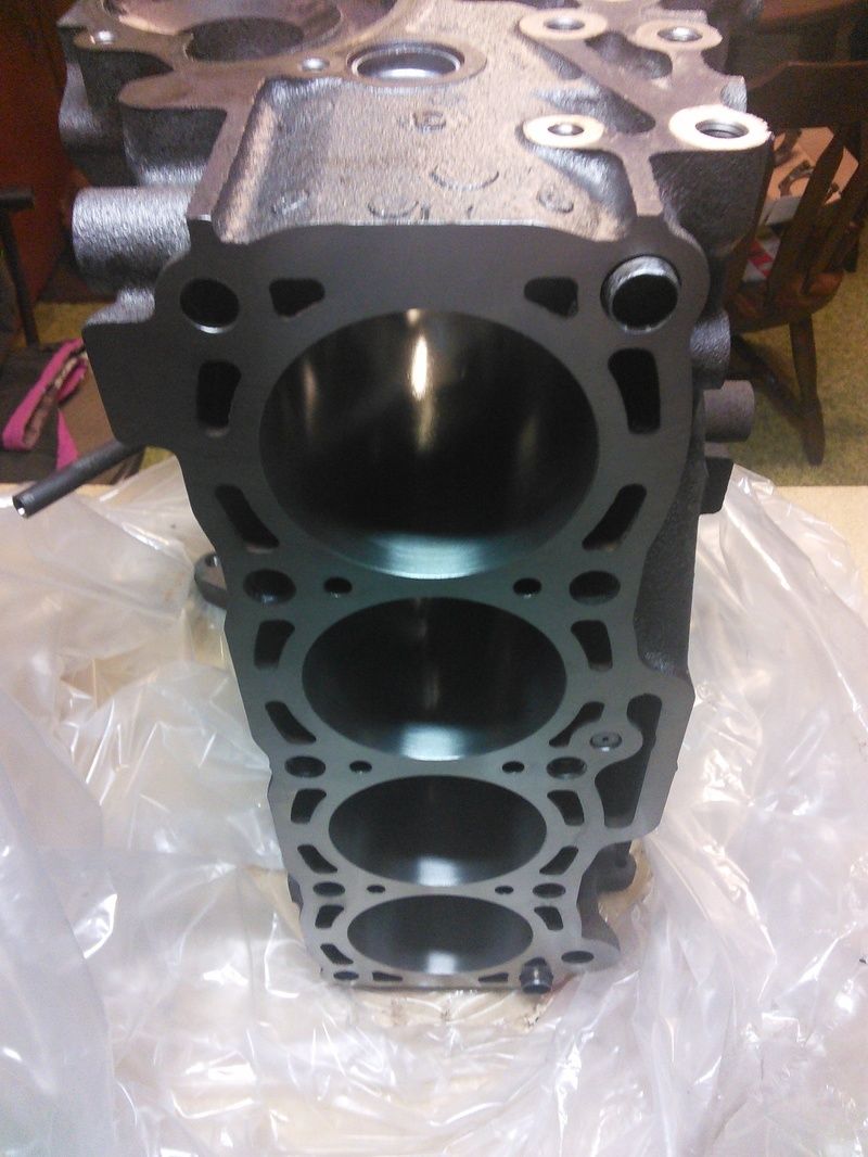

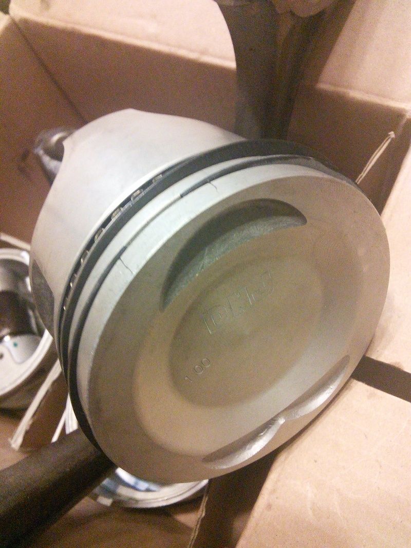

Tonight I'm tearing the short block down. Going to mic the crank and based on how that measures I'm going to punch this block .040 and do a complete rebuild or I'm going to start looking for a donor short block at the minimum.

Head and flywheel is already at the machine shop. Head getting checked/decked. Flywheel resurfaced. I'll post status pics of the short block tonight along with some interior stuff I've been working on.

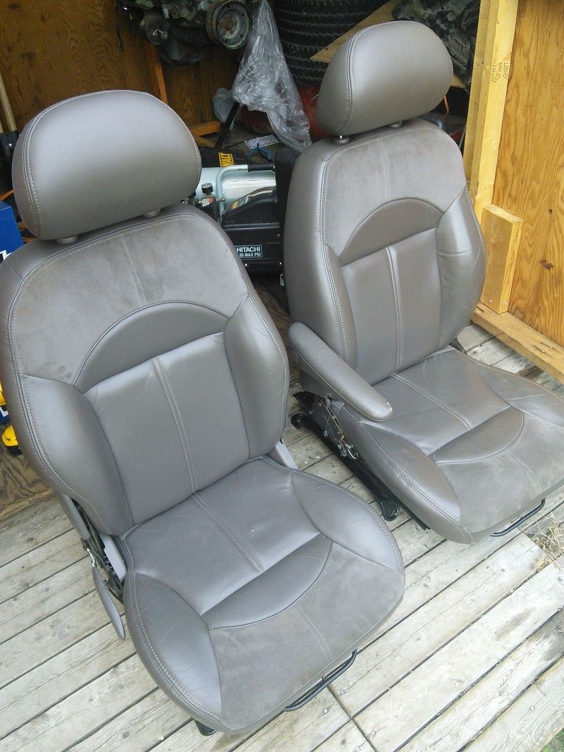

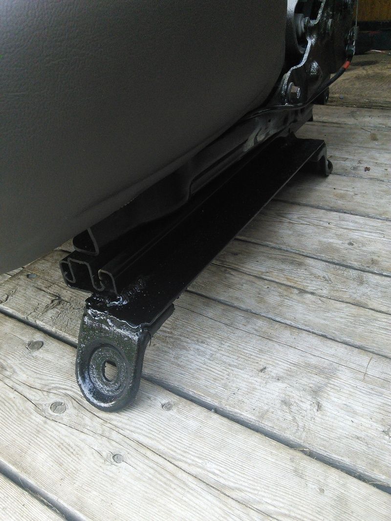

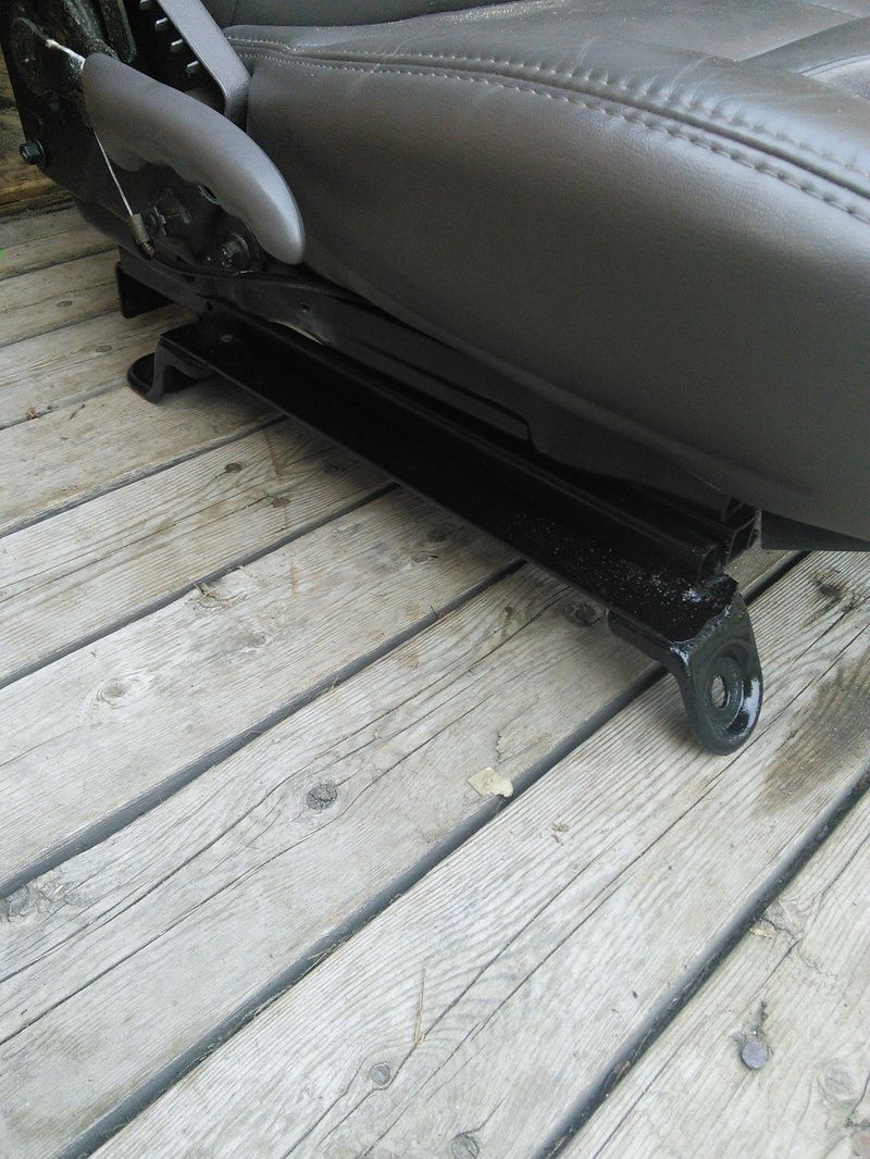

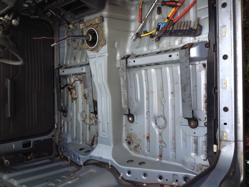

Alright so I didn't get into the motor until after dark so there's no pics yet. But I did get these seats. They're out of an 02 PT loser. Worked out really nice using two sets of bench seat brackets in the factory mounting holes with pieces of 1/8" x2" flat stock welded to the feet after I removed them from the original tracks.
Here's it mocked up in the truck
And then I just centered up the pt cruiser tracks up on the brackets I made and welded the seats down. The plastic that goes back on the pt seats will cover the tracks and brackets.
