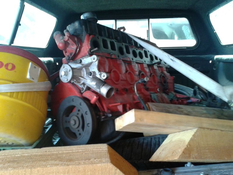

Well, 1 year and 10k miles have past since I bought my truck. Its my first vehicle and I want to keep it forever. But, like all of us agree, 86 horses sucks. Today I scored a 258 Jeep for $150! Only 30k on the rebuilt bottom end, a bigger cam and gm hei distributor, supposedly makes around 200 horsepower, and a shit ton of torque. The head needs a valve job, and I an going to do a little port matching and polishing. Its quite the odd choice, but it was cheap and different. Plans are ax15 5 speed, and a Toyota rear axle with lsd. Its going to be a while before the build actually starts, as I need to sell my Suburban to get the cash to do the project. I wanted to post this to get feedback, tips, and just see what everyone thinks.

Will you have room is my question. I wanna see this done though. I don't think anyone has yet lol. You will have one torqued out mazda though. Tow anything you need..

thats gonna be crazy tight under that little hood, my 5cyl diesel swap i had to put the rad 4" further forward and the stock trans (that went together without extra space for an adapter) 4" further back.

Engine length inc. Pulleys is 29 inches, length from firewall to core support is 30 inches. Ill put the rad in front of the core support and if I have to, bring out the bfh and go to town on the firewall. I already bought the motor, its going to fit.
