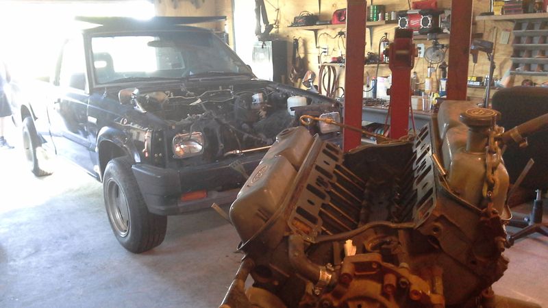

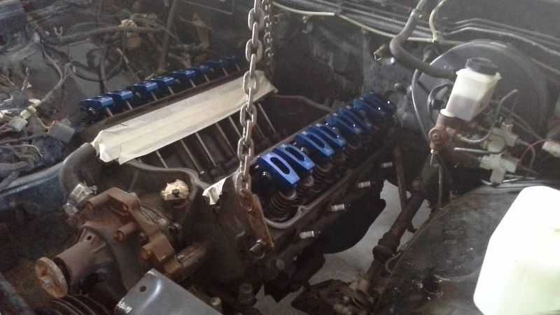

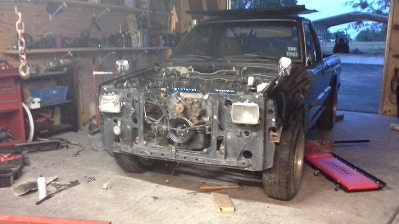

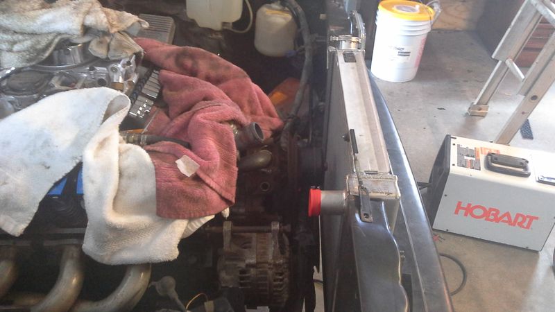

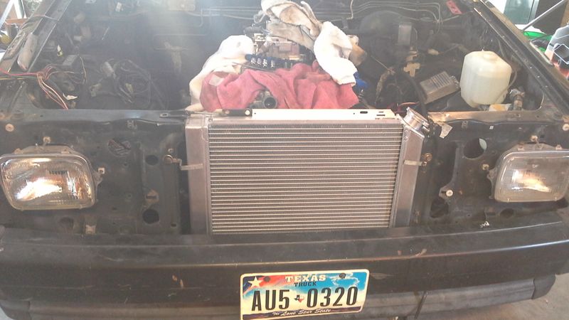

manicmazda
here just some pics a took last sunday
