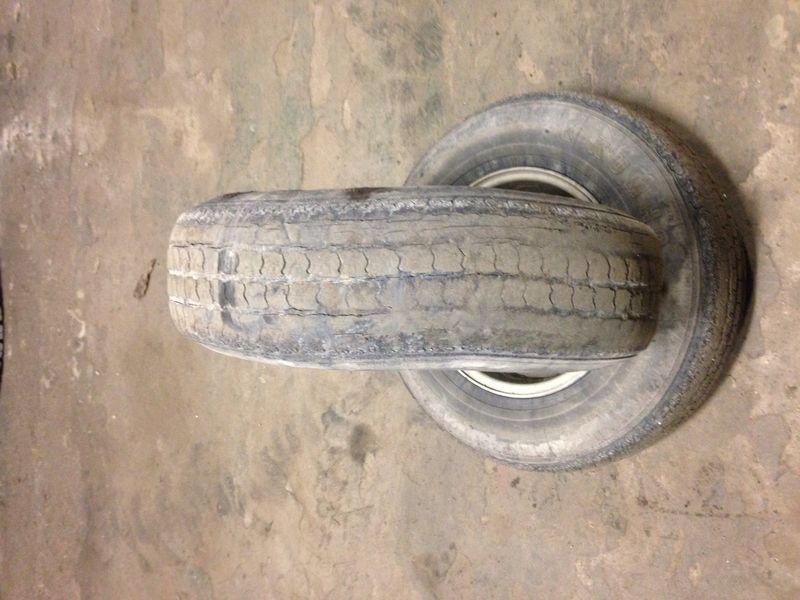

the spare tire and rear bumper are toast. my spare was actually full of water when I yarded it out and chucked it, and the bumper was beyond rusted out.

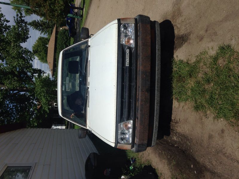

went at the front end today and got my headlights swapped in. looks decent compared to what I started with, one light was half full of water... lol
one thing I did not see mentioned in any of the other swap posts was I needed to take the grinder out and cut a couple notches out of the core support for the ranger light signal plugs to fit. I never got a pic yet but I basically cut out around the old plastic screw threaders.

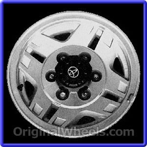

prices tires for my yota rims. BFG radial ta's are too rich for me, I just out some new 205/75r14 on the factory rims. they will last a while.

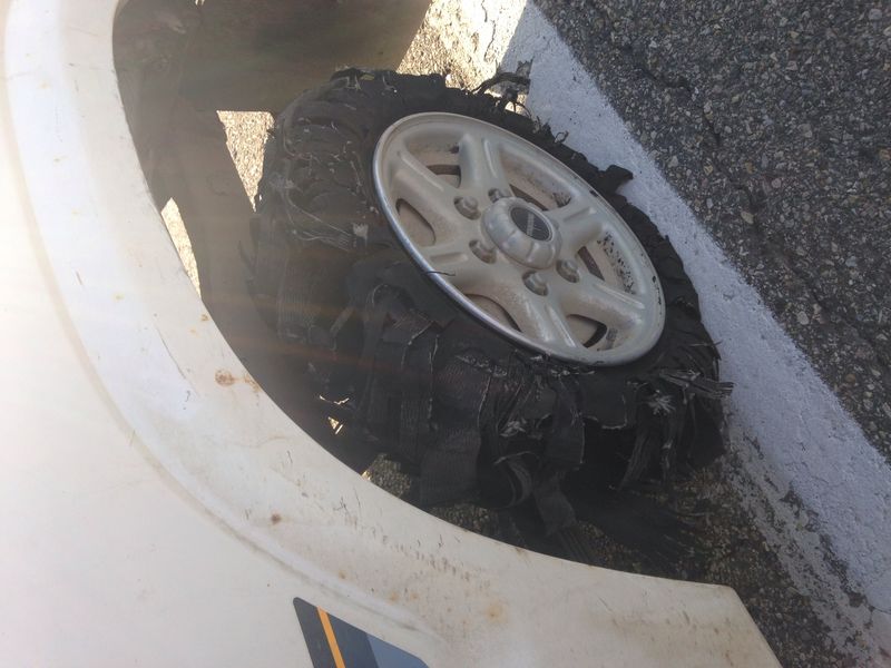

here's what happened to my tires lol
