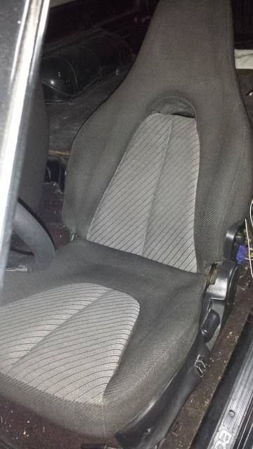

These dodge neon buckets bolt up on the 2 outer holes and have to drill 1 hole per seat for rear inside bolting.
graphx327
Ford probe gt power lumbar seats. just needed to shim them level in rear bolts
