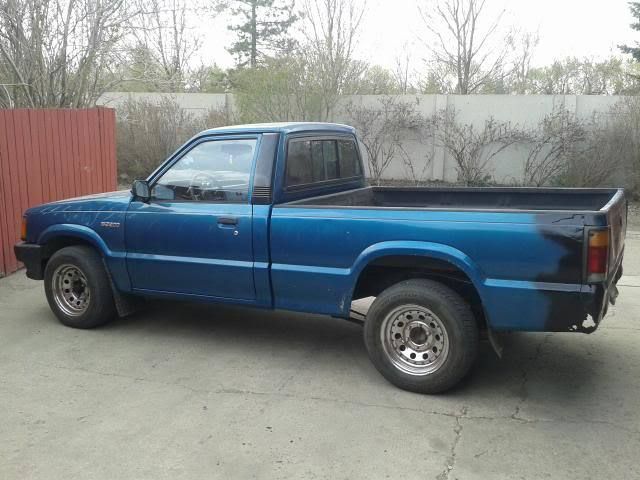

Finally got my truck insured and road ready today, ready to work the bugs out and drive it.
It's late and im tired, but here are my pics taken today, after I washed the 7 months of dust off:
I was hoping to get the rear corner of my box replaced, but I never got around to that lol:

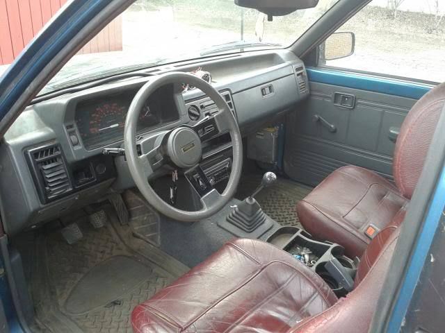

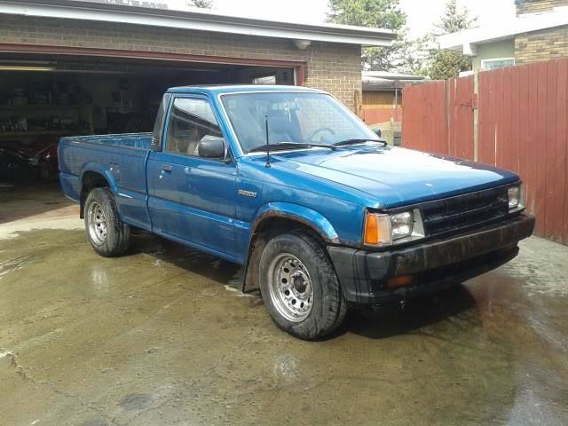

Seats are "Temporary"

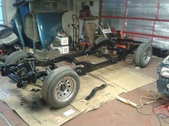

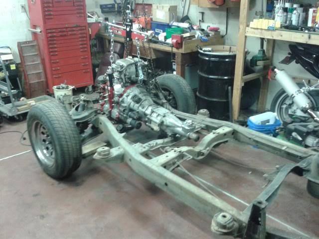

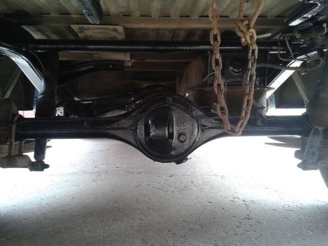

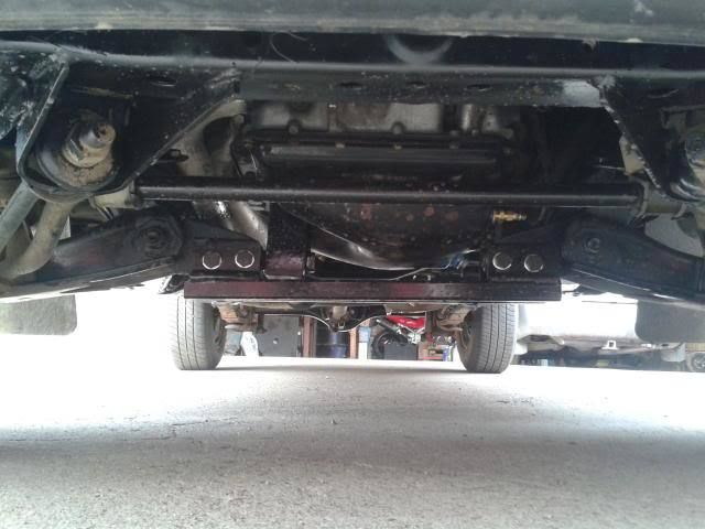

Entire frame has been coated in POR-15, took cab and box off, along with engine/transmission and fuel tank removal to paint.

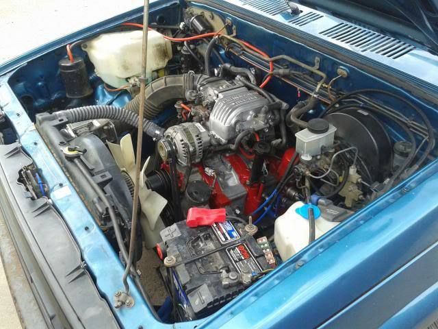

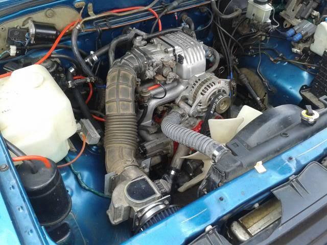

New engine, just a plane-jane non-turbo model, 1986, running stock EFI system, emissions delete, pacesetter header.
Thats all for now, I dont have a build thread, but I have some pictures. Still have to finish off the second half of the exhaust (only comes to the front of the box right now, needs the second muffler), rig up an electric fan, fix a minor coolant leak on my heater core return hose, which will require draining the cooling system, and replace the oil cooler hose gaskets as I re-used the copper washers, and they are leaking slightly.

Looks good man! Rotary mill! Did you swap that in? Or was the rotary an option up in Canada?
befarrer's avatar
befarrer
I swapped it in over winter. Did a frame up rebuild, this is when I stopped taking stuff apart:
