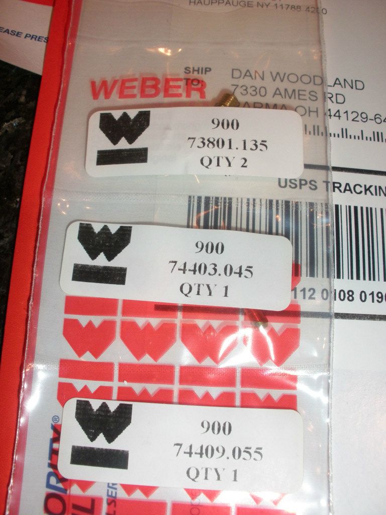

I need help with my carb,Its using alot of gas so I adjusted the idle /air. It runs great you can smell gas like its running rich maby. So if I advanced the timing,would that help its a 5-speed so do I need to use a fuel pressure regulator, I understand thats for automatic only I bought this DGEV Weber to help my gas even bought a calibration jett kit but the kit jets number's are higher than whats in the carb so do you have any idea what I need to do. thanks

When you verify everything else is ok you could try these.
