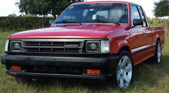

Trying to get the right fit on my 1987 Mazda B2000 with some 18" Titans Rims? 6 lugs no problem, they fit but I have spacers on and I know something needs to be cut inside of the rim but I don't know what? It's killing me lol Does anyone know what I need to cut so I can make this project go smoother? & the rim can fit flat on and I can finally get all 4 wheels balanced and get a better ride on the highway?
The rim sticks out and I know it fits flush inside the wheel fender. I have seen them on other B2000's but always on the opposite side of the road lmao, what luck? Passing me lol

you grind the tabs off. there is 4 tabs on each corner inside the wheel studs. takes about an hour to do all 4.

How is this.....18x9s.
