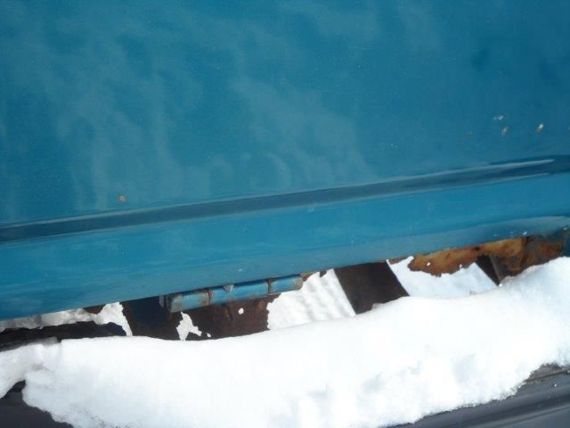

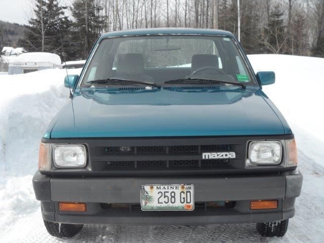

1992 b2200 mileage 83,365 bought for 1200 from original owner. I have original owners manual and original keys. Found in fort kent maine very minimal rust mainly on rear bed wheel wells but only surface rust. It is an x cab 5 speed with everything bone stock hehe fun for meeeeee.
